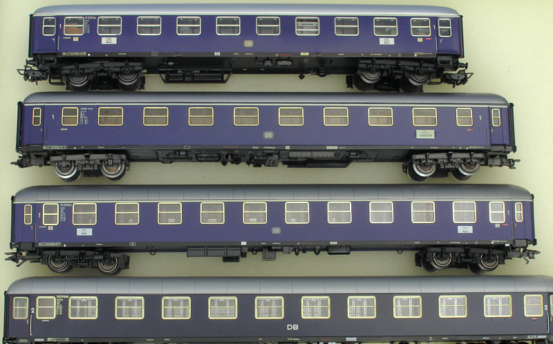

#16 Posted : 22 August 2016 08:23:22(UTC)
Posts: 15,460
You will find that tinplate coaches have less windows than the longer plastic coaches.
There you have the compromise in length.
The 27 cm Aüm/Büm have the same number of compartments as the older 24 cm coaches, the correct number of compartments came with the 282 mm coaches.
Look at the ratio between windows and the walls between the windows and you find that every compromised coach has it's own compromise.
This works best for the 24 cm coaches (20 % length are missing, about 20 % of the compartments are missing). On the 27 cm coaches some walls are much wider than they should be.
A picture from the thread linked in post #2.
IMHO the windows look too wide on the 27 cm coach and too narrow on the 282 mm coach (24 cm on top, 303 mm at the bottom).
The 24 cm coach has toilet windows that are too wide.
The coaches have different types of doors, so ignore the different widths of door windows.

Hi Mike:
I think that the first assumption that people make is that a model is fully rendered in a given scale.
Some models, eg Roco's Exact Scale or LSM, ACME, etc have all aspects rendered in 1/87.
Other models have compromised scale, which means that although the model is rendered for use on HO, it has some variances. Most frequently, this is seen in terms of scale length. The width and height are still rendered in 1/87 so that the coach/car is not too narrow or too short.
Maerklin decided to produce it's newest long coaches in the scale of 1/93.5. However, due to the fact that this is the longest length that can safely use their R1 curves with catenary, turnout lanters and signals, they also render longer coaches (e.g. restaurant cars) to the same length as the others, so some have taken to describing the Maerklin scale length as 282mm. In order to facilitate the operation on tighter radii, Maerklin has also compromised the bogie reproduction, rendering the bogies with an off centre pivot, which reduces the overhang of the coaches.
Maerklin's decision to model prototypes less than 25m in exact scale and those over that length in reduced scale length can make for complicated modelling. For example, the DB or FS (UIC-X) coaches are 1/93.5, but the SBB lightsteel coaches are 1/87. I now have the new 43874 SBB diner which is also 1/93.5, so that helps, but there are no other SBB coaches in that scale for Era III/Early Era IV.
I use a second such diner car with my SBB and FS Eurofima consist, which is all 1:93.5.
The exact scale length Lightsteel cars can be combined with Lima, Roco and other SBB passenger coaches (EWI/EWII) which is cool. Unfortunately the Maerklin models of those coaches have some rendering errors which some Swiss train fans find irritating.
I have the 1980s Roco models of the SBB EWIV in 1/93. They have a length of 284mm. I tried to combine them with the new Maerklin coaches, but the Roco coaches are a little wider than the Maerklin ones. I am not sure who has the correct scale width.
What irks me is that in addition to reducing the scale length as a compromise, Maerklin (and other companies) also have to reduce the scale of other details, like windows and doors, in order to fit the correct number of compartments into the reduced length. In more than a few instances, the company's designers rendered the whole window (width and height) instead of just the width, resulting in a less than pleasing appearance, where the windows are either sitting too high or too low depending on the model. Some paint jobs, e.g. TEE red and beige or DB blue and beige make the placement of the windows stick out like a sore thumb.
Too low (42991 Bar coach): http://assets.catawiki.n...e5-8025-552e5e7655a6.jpg
or: http://www.lokshow.de/sp...nwagen/bilder/42991d.jpg
Too high (26557 Restaurant): https://www.marklin-user...ls/mike%20c/DSC02695.JPG

I must be bad at the spot the difference game! I looked at the pictures and simply did not see it....

I have limited space for my layout and I have chosen to buy a Noch Layout Board 2m X 1m and of course the plan requires a number of rad 1 curves.
I tried to run a set of Roco coaches and found they destroyed everything on the curves because they were 1/87th scale. However, the Marklin coaches being that bit smaller run the rad 1 curves without any issues.
The point I am trying to make is that model railways are a compromise like life, you run locos and coaches from the country and era you like in the best possible way, yes all coaches look C*** on curves whatever scale, 1/87,1/93 or 1/100.
We try our best to run our stock in a way that please us and accept its never going to be prefect.
Harry over and out
thanks 6 users liked this useful post by Harryv40
#38 Posted : 26 August 2016 07:58:08(UTC)
Posts: 15,460
Originally Posted by: Harryv40 Go to Quoted Post
The point I am trying to make is that model railways are a compromise like life, [...]
The vast majority of Roco coaches runs on R1 if the layout has sufficient clearance left and right.
If you want long scale models, build a layout with suitable clearance left and right.
Or run shorter coaches that suit the clearance of your layout.
Do not blame Roco for making scale models if your layout has extremely small radii with insufficient clearance. Scale models from Märklin will have the same problems.
Shortened models from Roco, Piko, and Fleischmann should work as well as shortened Märklin models.
A small Noch layout with short platforms might be a good candidate for Donnerbüchsen and Umbauwägen. Märklin make them in 1:87.
The builder of a layout has to make some compromises - but can make some choices. Decide for or against 316 mm coaches before you start building a layout. That's my point.

I am not blaming Roco, I have a number of Roco locos, wagon etc, the point I am trying to make is that the world is a compromise. If I had a large layout with rad 2,3,4 curves, I would buy Ho scale coaches like Roco. But I don't and until I run Roco coaches on my layout I did not realise the difference between the various suppliers.
Harry

Vehicles to scale: apply easement curves
All,
in my opinion vehicles of different scales in one model train does not look good. Hence I avoid this.
As most model engines are to scale, I only have cars that are to scale. One can have almost any car to scale. However märklin does not offer many passenger cars that are to scale.
A home layout often cannot be made without small radius curves.
The offset between the ends of cars on small radius curves will be greatly reduced when one applies easement curves.
Flex rail can be laid according a spiral or klothoid.
With industry track one can achieve an easement curve by starting a curve with a track element with a large radius followed by one with a smaller radius and so on. Example: straight – R6 – R5 – R4 … R4 – R5 – R6 –straight.
For better looks of your model train also avoid laying S curves. Always have a straight piece of track in between.
Regards, Willem
