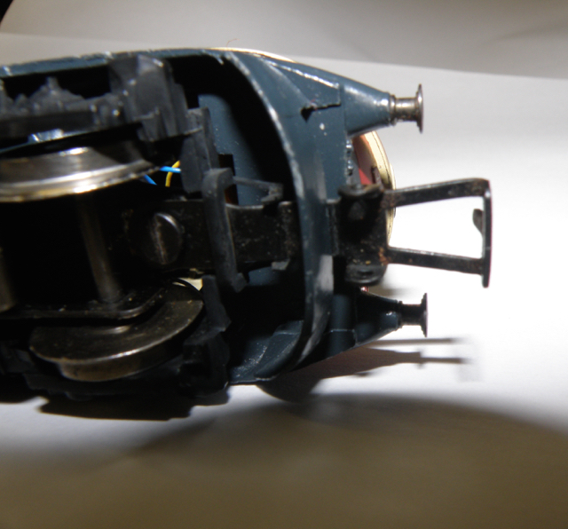

Hi everyone,
I have this old loco that has been upgraded to digital and it has the old couplers and I need help and advice on how to convert them to the new couplers.
Can anyone help?
Greg

You can use Märklin 404020 coupler pockets. I had to cut off the springs from the 404020 to make it fit (the loco truck frame already had springs to keep the coupler straight - like your truck frame).
You can use Märklin close couplers or Roco Universal couplers (or others) with these NEM pockets.

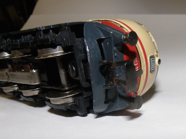

Oh goody, I have a number of Primex locos that I want to do the same to because they have the same couplings without loops. Does the same coupler pocket fit these?
Do you have a photo of a coupling conversion Tom?

There are many different locos types with many different coupler pockets.
See also:
https://www.marklin-user...-pockets.aspx#post385032
A German site (Google translate may help):
http://www.schnug-modell...ET/maerklin-ET02-KK.html
Link to Google translation:
https://translate.google...2-KK.html&edit-text=

Thanks for the links Tom, that will make looking for the correct part easier.
alan
