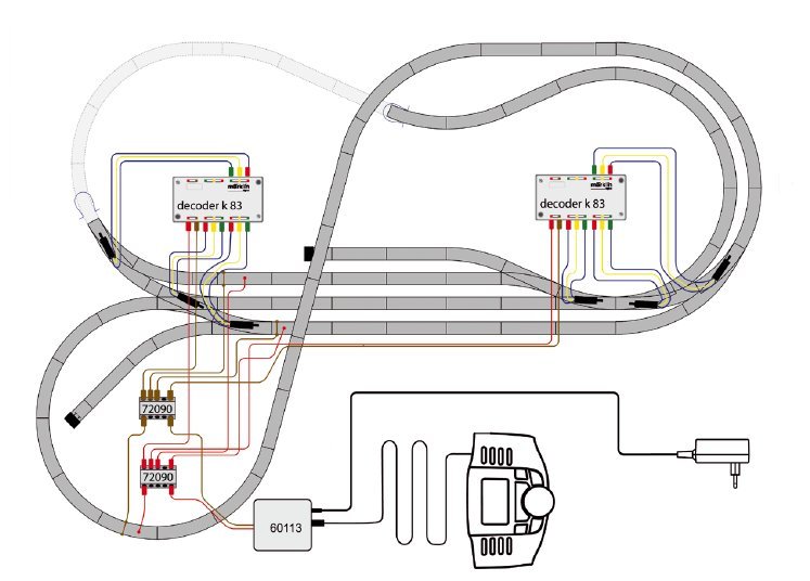

#7 Posted : 28 June 2014 01:03:31(UTC)
FrankF
Joined: 18/11/2007(UTC)
Posts: 115
Here is an example for wiring the MS2 to the Layoyt :
MS2-Layout-Wiring
and here is the way to connect the Marklin 24997 Unit to the Marklin 60830 (k83 Decoder)
Marklin24997-Connection-k83-Decoder
Each of the 4 outputs connector on the Marklin 60830 (k83) unit can control 2 Marklin 24997 Uncoupling units
which give a total of 8 Marklin 24997 for each k83 Decoder.
Hope the pictures will show you how to connect your Uncouplers to use them with MS 2.
