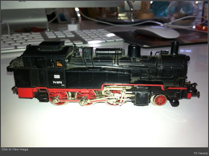

I believe your locomotive should look like this one:
-Brandon

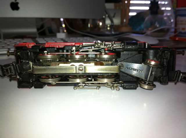

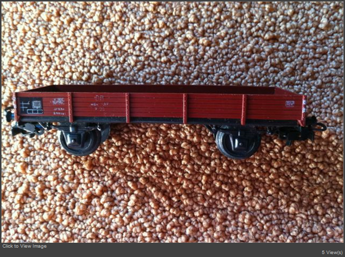

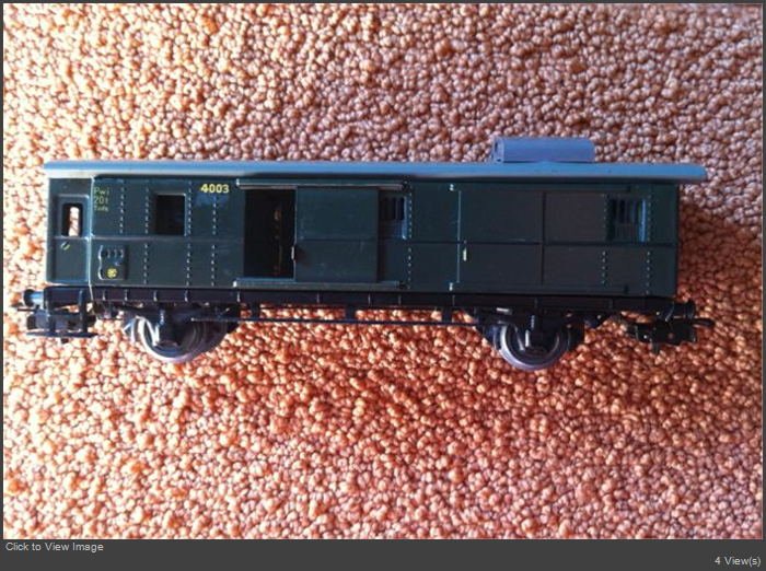

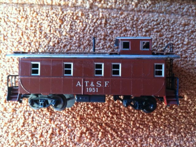

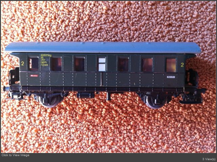

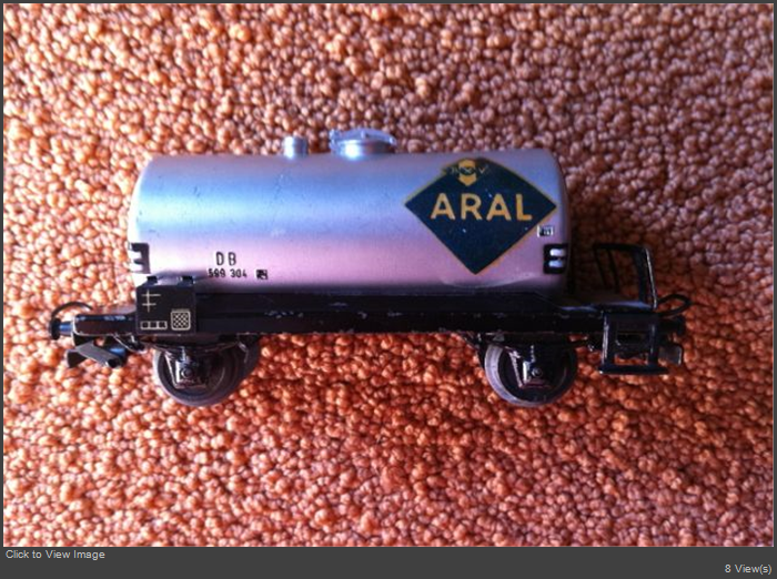

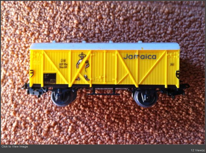

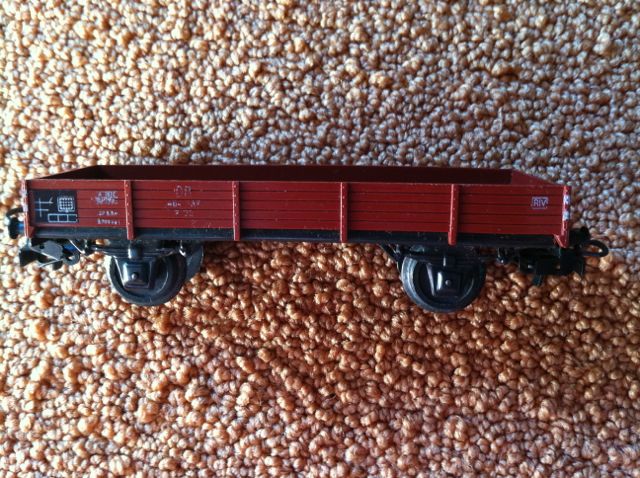

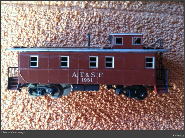

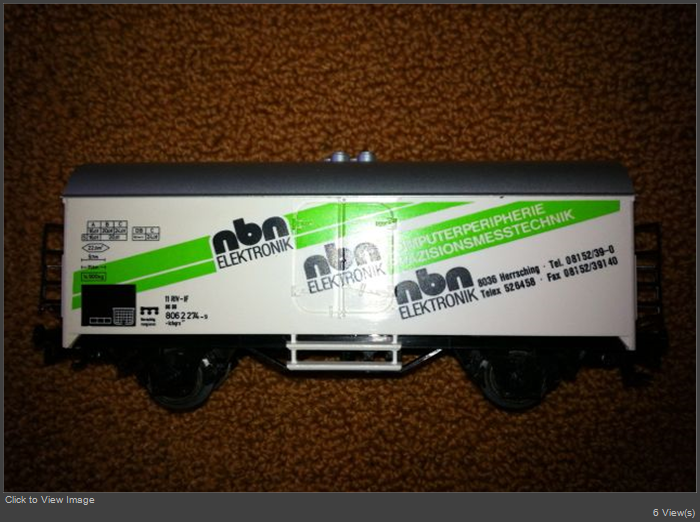

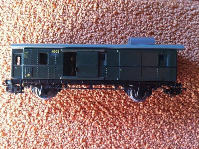

Thank you for the welcome and the detailed suggestions. Let everything cool down. Inspected power cord: looks good. Checked voltage across outgoing terminals between transformer and track: measured varying voltage. Checked wires from transformer to track: good shape, solid soldered connections. Tried train again and it works flawlessly. Is there a limit to the number of cars we should pull with this locomotive? None of the rolling stock has lights. Perhaps this caused the transformer to overheat and shutdown?
Our track is brown and has a tan colored and textured bed. I think it is M track. That does appear to be our locomotive in your picture, Brandon. I think that we will shop for a replacement transformer to have as a backup, thanks for the suggestions, Brandon. Here are some pictures of what we have to start with…thanks again. We will spend some more time on the forum to track down further information on the trains that we have been given.
Cheers, Mauricio

Here are the pics…

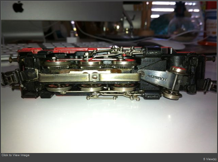

Locomotive fotos. Clearly a rookie forum member here.
cyclemomo attached the following image(s):

Mauricio,
Glad it's all working again. These old 3095 are workhorses, I don't think there should be a real limit of cars they can carry (at least 8 should be fine). These old models had very strong motors. Maybe something else caused a short. Sometimes the metal couplers on the older cars can be bent, if it contacts the pukos in the center of the track it can cause a short. Maybe worth looking into.

I do feel like we were running the loco pretty fast, trying to get a seven year old to slow down can be challenging. I think that it may have cut off because it over heated. I also followed Brandon's suggestion and inspected all of the rolling stock couplers, one of the cars had a bent coupler that was contacting the pukos and would spark as it rolled over a particular section of track. Also, headed to hobby shop today to get some proper oil for the loco. Thanks again, everyone.
