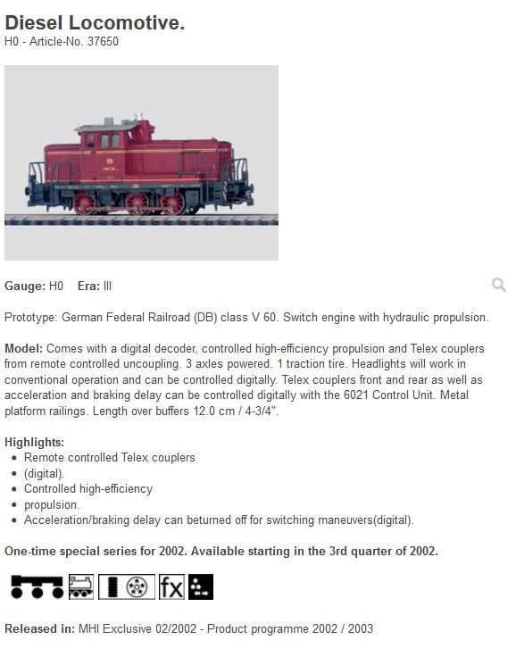

37655 - one traction tire - 2007-2012

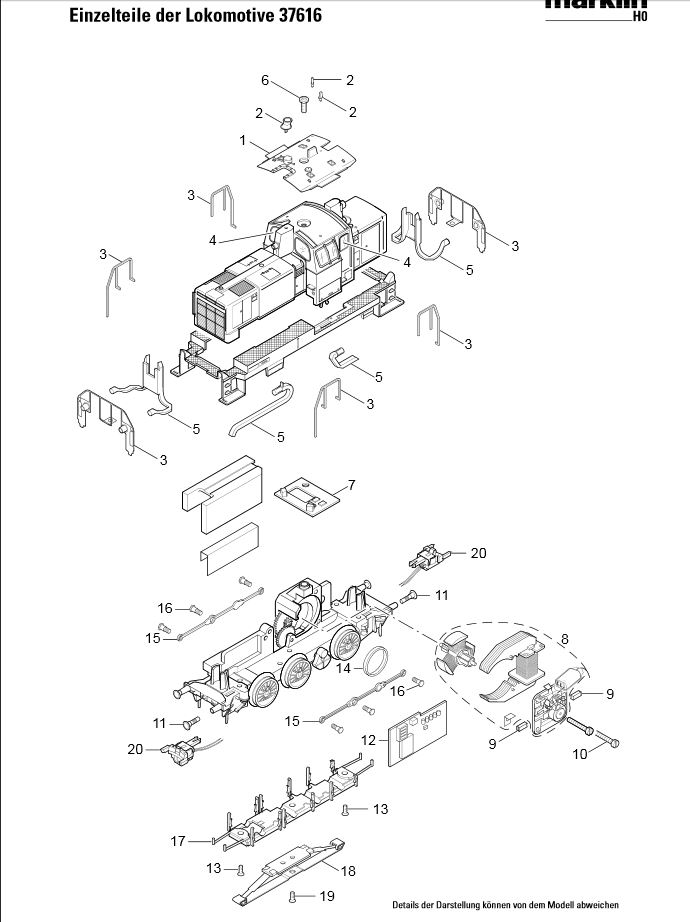

37616 - two traction tires - 2012 MHI
I have attached the parts diagrams for both locomotives for comparison. To me, it looks like they use the same chassis (both using a DCM motor as well). I actually have a 37615 on order, I can take some pictures when it arrives if that helps. 37615 has the old style telex and two traction tires, and I think was another 2012 MHI. To me the construction of this loco also seems similar (if not identical) to 37655 and 37616. All three models are marked in the product database as mostly metal, but I am not sure if the shell is metal on any of them, or if it's really just that the chassis is so heavy.
-Brandon
#12 Posted : 24 October 2013 15:49:27(UTC)
Posts: 15,467
When it comes to changes, the explosion diagrams are a bad source of information. Both drawings show the three-pole AC/DC motor while both locos have the five-pole DC motor. I don't see a speaker on the second drawing (and the decoder on the drawing is a Delta decoder with four DIP switches).
I cannot tell the number of traction tyres, neither from the diagrams nor from the product database.
37652 was the first Märklin V 60 with metal body (and it came with two traction tyres).
Thanks Tom, seems like some recycling going on.

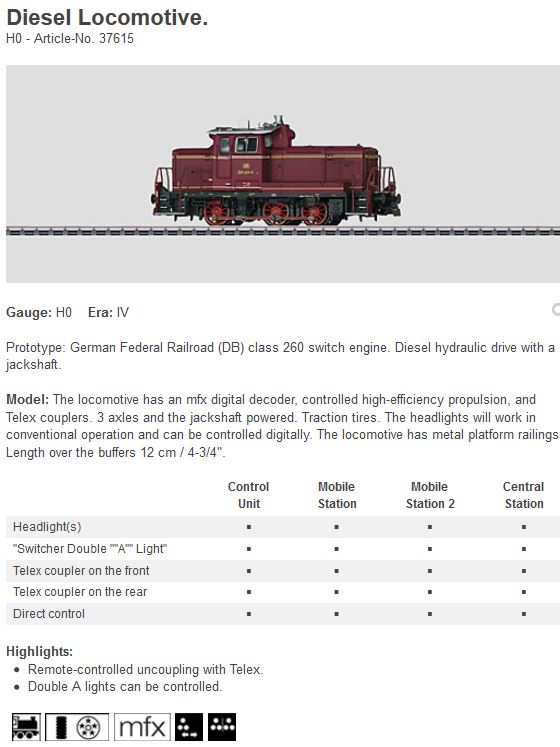

Regarding the traction tires, 37655 in the product database says "traction tire" and 37615 says "traction tires". It may be accurate, or just a translation issue. I had seen this discussion before, but not sure if it's based on product DB or experience:
https://www.marklin-users.net/fo...67457_Telex-choices.aspx

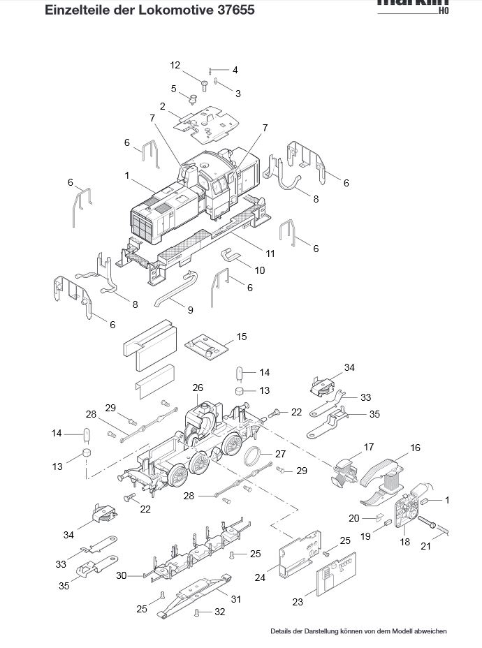

Very interesting and extremely confusing. Explosion diagrams that can't be trusted. Product descriptions that are ambiguous or non-specific. Just what are Marklin playing at? A game of 'confuse the customer' methinks!
Anyway, some observations from the Marklin website:
1. The Marklin Product data base for 37655 states: "Traction tires" (plural). Parts list doesn't state how many.
2. The exploded diagram for the 37655's mfx components lists:
23 117586 Decoder MFX Progr.o. Sound 112084 (currently not available)
23 611868 LEITERPLATTE MTC DELTA (not available)
24 E405040 Halteplatte (Delta) 5 Stück (in stock)
3. The exploded diagram for the 37616's mfx component lists:
12 118619 Decoder M4v4 m. Sound o. ex P171344/37616 (currently not available)
4. The 37655's front and rear couplers consist of:
33 E205371 Anker (TELEX) (in stock)
34 E213870 Magnet (in stock)
35 E298470 KUPPLUNGSHAKEN (in stock)
5. The 37616's front and rear couplings are:
20 E117993 Telexkupplung für V90 (in stock)
The 37616's E117993 coupler appears to me to protrude further, is bulkier and doesn't look as good as the 37655's couplers.
I wonder how Marklin decides which type of coupler is to be installed on a loco. In addition to the above two Telex types, I also found a 210133 Telex installed on a 37953 BR03. Then there is the 701630 close coupler.
On looking through publications "Summer New Items 2013" and "Fall New Items for 2012", there is only one loco (37616) listed with Telex couplings. Have Telex couplings fallen out of favour? It would seem that the 701630 close coupler is most commonly fitted.
Neil
Edited by user 26 October 2013 03:38:08(UTC)  | Reason: Not specified

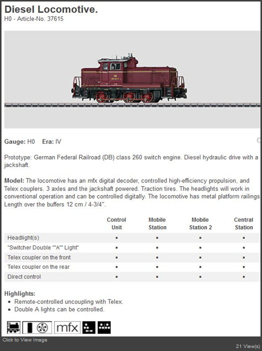

#16 Posted : 25 October 2013 02:15:07(UTC)
Posts: 9,612
Would photos of my new 37615 help here? It has the new style telex, mFX and sound..

Blushing Blushing It is actually a 37617..
The road number is V60 608. The other information is correct.
I am about to post the pictures to my album. I have done a comparison between the 37617 and a 37654. The body shells seem to be identical, but there are small differences in the chassis between the two models. The 37654 was produced in 2004, while the 37617 has just been released in 2013. Smile
Update: Here is the link to the album. https://www.marklin-user...lbum&u=350&a=386 I am off to lunch, but I will update the captions shortly.

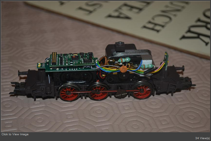

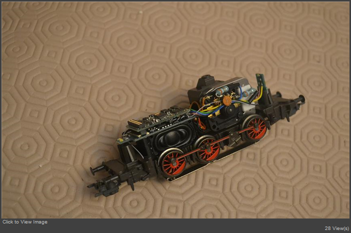

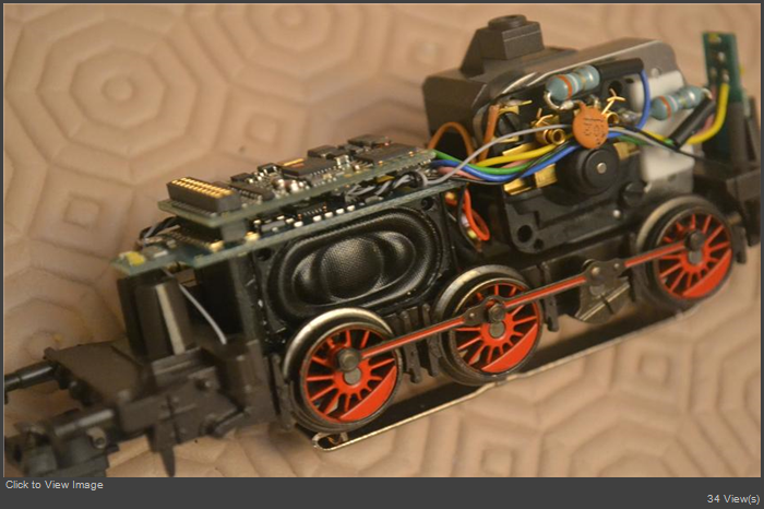

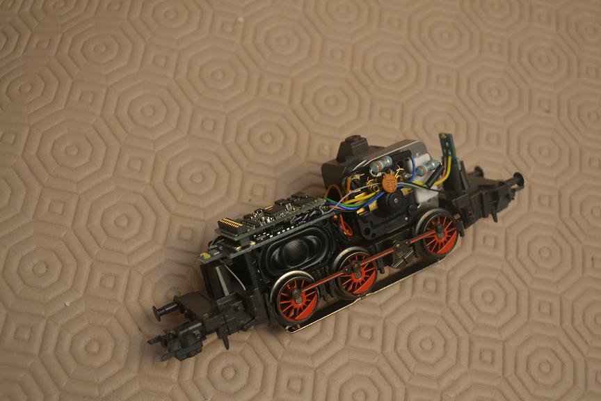

#19 Posted : 25 October 2013 04:13:22(UTC)

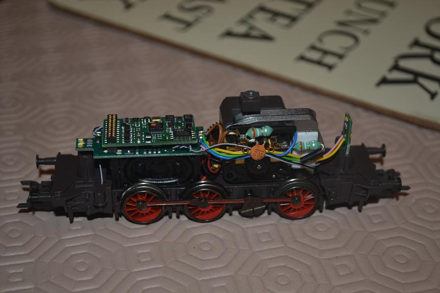

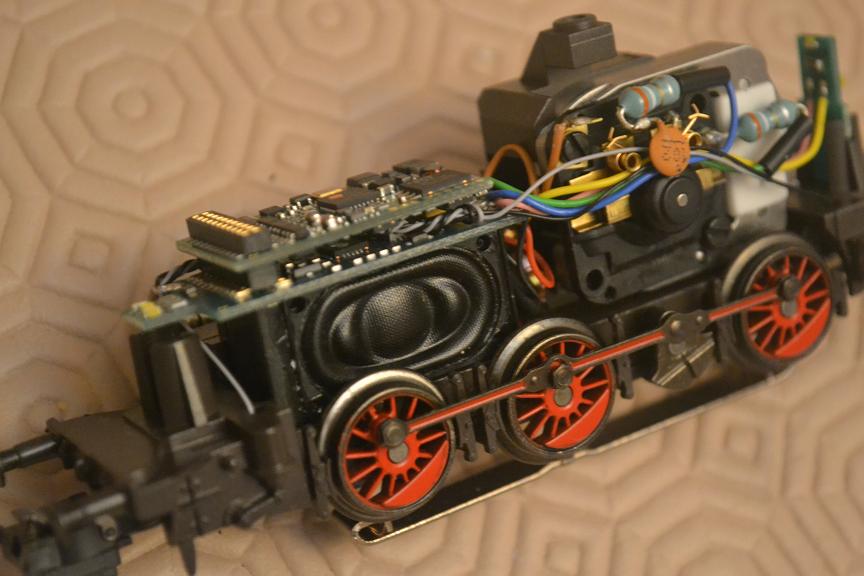

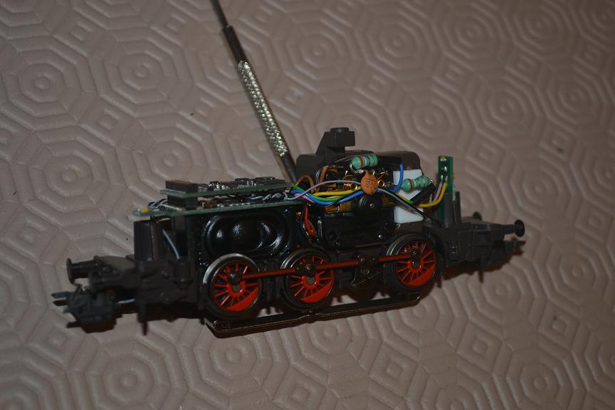

Posts: 14,879
try this one,

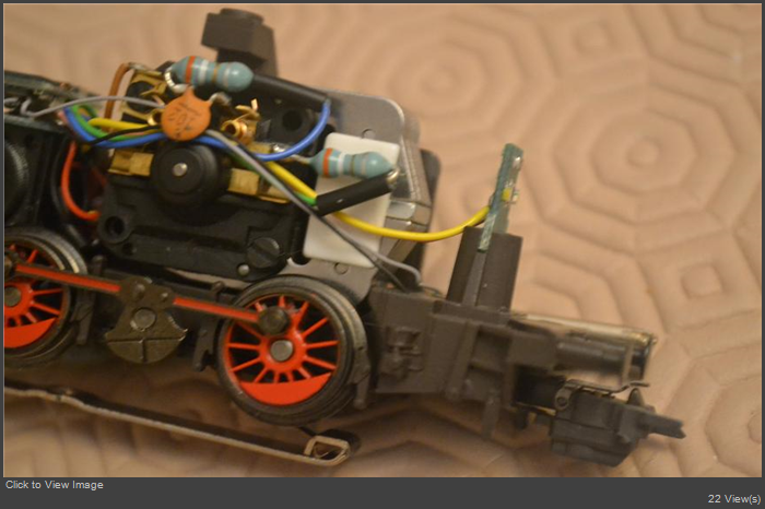

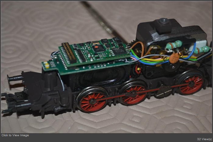

2 of my converted locos (3065) with a 5 pole motor and 1 has an ESU sound decoder + speaker
ballbearings on commuter shaft and led's (white-red)

It seems to be after looking at what Tom said that they just recycle bits for their diagrams (sort of a photoshop copy and paste), the same rotors, decoders, chassis, etc. I think these diagrams are more for parts cataloging that service teardowns in that light. There are some really good ones in the old 0733 service manual, but not for every loco.
I am hoping in the end that someone who has 37655 can confirm the number of traction tires.

Hi Neil, my two cents worth from Parkwood on the Gold Coast. I installed an ESU Loksound V3.0 decoder into my #37655. Pictures below are of my conversion that was done a while ago:
D.A.Banks

Thanks for the excellent pics. Why did you choose the ESU Loksound V3.0 decoder rather than the Marklin mSD 60946 or 60966? Was it just a timing/availability issue?
Cheers, Neil

Hi Neil, firstly at the time of the conversion the new Marklin decoders had only just come on the market & I preferred to stick with what I knew. Secondly I have a Lokprogrammer & it is just so much fun to sit & fine tune & tweak the loco to your satisfaction. But it was at that time when Marklin had the so called divorce with ESU when availability of the new Marklin decoders were hard to come by Downunder & available at a premuim price.
D.A.Banks

Hi Neil, the Marklin #37655 which is the one you saw in the pictures above has globes namely #610080 specific for digital. Loco came with that already installed. No led's & no cab light. Simple & easy conversion.
D.A.Banks

I have the 37655, and as I too had wondered about how easy it would be to upgrade to sounds I took the top off and found it is exactly the same as Brandon's 37615 as in above pic ! Smile
Firstly I can confirm the 37655 does have two tyres mounted on the rear axle ! and is an excellent choice for an Era III model of the V60 IMHO Smile
It has 21 pin decoder so an ESU one or a Marklin 21 MSD could be very easily retrofitted, however there seems to be little room for the speaker. But..............! Huh
Also the ESU V4 decoders have few functions amplified, so an MSD would be the better choice, as it has all functions amplified (ie with enough watts/output to operate Telex, lights etc) and Marklin do have a downloadable sound project for the V60/260.
Another plus for an MSD is the Marklin wiring colours are the same. ThumpUp
As for the speaker, space for that is likely to be a problem, so an internal pic of a37616 would be enlightening for all because as previosly mentioned, the parts digrams are no help at all ! ThumbDown
What Dave has done is fit a wired type ESU V3 decoder and done away with the 21 pin decoder board, allowing room for the speaker/s, those twin ones are quite small. Wink
That said I see in Adrian's pics of his 37617 that M have sat the oblong box speaker, one of which comes with an MSD, where the decoder board used to be and the decoder board on top of that. I may be necessary to change the decoder board as the original one looks likely to foul the cog wheel protruding from the front of the motor block and I have just checked with the leftover one from my V90 conversion and it is a bit shorter, enough to not foul the cog !
You will notice in Adrian's pic of his 37617 that the original bulb holder posts appear to be still there but the front light LED is on the front of the decoder board and the rear light LED board is mounted on the rear light post. If you wanted to buy two of the rear LED light boards from Marklin they are available @6eu each OhMyGod and I think could be used in both positions Wink
I have had a similar conversion done to my 37900 V90 using a Marklin 21 pin MSD, those small twin speakers, mounted in the allready factory fitted speaker cups, and the 117993 telex couplers and it works well, but those add on couplers can be fragile and I've had to replace three allready and I've hardly used it, altho two were damaged in the conversion process when mucking about with different decoders, so were either DOA or got spiked in the process, they do not take track voltage btw !!! Scared
Personally I would have to admitt that I will not be in any hurry to upgrade my 37655 to sounds, however when I get my layout operational I may change my mind Wink
Glen
Auckland NZ

#44 Posted : 28 October 2013 19:43:29(UTC)
Posts: 15,871
I've taken a few photos of my 37616 with the body off. Hope it's useful.
RayF attached the following image(s):

Attached to this post is the product description for 37650. The little icon that has a locomotive that is black and white means that the body of the loco is plastic.
Also attached is the description for 37615 (37616 is the same as far as icons). You see the little icon is now mostly black except for the cab of the loco.
What it means:
37650 - you take the "shell" off, the frame with the motor, decoder, etc is metal. The shell that was removed (the likeness of the loco) is all plastic.
37615 - you take the "shell" off, the frame with the motor, decoder, etc is metal. The shell that was removed is part metal, part plastic. When I refer to the cab, I mean that the engineer's cab is plastic (the part with the DB and road number). The engine cowl/cover on either end of the cab/shell is metal. This is the same concept of how many steal locomotives have a metal boiler, but the cab and/or tender are plastic.
The way Marklin details modern models, it's very rare to have one that's 100% metal. Some parts of the construction will almost always be plastic.
I hope this clarifies.
Thanks,
-Brandon

I obviously didn't take notice of the Features icons. I've now Googled the subject and located at:
http://www.maerklin.de/e...ten.html?sCountryCode=en
a listing of Marklin icons with explanations and I now understand the significance of the various icons depicting metal and (I presume) plastic combinations. I also note that the terms 'frame' and 'body' are used.
It now all makes sense and I will definitely pay close attention to these icons and their significance in the future.
Thank you for your patience,
Neil
