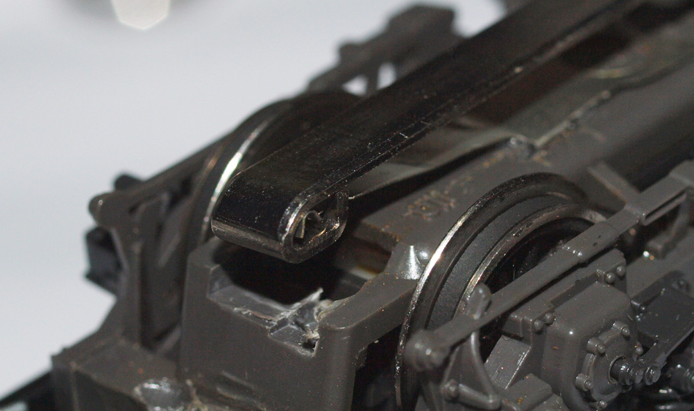

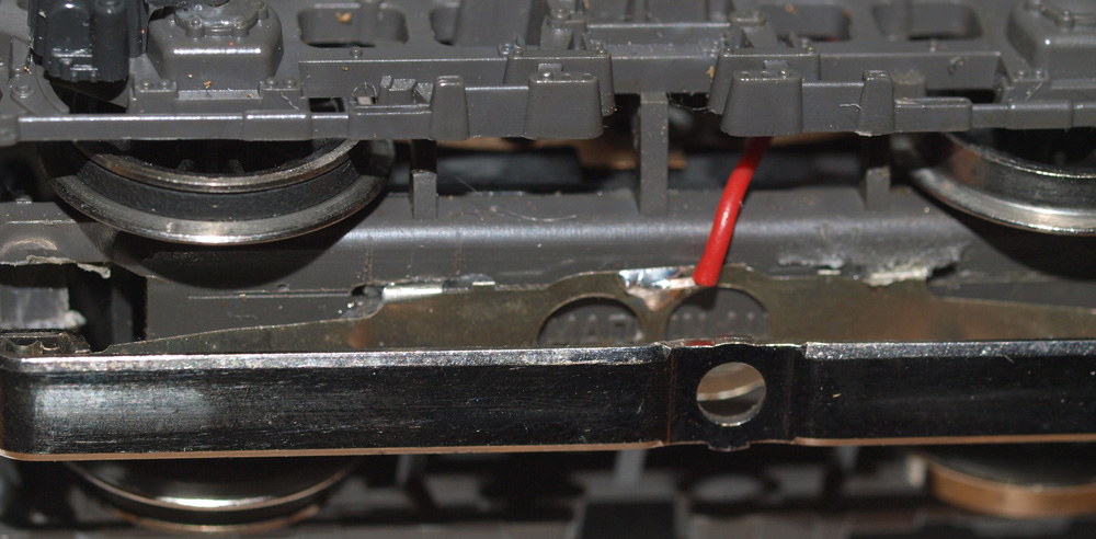

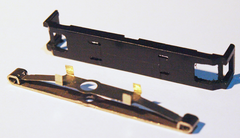

As for the pick up shoe , in 99.9% of the cases, I have succeeded to fit a Märklin ski under the loc, as long as
1) you remove the insulating plate, and mount the ski directly in to the loco plastic bogie, after cutting four small slots (see picture below)
You'd still need about 2 mm free space if you use the older style rigid Märklin pick ups, the newer "floppy" versions are so thin (and it's good news!) you only need about 1 mm clearance.
The one in the picture was fabricated "in-house", using a 0.5 mm brass strip, properly slotted and shaped to fit a Märklin spring (which is 0.3mm thick for instance) .
2)... and you should be ready to eventually make little cut-outs in the base plate cover, in order to accommodate the "curl" at the tips of the ski. (again check the picture below)
I use a milling machine for that operation..maybe an overkill, but I am AnR ...

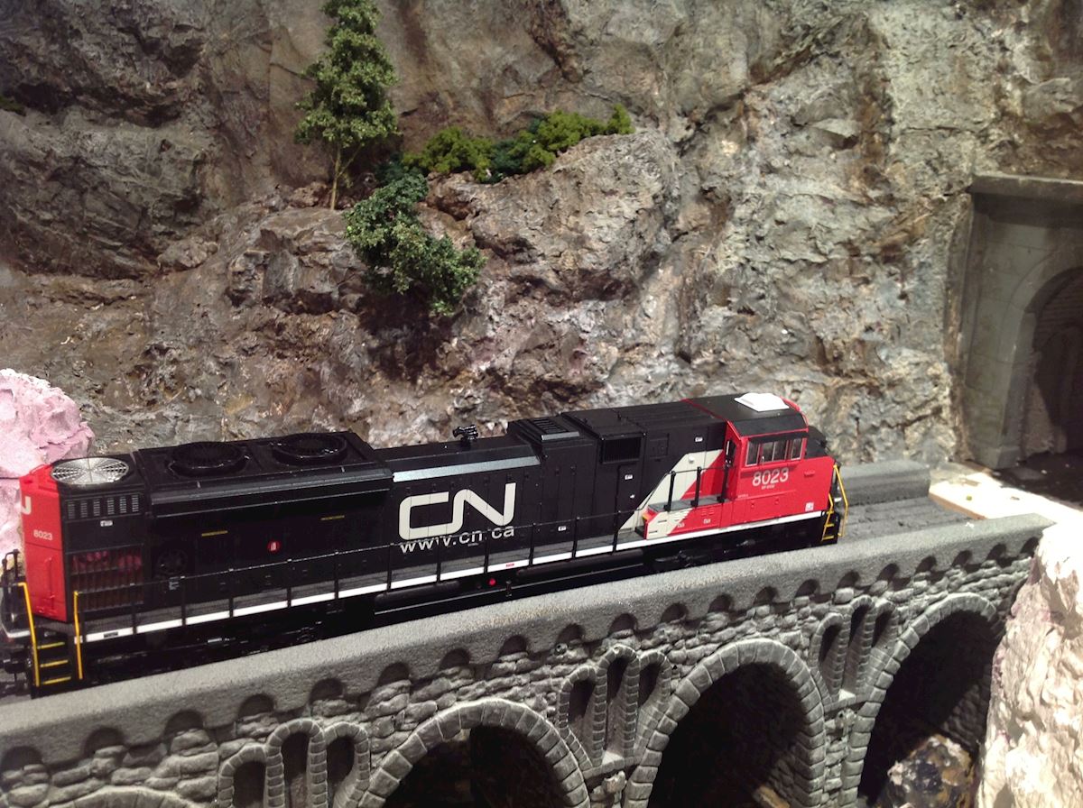

I am in Toronto. I just purchased a VIA FP9 and will try to convert it. I really liked the answer from Jacques it gives me hope. I am still note sure about the "electrical is easy" part from the other responder, I am not too experienced in soldering wires onto tiny expensive boards, we will see.
I have had great success with Marklin-ready Protosound 3E+ MTH locos. I have 3 of their locos and 2 more coming They work great, sound great and work well in DCC mode. That gives me access to NA locos but I really want Canadian CP or CN, VIA and GO (Ontario). So I bought a 3E+ SD70 M-2 in Norfolk and Western colours and a non 3E+ CN version. I exchanged the casings, a few tricky moments but essentially easy and now I have a beautiful CN SD70M-2 in CN black and red.
Unfortunately, that is the only possibility at the moment with MTH so I have purchased 2 GP-35 in sant-fe colours and I am going to redecorate them. One CN, one CP. I also have an F7 in Santa-Fe coloyrs that I may re-do as a CN. Depends how the conversion experiment goes.
I was talking to a great guy in Australia who runs "DCC info and Advice" he recommended the Lokpilot v4.0 M4 multiprotocol decoder for conversions. This decoder will talk MFX and is recognized by CS2. Another crazy attempt but it all adds to learning.
Good luck with your FP9's we will see how this works out.

Carefully separate it from its insulating plate and straighten up the little brass fingers from the spring blade
Take the bottom off the bogie and mark it exactly where the fingers should be coming to place the ski perfectly in the center and with ears clearing the bogies' bottom..
Cut 4 slots (I do it by drilling a number of adjacent 1 mm holes, then open the slot with an X-acto cutter and finish smooth with a thin file)
To accommodate the ski "ears", you may also need to cut the edge of the bogie's bottom (as in the photo below) if it is a long one.
But from the looks of it, not needed in your case!
Mount the slider by sliding the fingers in the slots, either bend the metal or simpler, super glue them to the bottom of the bogie.
Voilà!

Thanks again, no, i did not check the clearance, but even if i had i would have tried anyway. I am attaching pictures of my efforts. it would be great if you have suggestions. I got a new bogie cover so we have a fresh cover to modify if required.
Beano attached the following image(s):
#27 Posted : 07 August 2013 21:25:25(UTC)
Well from the looks of it, you may have a case where the thinner (home made, as shown on one of my pictures) slider may be required.
Also make sure the solder doesn't interfere with the slider.
But before that , try to establish if you are in the 2 mm or the 1.3 mm clearance case, using the technique I suggested.
Iy is really primordial and an integral part of the "recipe"..;can't skip that step!Wink

Ok Jacques,
My apologies for the delay, I was distracted doing my first attempt at redecorating an MTH GP35. It's not beautiful but I am quite happy with the results. Anyway, the other conversions are looking a little hopeless. I measured the two candidates and the results are discouraging. The Rapido is less than 1 mm (0.6) clearance and the Athearn is only slightly better at 0.04" or 1,02 mm. I also think that the wheel flanges are not deep enough to keep the wheels aligned through the switches. I am looking into changing the wheels to the MTH marklin style but there are clearance issues with the trucks.
Offline Beano

Well, it has been some time since i updated this post. Not sure if anyone is still interested, I now have the following successfully running on my Marklin layout...
1. ES44 Canadian Pacific. Athearn Genesis
2. GP9 Athearn Genesis.
3. FP-9 VIA Rail, Rapido.
I am Working on a GO Transit GP-40 Athearn Genesis
I have the following on order from Rapido and Will Convert when they arrive
GMD-1 CNx2, F7 VIA, LRC VIA
I also have the following MTH locos running very nicely..
1. GP35 SP
2. GP35 CN(Redecorated from SF)
3. GP35 CP (Redecorated from SF)
4. SD70 M-2 CN (CHanged bodies from NS)
Thanks to all of you who helped get this rolling esp. Jacques.
