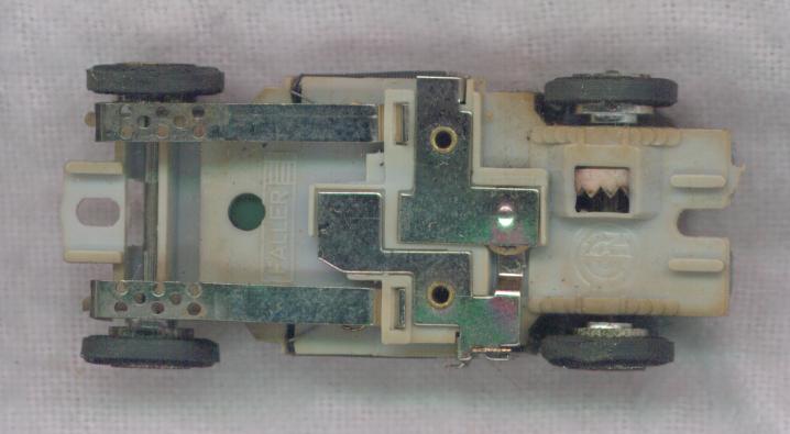

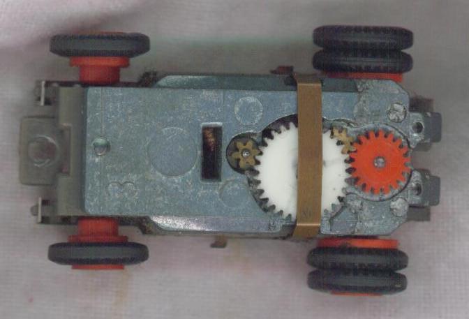

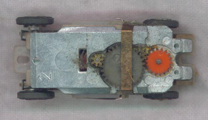

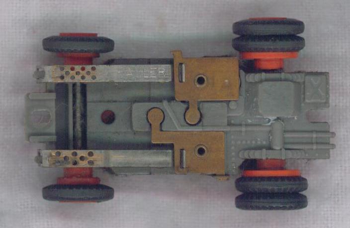

Usually the seller will specify if it has a Zinc Chassis - actually the chassis itself is Plastic, it's just the top Bearing Plate which is Zinc alloy.
If they don't specify, and are not sure, ask if they can add a photo of the motor to be sure.
Here are two examples, one with Truck chassis (LKW) wheels, the other a Passenger (PKW) with standard wheels.
Unfortunately, unless you really know what you are looking for, you can't tell from underneath either. See examples, the bearing plate is not visible from the underside, although a keen eye can usually tell by looking in from behind the rear wheels where the two solid supports can sometimes be seen overhanging the rear axle.
I am in the process of updating some AMS item info on my homepage, I will try to get on to the different chassis types soon and create a table showing those. There are around 40 unique chassis designs, some have only subtle differences, others are significant design changes. Fortunately, many parts are interchangeable but some combinations work better together than others.
