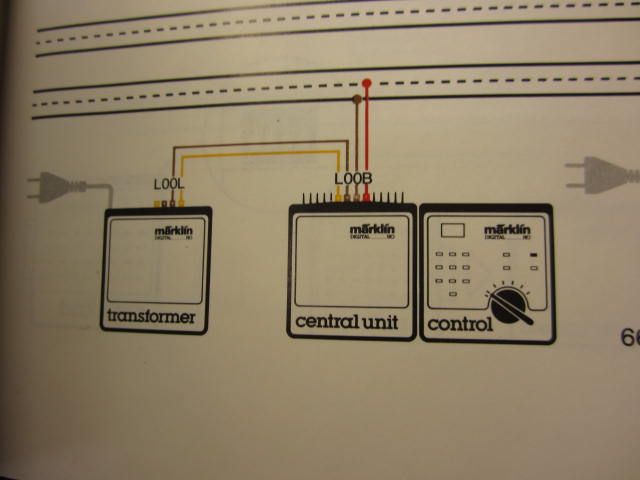

I have sold the Titan transformers I used to use with my digital equipment. Is there any problem with using the pictured blue transformer connected to the central unit? I'd like to test some locos. Thank you.

Assuming the transformer is correct for your mains voltage there should be no problem using it to power your central unit. Use the L and O outputs.

#8 Posted : 31 December 2012 20:58:03(UTC)
Mike, Topside wasn't intending to use his blue transformers to run digital locos on an analog layout, rather he wants to use the transformer to power his central control digital unit (6020). This shouldn't be a problem. I've used my 40va blue transformers which are rated for 220v (our mains is 240v) to happily run my CS1. Topside should be fine, subject to the caveats Tom mentions.

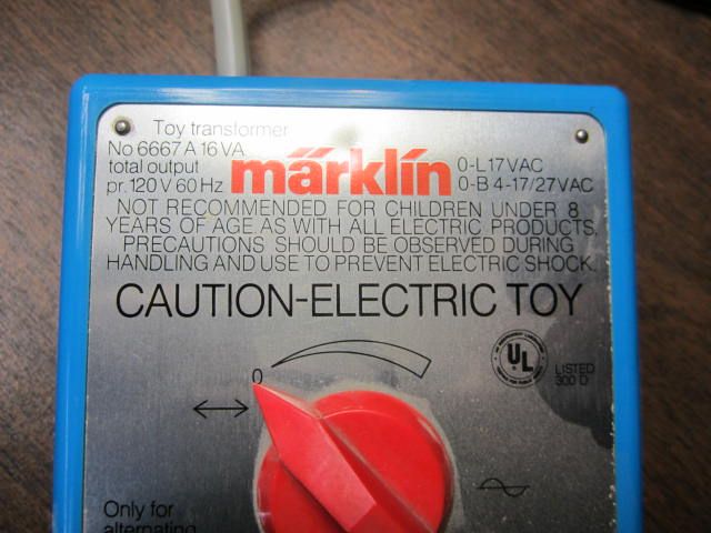

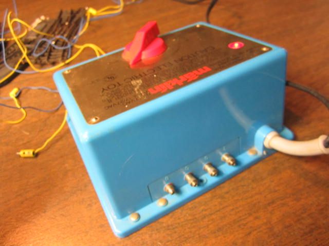

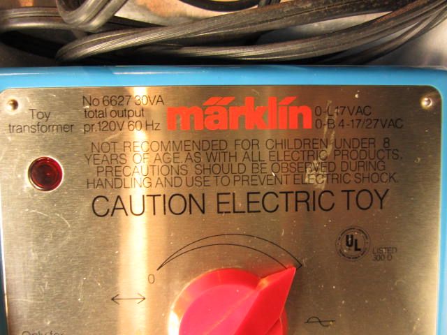

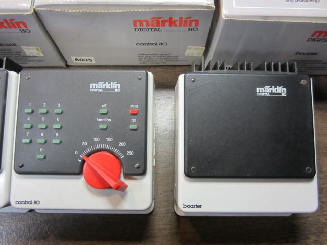

Pictured are the 2 transformers I have. What I'd like to do is just test a few locos, one at a time on a small oval. They have not been run for 15 yrs. Two of them were purchased in the 1980's as digital locos, and my other 2 or 3 were converted to digital around that time. JUST ADDED A PIC OF MY #6035 CONTROL 80.
I plan to connect one of the blue transformers to my #6035 Control 80 and test the trains. I'd make connection as pictured in the original post or as in the link from Yum's post. I don't plan to use a booster. Think that'll work? Below are the 2 transformers I have.
Could I use either one or do you suggest one over the other? THANK YOU.

Hi Reed,
If you are only wanting to test some Loco's, either one really will work just fine as the power source for your Control 80.
The only real difference between the two is that 6667 is 16VA and 6627 is 30VA. If it was me, I'd go for using the 30VA for two reasons.
1: The Control 80 will draw some of the available current anyway so the higher rating will leave more for your loco's - although if testing one at a time, it really won't matter.
2: (Important).... The 30VA has a Red Light. Red Lights are pretty, and will go well with the red light on the Control 80. These small details make the difference between an event, and an experience.
Oh, and another plus... if nothing works, look at the pretty red light. If it's off, no point worrying about the loco BigGrin BigGrin Of course, it's entirely possible after a hard night on the turps that you are already seeing red lights everywhere, and if your Christmas tree is still up, that only complicates things.
You'll have to connect the transformer to the 6020. The 6035 has to be plugged into the 6020.
I think I'd use the 6627 as it provides more power.
OT: I'm a bit irritated about the voltages I see (17 V and 27 V where it's 16 V and 24 V with transformers sold in Germany).
Those voltages shouldn't do harm if used for tests only.

Ha ha, indeed, connect to the Central Unit, forgot that minor step because I have a Central Control which you power direct from the Trafo.
