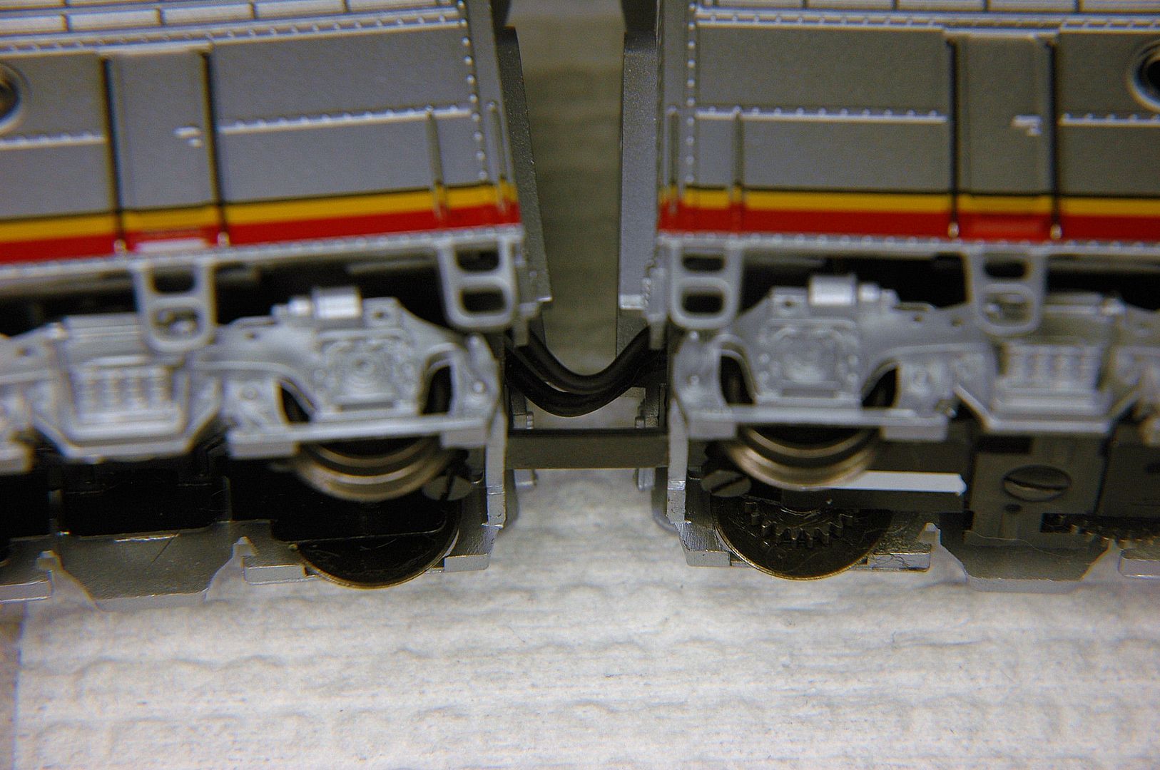

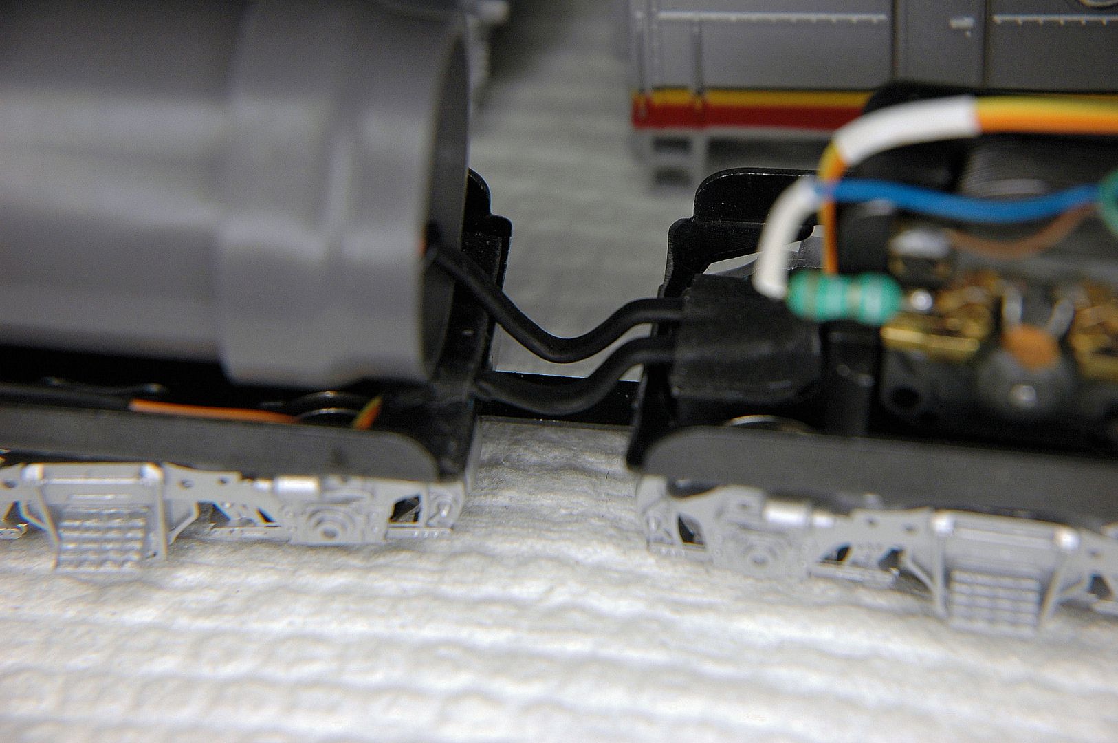

"two wires going between the loks".
Great idea and since there are 4 wires, I split them up into the speaker wires and the rear light wires.
[img]UserPostedImage[/img]
Edited by user 02 February 2013 03:15:24(UTC)  | Reason: Not specified
Looks like a perfect solution ThumpUp
