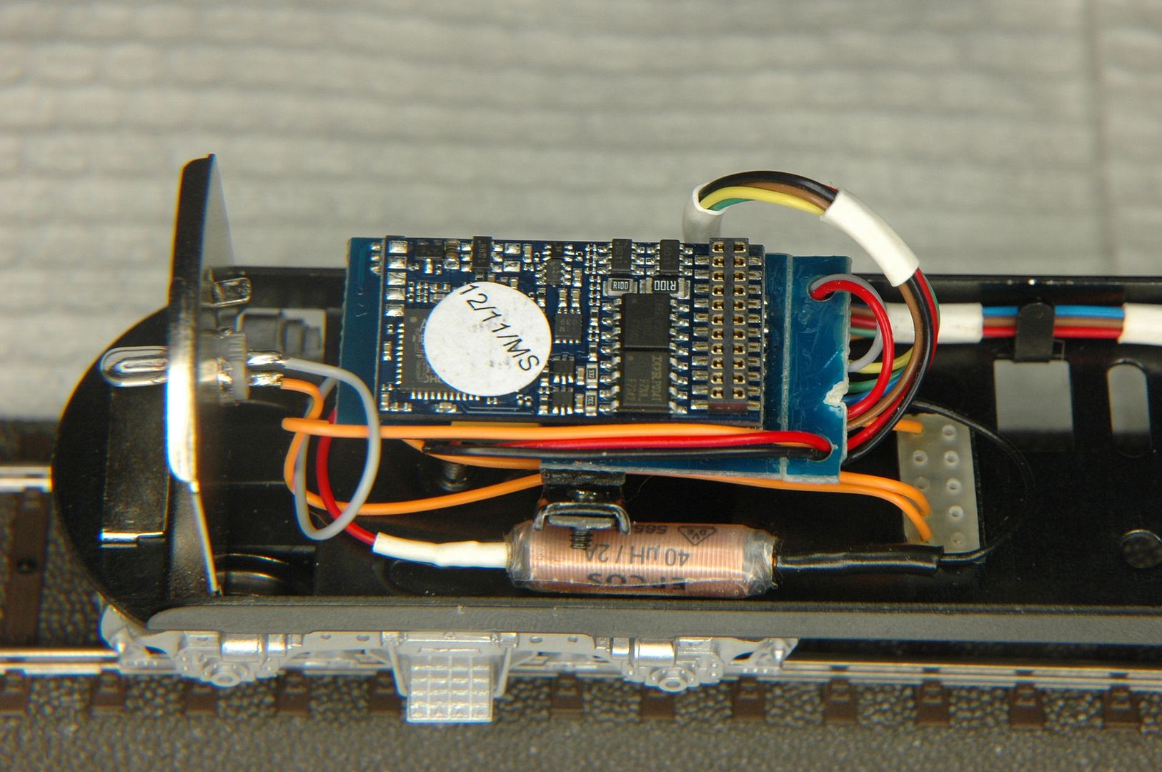

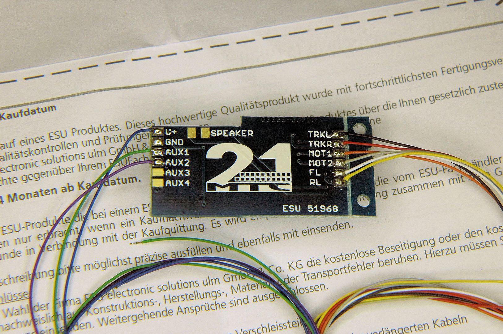

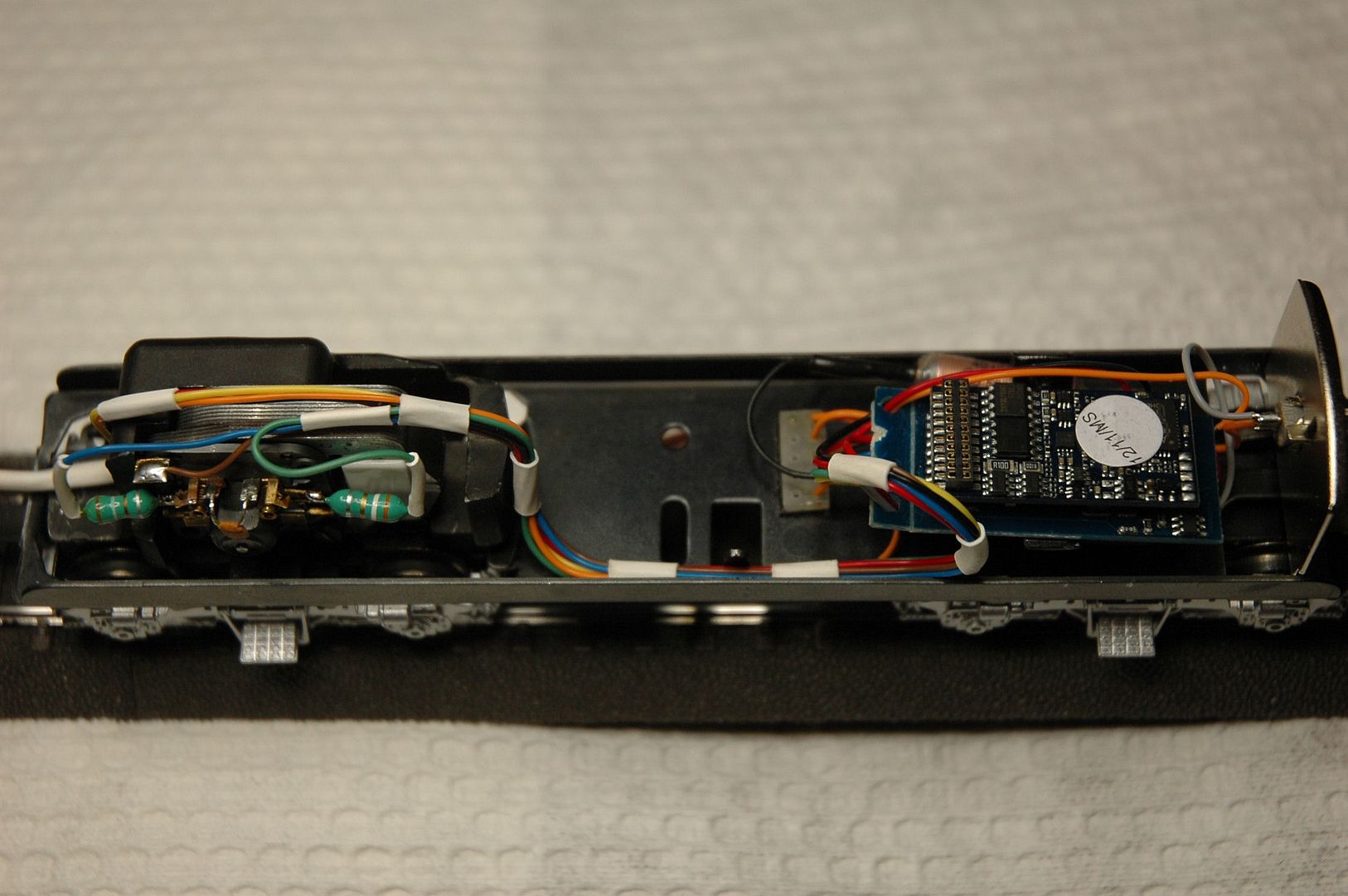

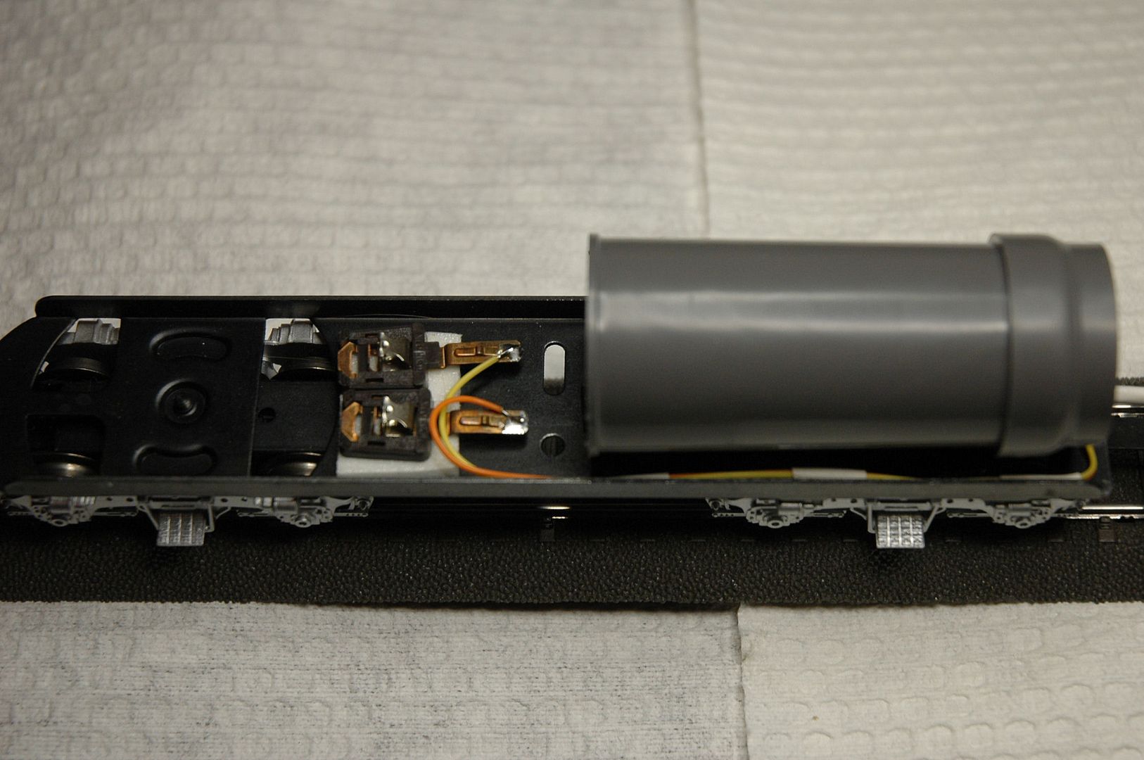

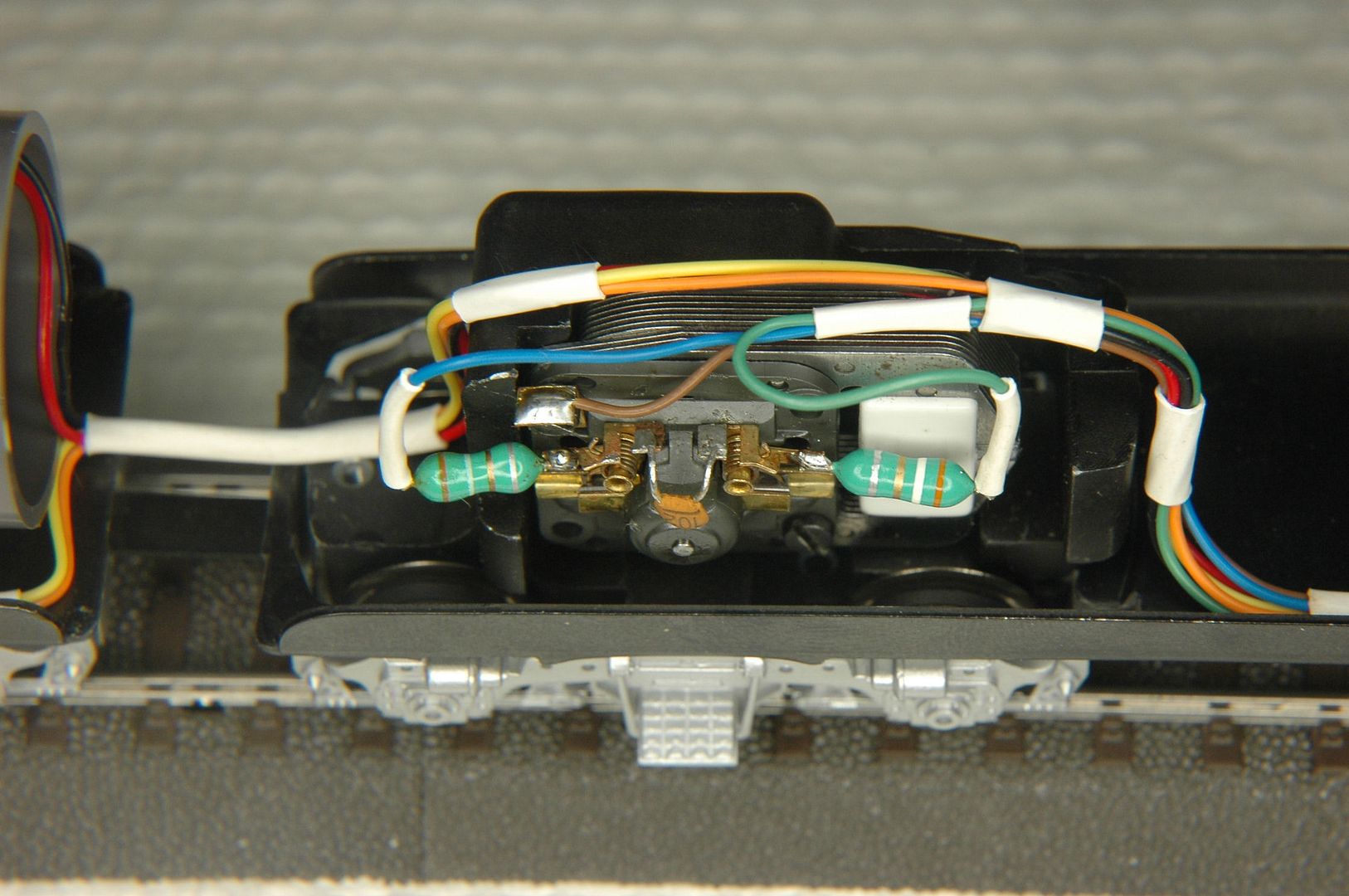

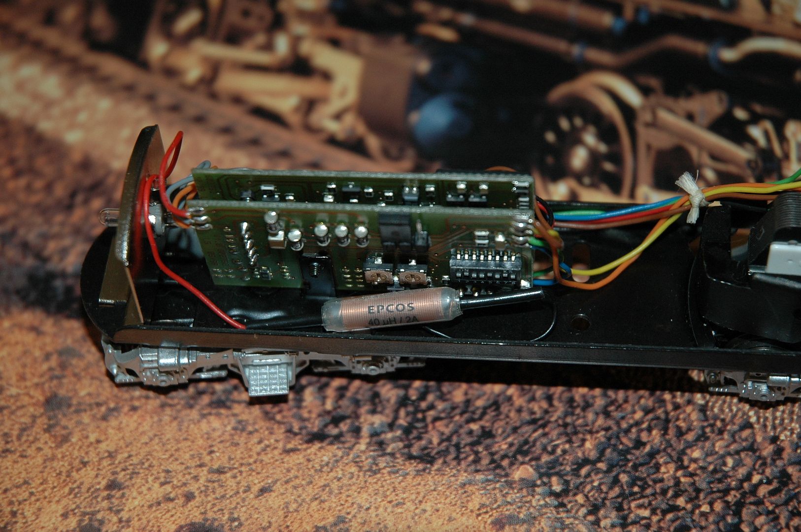

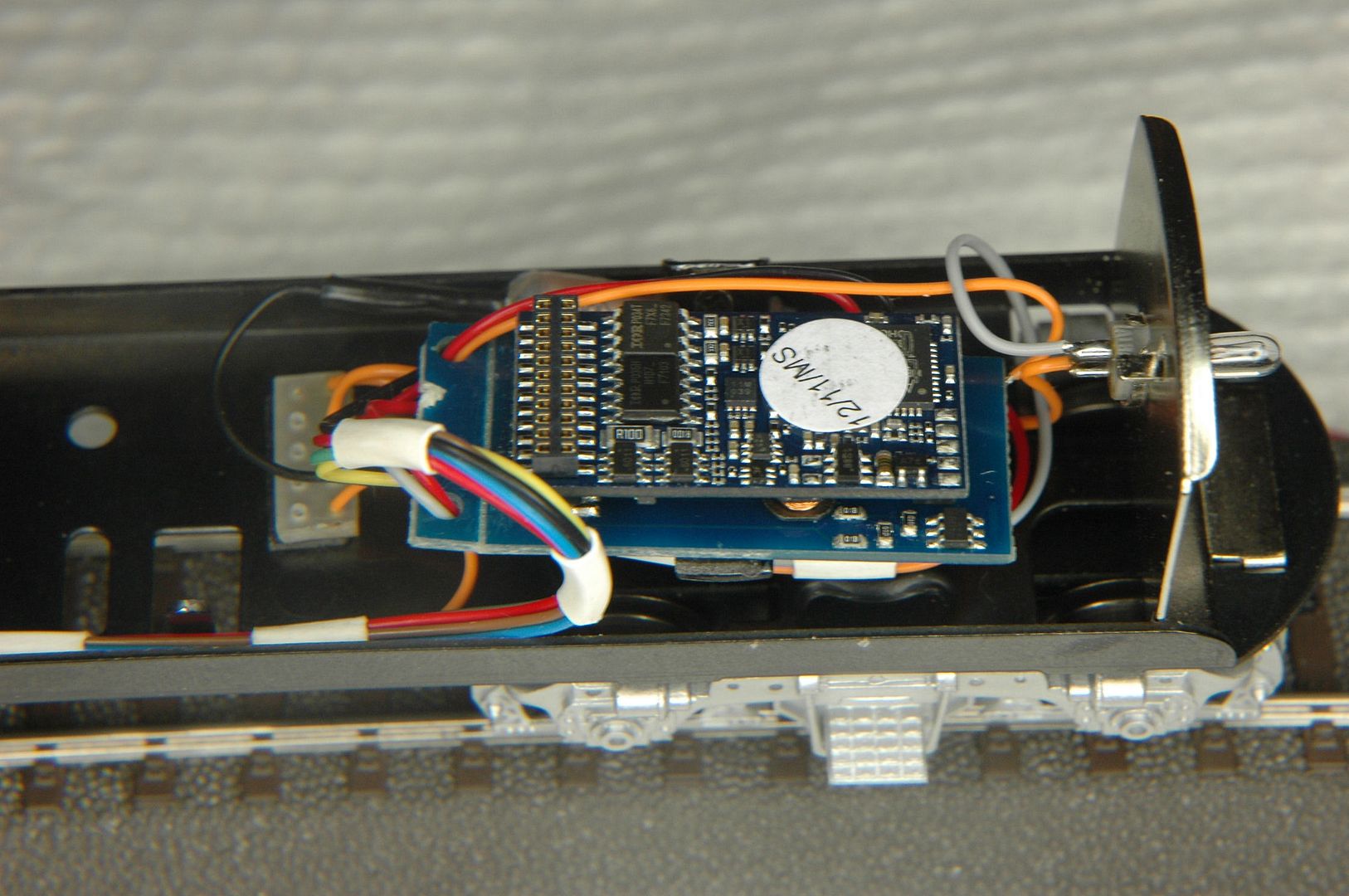

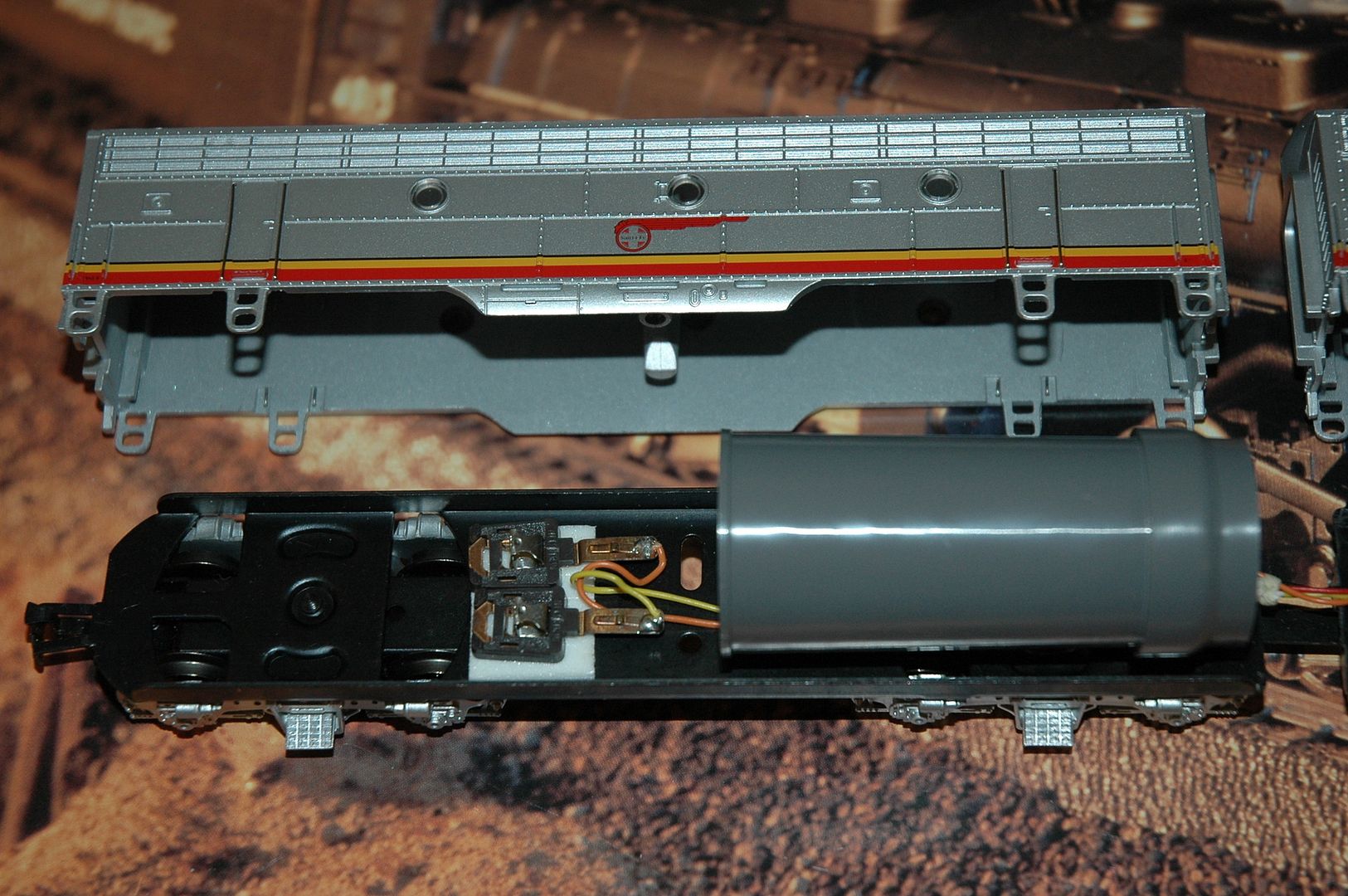

Offline abisel
#16 Posted : 11 January 2013 18:37:35(UTC)
abisel
Joined: 07/12/2012(UTC)
Posts: 139
Location: St. Charles, Missouri
To everyone, thanks for all the replies and suggestions.
I have been talking to Guy at AJKids and we both think the decoder is dead.
I have looked at all the wiring and connections, verified that track voltage it present at the inputs of the decoder, looked at the motor and it does look like it works (brushes worn and commutator has brush marks), and have changed the DIP switch address. This loco is completely dead.
So I will be getting a V4 Mfx decoder from ESU.
[img]UserPostedImage[/img]

There seem to be two decoders in the A unit. One with 8 dipswitches and the other with 4. I am guessing that one (8 switches) is for the lok and the second one (4 switches) is for the sounds in the B unit.
Have you tested both? Do the sounds work, but no lights/motor in the A unit?
Slider to decoder red
Wires to the front light grey/orange
Wires to motor brown/blue/green
Wires to B unit red/black (2nd decoder to speaker)/yellow/orange (to terminals?)
I'm not quite sure what is connected to yellow/orange via the terminals. Does anybody have any ideas of what this design is?
I guess that this duality is the reason for the elevated cost of the decoder.
If you remove the decoder and install a loksound decoder, it may not work with the existing sound module in the B unit. You will also have to adapt the motor to operate with mfx/DC using a conversion kit or replacement magnets.
I don't know whether an ESU Lokpilot could be integrated with the second decoder for the sound module.

#19 Posted : 11 January 2013 19:01:43(UTC)
abisel
Posts: 139
It is my understanding that the ESU V4 Loksound decoder (64436) would replace both the original Marklin decoder boards.
The original speaker may or may not work with the ESU decoder, but the ESU does come with a speaker.
I would have to wire the ESU decoder to existing wiring. No big deal, just a little soldering.
The two connections in the B unit I believe are for a rear light of which this loco does not have.
#20 Posted : 11 January 2013 19:13:25(UTC)
Posts: 8,244
It appears that power is provided to the second decoder directly from the first decoder's circuit board, so if the first decoder was dead, the second might not receive any power.
It may be possible to salvage the sound decoder if it still works (but is just not receiving voltage from the main decoder).
If this is beyond your ability, I would consider sending the lok to AJCKids or to Helmut's for testing/repairs.
On the spare parts sheet with diagram (list) there is "Geraeuschelektronik A-Unit 602753" which is showing as available at Maerklin.de
602753 - GERAEUSCHELEKTRON. 99,95 € Unverbindliche Preisempfehlung
This may be the second decoder for the sound module in the B-Unit.
Ask Guy to check with Walthers if he can get a better price on the replacement main decoder than the one listed. If you decide to replace it, that would allow you to maintain all current functions. If you decide to go with a full conversion (motor magnet and ESU Loksound decoder), you may also want to consider making some additional upgrades, for example, replacing the bulb with LED/LEDs (Long Distance Headlight), separate lights for the road number plates and interior cab light.
If you decide to go with the Loksound option, Ask Guy if he can put the Loksound in the A-Unit and whether he can salvage the sound decoder from the original setup for the B unit or get you the 602753 which can be installed in the B-unit to bring it back to life.
Yep, that's the thing with the four DIP switches. The sound electronics (I would not call it a decoder).
I have similar sound electronics in V 200 and V 188 locos. The sound is not state of the art.
So while it might still work, a new sound decoder will surely sound better.

The 37622 is ALIVE!
I replaced the old decoder with ESU 54499 Loksound V4 along with an adapter plate ESU 51968.
I didn't like the fine wires on the adapter plate, so I replace them with Teflon insulated pre-tined 28ga wire and matched the Marklin color scheme.
Before:
After:
Then I installed everything and made it look pretty:
Once everything was installed, I programmed the decoder with the F7 sound file. I had a couple issues with the Lokprogrammer throwing exception errors, but it worked OK.
After testing the F7 on the track, it was way too fast and way too loud so I tweaked the values a little and everything is working just fine.

I really like using the Teflon insulated wire. Same stuff used in aviation wiring. Easy to shape to layout and stays that way.
It is high temperature so that when you solder to a connection, the insulation doesn't melt away like PVC jacketed wire. And the copper is already silver tinned so soldering is much easier as well.
http://www.bulkwire.com/wire-ca...ature-stranded-wire.html
I'm sure the wire is available in Europe as well, just have to search for it on Google.
I still have to tweak the decoder a little more. I already have the speed slowed down and the volume turned down, but I need to do a little more tweaking.
Also, I purchased a new soldering iron since my old one really was too much for the job and needed to be replaced.
http://www.grainger.com/Grainge...-Solder-5JH82?Pid=search
I'm guessing there is a Weller that runs on 220 in Europe too.
Hi Abisel,
Great news and a nice job on the coversion, done like a pro ThumpUp and better than some who would call themselves that, but not anybody I use Wink
edit; should have said I love that wiring ThumpUp
One small point/criticism/helpfull suggestion. It would have been nice to have a non glossy black sleeve over the wires between A & B Units, but you can always blacken it with a permanent marker pen Sneaky or what have you. You will appreciate that when you start running the Locos Smile

Interesting thread for me... I have aquired in the last few years:
- 33622 - F7 A-unit - Delta
- 40622 - F7 A-unit - Dummy
- 4063 - F7 B-unit - Dummy
My plan is to completely upgrade the loco. I would like to:
- upgrade motor to full digital mfX (most likely with ESU)
- change lights to LED, add long distance light with separate control (possibly making it a more powerful LED)
- add LED lights to the road numbers
- add LED cabin lights
- add sound.
Some of the things I will have to look at when I actually re-build it (how to fix the SMD LED's to the road numbers for example) but I believe they are solvable.
My question is what to do with the sound.. here is what I would like to achieve (but don't know how or if it is possible)
- speakers on every unit (three of them). Don't think is possible with only one decoder
- horn sound coming only from the front unit. I think I would need a specific decoder for this.
So most likely the solution would be two decoders, one inclusive of the horn sound and one only with the motor sounds (for the B unit). Is it possible to achieve this with mfX? I believe I can have two mfX decoders with the same address, one with full sound and one with limited sound.
BTW.. I will greatly use the "two decoders with same address" solution for when I put together my PushPull consists with lights. I have a few of them for SBB and intend to put a second decoder in the cab-control car (have some from Liliput and Fleishmann I will use) to alternate the front/rear lights and to control the lighting of the consist (through CC couplers most likely).

I like your ideas about LEDs for road numbers, cabin lights, headlights and diesel engine area. Let us know what you come up with. I too will look into possible solutions using my existing V4 decoder. It does have 4 AUX outputs and the adapter plate has an amplifier for AUX 3 and 4.
I like the idea of a MARS light, maybe even a red rotating beacon.
Also, I would like to integrate the slow speed to the bell sound. So that when you get below a threshold speed, the bell starts up (if enabled).
I'm also going to look into a better way to run wires between A and B units. I don't really like the way it is because the shrink tubing is being chafed by the loco frame and cover. Maybe a mini connector between the two units that unplug that may even look more realistic.
