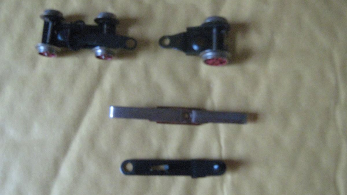

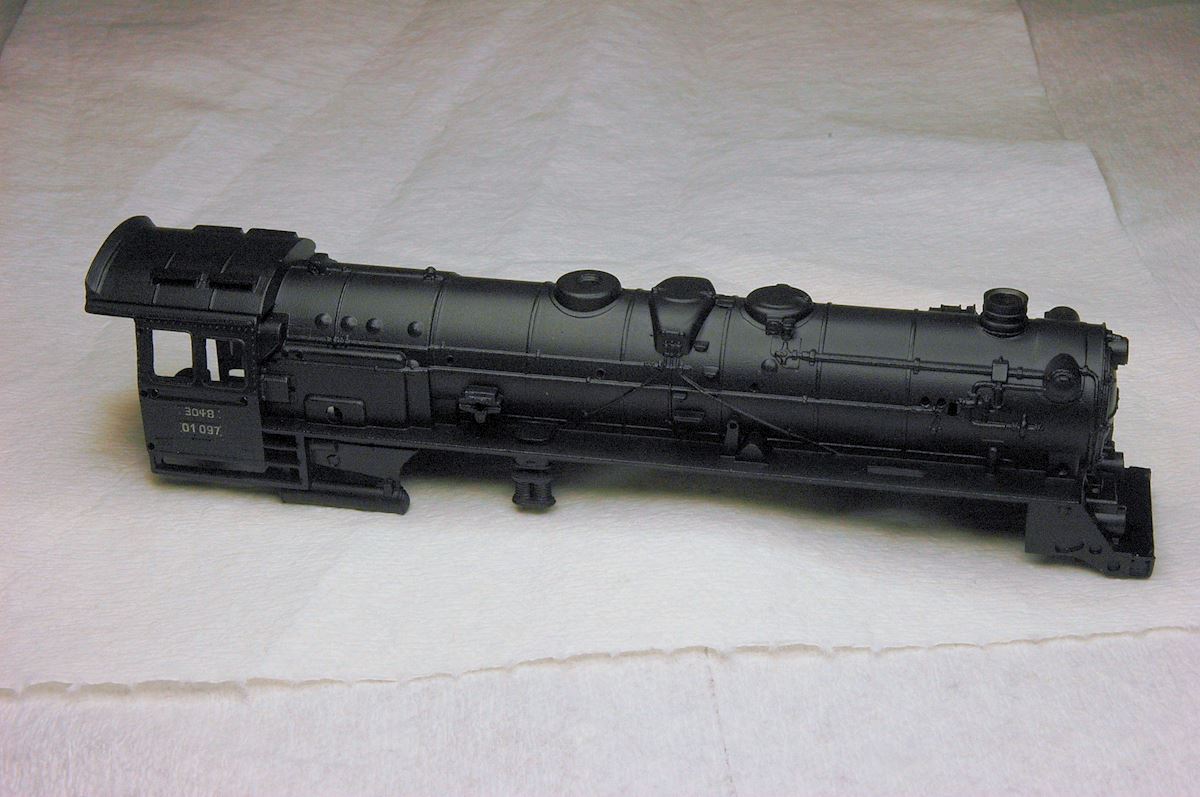

An update:
The chassis is painted and I am waiting on replacement idler gears for between the main drive wheels. They should arrive soon. Then assembly of the chassis can be completed.
In the mean time, I have glass beaded the front and rear trucks, the two steam cylinders and the main locomotive housing.
Here are the trucks and cylinders after painting.
Here are the trucks after assembly.
Here are the cylinders after removal of the paint on the high spots of the logo.
Here are all the screws repainted.
Here is the locomotive housing ready for paint.

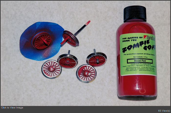

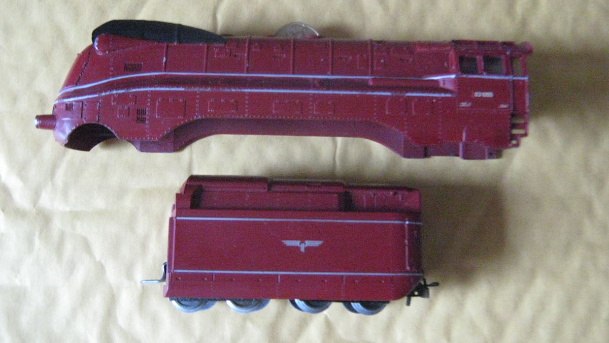

Some more progress on the restoration of the 3048:
I Finally got the shell painted:
And the wheels. I didn't like the Model Master paint so I started over and I found a real close match to the factory red using the DuraCoat firearm paint.
This is a comparison of the painted wheels against factory painted wheels.
So I am getting there, just other things keep getting in the way. Like work and business travel and the Porsche.
Edited by user 30 November 2017 04:08:28(UTC)  | Reason: Not specified
thanks 5 users liked this useful post by abisel

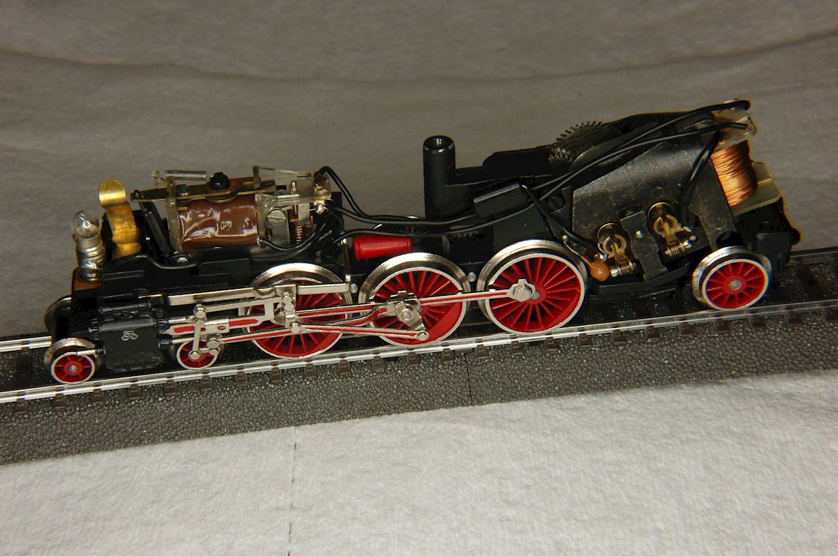

Another update:
The paint on the wheels has cured and installed into the chassis along with new gearing. Even though the wheels/axles did fit snugly with a slight knurling on the ends of the axles, I did apply just a dab of red Loctite just to make sure of no slippage.
Quartering was done by comparing another 3048 locomotive with the right side leading the left side by 90 degrees.
No binding anywhere.
Next is to mask off the loco housing and paint the trim edges red. Then a final clear coat.
Edited by user 30 November 2017 04:10:30(UTC)  | Reason: Not specified
thanks 6 users liked this useful post by abisel

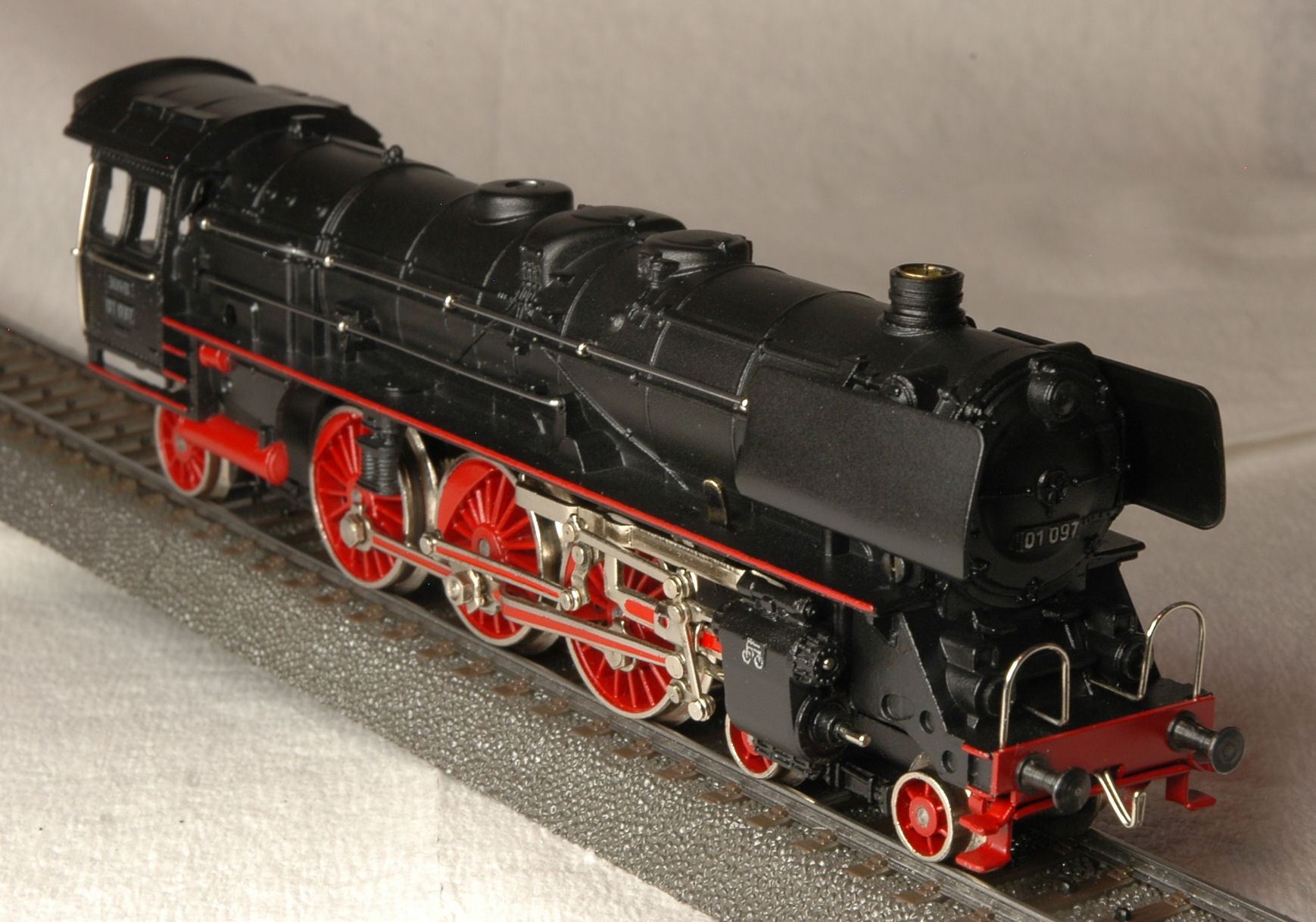

FINISHED
The chassis has the electrics installed.
The loco shell is painted and assembled.
And it runs fine.
Edited by user 30 November 2017 04:13:17(UTC)  | Reason: Not specified

Thanks to everyone for their inputs into the restoration of this loco. Even the smoke generator works great.
What started out as a lose drive wheel turned into a complete restoration.
  • Disassembly and determining what parts I needed to replace (axle bushings, gear train, armature, brushes).
  • Glass beading the metal components. Thanks to Klaus at Lindberg Motorsport for the use of his blast cabinet.
  • Sourcing new bushings for the axles. Custom made at a good price from American Sleeve Bearing.
  • Found an original steel replacement smoke stack from Ritter Restorations. Great people to deal with.
  • Digging out the old Badger 150 airbrush. I did have to buy a new compressor and got a little Blue Hawk.
    Blue Hawk Compressor
  • Trying to get the right color and durability paint. Ended up with firearm refinishing paint HK Black and Blood Red.
    DuraCoat

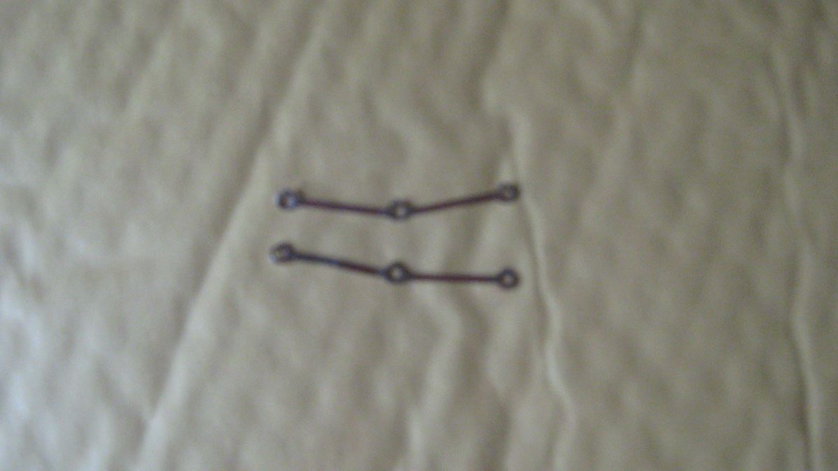

  • Using piano wire for the hand rails. Thanks to the local piano store and tuner for a free sample of No.12 wire that measures 0.029" or 0.74mm.
  • Purchased a pretty sweet tool for applying the red paint to the side of the loco. Not a constant flow technique, but rather a dab and drag technique is what I used.
    Paasche Striping Tool
All in all, it turned out pretty nice.
Thanks again to everyone.

There is only one point: I would have inserted a ball bearing into the gear box for the anchor axle! But that's all I have to mention.
And it runs fine.
I haven't seen a loco in such pristine condition like this in my collection for years, congratulations
