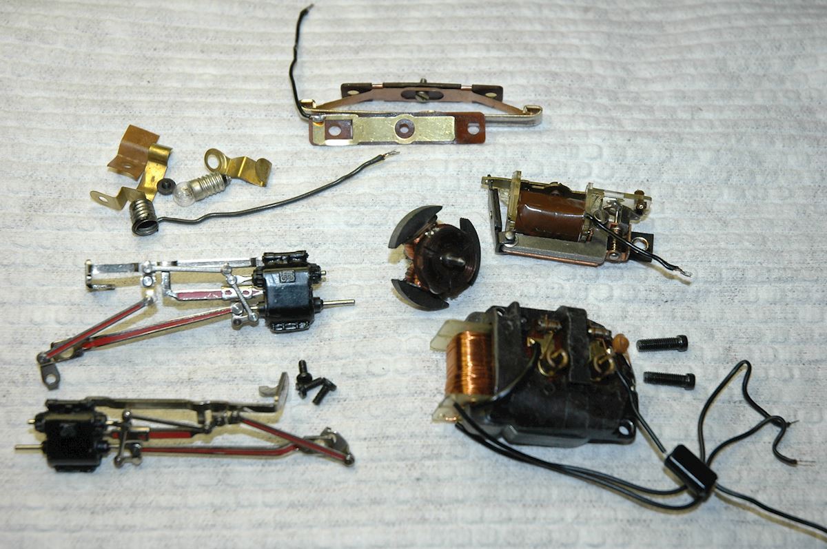

I am new to the forum and hope to get some help as I refurbish my old Marklin trains from 1960
The engines are:
3004, 3025, 3027 and 3048.
I have ordered a bunch of replacement parts for these engines (brushes, rotors, tires, pick-up shoes) and am currently working the 3048.
One problem I have is one of the main drive wheels opposite the gear train (the ones with the tires) spins on the axle. How can I repair this? Should I take a sharp set-point and give the center of the axle a hit with a small hammer or is there another way? Super glue? Locktite? Use the set-point and strike the inside of the wheel to close up the axle hole? Please advise.
Also, the smoke stack is broken flush with the housing. Is there a replacement stack available? This is the fiber composite stack of which the smoke generators slips into and believe the part number is 21-563.
One more thing, can these engines be converted to digital with the newer 5-pole motors?

Welcome to the forum Abisel!
There are many more knowledgable people on the forum that can help you, but I am working on similar issues.
I tried super glue on a motor gear. Held for a about 3 minutes of running and then slipped again.
I have heard mention of Locktite on other posts, but have no knowledge of it myself.
My motor gear was replacable and in this case I bought the 5 pole motor kit for it.
So, yes, many older motors can be converted.
Do you have local Marklin dealer to help you with spare parts? Concerning smokestack, that is likewise an interesting question for me.
The smokestack on mine is intact, but worn and chipped. Would love to know if its replaceable.
Re: "Use the set-point and strike the inside of the wheel to close up the axle hole? Please advise."
Personally, I would not do this. A dealer might have the correct equipment to reset this.
Hopefully others will offer some more advice and hope you enjoy the forum, advice, photos, and all.

regarding the wheel I would avoid hammering much because you'll end up deforming something and then the locomotive will start wobbling when it runs. In fact I am not sure if it is me but the axle attached to the wheel and gear doesn't look perfectly at 90 degrees already. If the wheel still turns when is in the proper position the end of the axle must be damaged. You could try super glue. You could also try adding some aluminium foil when you put the wheel on. If that doesn't work from time to time there is a seller listing on ebay that kind of second hand spares.
I don't believe you can ger replacement chimenney but you can easily make one with brass tubbing.
There is a thread about digitazing it just have a look in this forum, I saw it only a few days ago. It can be done with three poles, it seems you can also use five poles but you'll have to make minor modifications for the kit to fit.

Hello
Good idea, old Märklin locos are the best.ThumpUp
And you have a couple of treasures there: a 3025 is really a sought after collector item.Love
Having run a Märklin Service Station for a few years, I have seen dozens of these cases of "slipping drivers"RollEyes
The only durable way I know to fix this is to *lightly* knurl the axle, then re-press the drivers on the axle.
Knurling requires a lathe (+ knurling tool) and re-assembling requires a wheel press (+ appropriate pick-up inserts) , along with a quartering device to ensure the drivers cranks are exactly 90 deg. apart.
If you have these tools in your arsenal...I can give you the procedure...(although I'd suspect that if you do own these tools, and know how to use them you probably won't need any further instructionBigGrin )
As I no longer live in the US, it would be hard for me to help you here, however I do still have a colleague in the US that I am sure would be ready to help you.
As for the "fiber" smoke stackConfused , I have no idea of what you are referring to: this loco had a full metal body, and it looks as if the stack was filed off.Scared
Contact me with a PM if you are interested.Wink

Thanks to everyone for their replies.
*lightly* knurling the axle is probably the best solution. I do have accsss to the tools and will look into that solution.
The smoke generator on this loco slides into the stack and makes electrical connection with two contacts behind the light bulb. The outside body of the smoke generator is insulated from the body of the loco by the fiber composite smoke stack. Yes the stack was filed flush to the body some 10 years ago and forgotten about. Now it needs attention.
After some serious cleaning, closer examination of the gear train shows some wear. I could use a complete set of gears. This loco was run hard back in the day and all the teeth of each gear are worn and do not mesh very well. Backlash is excessive.
Then there are the brass/bronze bushings for the axles of the wheels. These axles have a lot of lateral play. Has anybody found a solution to replace these bushings? Maybe the miniature brass tubing from the model shops would work. Or the miniature bushings found in precision instruments. ID needs to be 2.5mm, OD no less than 3.5mm and a length of 11.5mm.
Standby as I pursue options.

Same answer as above....this is a standard rebuild job.
Used to be easy as Märklin was still selling parts, today no longer.
I manufacture it all myself, gears, bushings and all...
Again, if you don't feel able to do all this , my friend in the US would probably be able to help you.
If any specific gears are missing, he knows I can manufacture them.

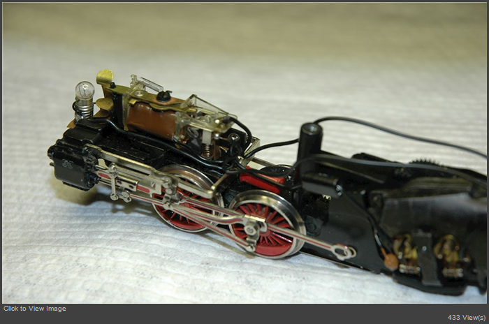

Thanks again for replies. Jacques, I will look into repair parts per your PM.
A couple more tear-down pictures:

From the look of it, gears look ok to me, altough I can't see the one on the rotor, which is usually the one with the highest wear...
Replacement rotors are relatively easy to find, considering that quite a number of them have been recovered from 5 pole motor conversions.
Mitutoyo caliper, heh?
Looks like you know the good stuff!

Hi Abisel and welcome to the forum,
these locos have taken a lot and I've bought one and must have been through the mill.
unless the gears make the loco stop at any given point I wouldn't worry too much about the gears been worn but there is a limit and to what extend,
another fact I noticed again on your first photo, the middle axle wheel isn't worn at all and this is another example, whereas Märklin had raised the middle axle slightly and this is also apparent on Co-Co locos. good luck with your repair.

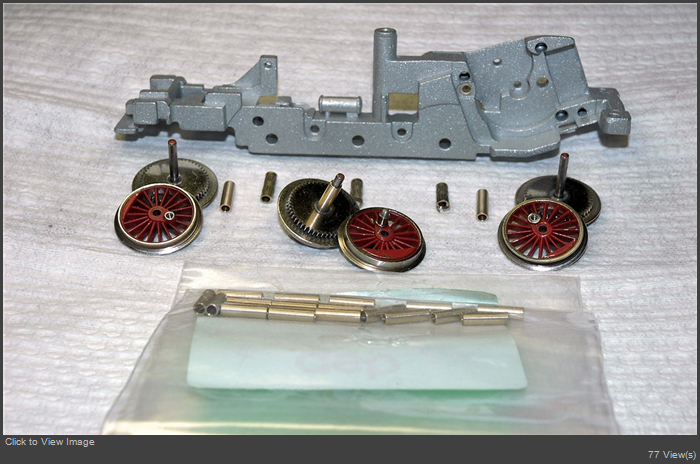

Thank you Jacques for posting answers in this very interesting topic.
Do you have any recommendation on how to replace a worn bushing? The bushing of the rear axle of my 3027 is completely worn.
It seems that it is not a good idea to press the old bushing out, is it? I remember reading somewhere that it is better practice to carefully drill it out.
Any advice is most welcome.

Hi Guus!
Not hard to do, it is rather a matter of having the "tricks" to get the right results!
With bushings, it is really a matter of having the proper tools and make the right decision wether to "replace" or "refill".
In the case of a 3027 and other similar Märklin loks of these vintages , where *all* axles are driven through gears, the precision of the axles' spacing is a little less critical since there is a little bit of longitudinal "play" in the coupling rods.
But what is paramount is perfect parallelism (and after re-assembly, perfect quartering of the drivers...) !
So rework or replace is the good choice in this case IMHO.
In a 3027 case, I'd press the worn bushing out, and first try to knurl the outside surface of the older part.
This procedure will tend to press the material together, reducing slightly the inner diameter and when re-inserted (with a parallel press!!) you will probably have compendated for the wear-out "play".
That failing, it is rather simple to use the lathe to make a new bushing.
Turn the outside diameter to be approx 0.05 mm (1/20 th mm) larger than the hole in the chassis, but create a 0.5 mm chamfer on the edge to facilitate insertion in the chassis.
While still on the lathe, use a center drill to start the center hole, then drill it to 2.4 mm (or better to 2.45 mm if you have such drill)
Use lots of small strokes, clean off the chips on the drill after each stroke and use a lot of cutting oil to avoid overheating/breaking which always leads to an unusable part...BigGrin
Since the hole you drill is always a little larger than the nominal diameter of the drill itself (due to a inherent but light "off-center" of the tip...), you'll have a good chance that the final hole diam is going to be "right on"....(i.e 2.53 to 2.55 mm)
Insert in the chassis (need a parallel press here..) and verify that the axle enters and turns without excessive play...
If not, use a hand reamer to progressively increase the inside dimension.
Work progressively and equally on both ends, so you will minimize induced alignment errors.
Most important tool: patience!
Usually, working fast means failure. Bored BigGrin
Voilà..you're done!

So, axle bushings will be on order Monday the 17th.
I did find that the gear on the rotor is worn and the first cog gear is worn as well. I do have a new rotor purchased and en-route, but now need the first cog and axle. Those too are on order and hopefully available. Then the fun of reassembly begins.

It has been a little while but there has been some progress on the rebuild.
Here is the stripped frame that has been glass beaded, the old bushings, and the new bushings.
Here is a close up of the new bushings with knurling.
Next I will be installing the bushing to the correct depth. On the left side, they stick out 1mm and 0.5mm on the right side. I will be using red Loctite to secure them. Then I'll paint the frame.
Edited by user 30 November 2017 03:30:57(UTC)  | Reason: Not specified

It's looking like a great rebuild! So, the bushings aren't holding tight on their own?
Offline abisel
#29 Posted : 19 January 2013 13:18:58(UTC)
abisel
Joined: 07/12/2012(UTC)
Posts: 139
Location: St. Charles, Missouri
The bushings will hold tight on their own. They measure 0.03mm larger than the hole. The knurling and red locktite is just added insurance.

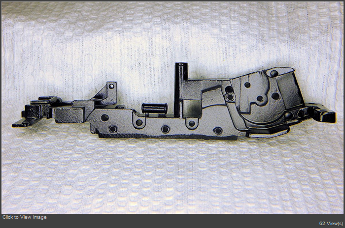

Next "episode" was paint.
Here is the first coat of Rust-Oleum Semi-Gloss Black which in my opinion matches the original black. At least I could not see any difference.
You can really see where the factory ground the casting a little along the bottom edge.
Of course if I don't like the final finish once I get the second coat applied, I can always strip it off and start over.
Edited by user 30 November 2017 04:19:37(UTC)  | Reason: Not specified

An update:
Like I said before, if I didn't like the paint finish I would strip it off. Well, that is exactly what happened.
The RustOleum rattle-can paint just isn't durable. So what would be a durable scratch resistant finish for Marklin locomotives?
Then I got to thinking about DuraCoat firearm finishes and will be looking into that product. They have a ton of colors (that can be mixed) and the paint is a 2-part product. Pigment and hardner which is designed for air brush application. Even though DuraCoat is designed for firearm re-finishing, it can be used on anything.
This link has pictures of the so called assault weapon so be advised.
http://www.houtsenterprises.net/dur_starter.html
I have asked for color samples and will see what they have in matte or semi-gloss black, and the same for the fire red used on wheels, chassis, etc.

I have sourced a precision bearings/bushing manuafacture that can make new bronze alloy bushings in 2.5mm ID, 3.5mm OD and 12mm OAL at a cost of $7.50 each. I specified these dimensions because of the measured dimensions of the axle (2.48mm), the OD of the existing bearing (3.48mm) and the OAL of the existing bearing (11.05mm). So how many should I order and pass on to fellow MRR's? I am also asking for a quote for oil impregnated bronze alloy bushing of the same size. Are there any other sizes to consider?
I missed this thread first time round but I am interested in the discussion about replacing the wheel-axle bushings.
I had some worn ones in a 3001 chassis many years ago and ordered replacements via the agent - supplied as Marklin part number 20025.
I was surprised to find they are supplied solid. I asked the person who was then acting as service agent how he drilled them out but that was considered a trade-secret. He'd do it for me but not tell me how to do it. Okaaaaay, so much for give a man a fish.... (I didn't have the tools to do it anyway but still wanted to know the theory behind it)
Another engineering friend did it for me quick as a flash but I always wondered why Marklin supply them solid rather than drilled. Is it preferred to fit and then drill them? How do they do it in the factory? - (maybe I should email and ask) but I'm interested of course in the comments here - so why are they supplied solid ex-factory?
Good topic
Steve
Top image is of new bushing end-on, lower image after drilling (click to see them clearer (smaller)
