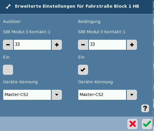

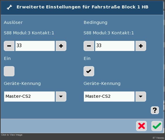

To get the blocks in the Train Controller to work with 2.2.0 (1) I have come to do the following:
