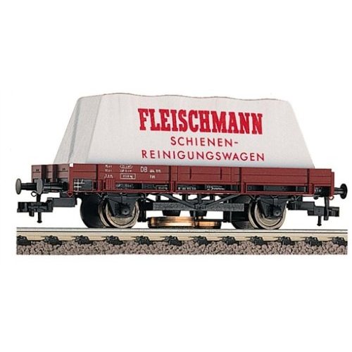

The Flieschman track cleaning wagon is one of the few purchases of rolling stock I made as a kid, but never felt it did much.
Perhaps I didn't run it enough. Anyone use a thing like this effectively?
- Mark
Perhaps I didn't run it enough. Anyone use a thing like this effectively?<
Two things,or many,....
Most cleaning wagens lack weight,to scrub the rails,nor are the pads or replacements cleaned/changed enough.
Now Weinert makes some nice all metal cleaning cars,....
