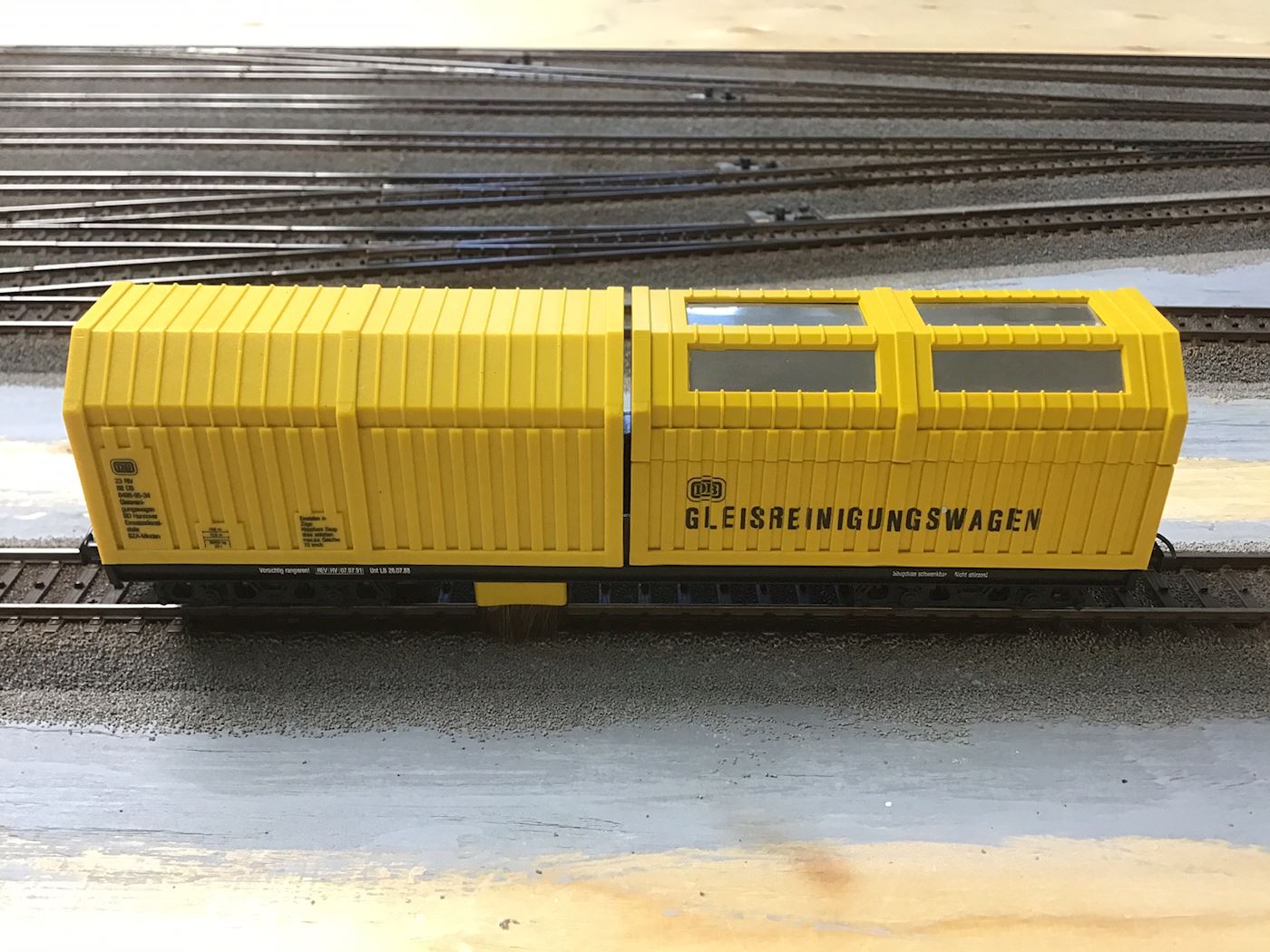

I too have the LUX vacuum car and it indeed works well. I also have the LUX rotating brush cleaner car and that is another story. It worked well for about a year and after that the brush only rotates when the power is first applied or when the wagon starts to move. Within seconds of starting to move the brush stops. Contacting LUX has really not provided any solutions.
So all I can say is that for the price these cleaning cars cost, buyer beware and keep an eye on the performance during the warranty period.

I too bought the Lux vacuum car, and rotating brush car. I have had them for several years. They have always worked well.
At the last Treff, in 2019 I bought a new brush for the rotating brush cleaner car. I installed the new brush last spring. The car has not worked properly since. I get the same symptoms as PMPeter.
I took it into Mike at Westend Trains in Toronto. After working on it, he says it is an issue with the electronics, and the car must to back to the factory. I will let you know the outcome.
Has anyone else any experience of this car?

After several e-mails to LUX I keep getting the same response that if the brush rotates during power up and initial movement, then it is not a LUX electronics problem, but probably a brush that is too low on the rails.
So I finally decided recently to take it all apart and reassemble it. With the motor disconnected from the gears, I tested the functionality and it worked perfectly upon power-up and wheel movement. So it had to be jamming with the gears. I reassembled them but did not put back the little black retaining clip and the car functions perfectly. Putting back the retaining clip causes the car to stop functioning after a while. Somehow that retaining clip must tighten itself and cause the gear to jam against the housing after a period of time. So I have now left it off and the car works without a problem.
Since your problem started after changing the brush, you could be experiencing a similar jamming problem.
thanks 2 users liked this useful post by PMPeter

I just received an e mail from Mike Sorge at Westend Trains. He has spoken with Lux. They have asked him to return the car.
Obviously it will be several weeks before we get a response.
I will forward PMPeter’s email to Mike. Maybe we can save a trans Atlantic trip for the Lux.
thanks 1 user liked this useful post by Dreadnought

Whatever Mike finds, in view of the other experiences here, the findings should filter back to Lux. It sounds like they have a manufacturing tolerance issue with the replacement parts.
Just to clarify, my problem developed with the original LUX cleaning car with no replacement parts or adjustments. It just stopped working one day. I believe the black retaining clip is used to hold that particular gear shaft in place while assembling the unit. Without it, the assembly becomes a little tedious. However, once assembled it really serves no purpose because the shaft cannot go anywhere, but the clip obviously does and tightens that particular gear against the housing.
I have now been operating the car since early Spring this year without the clip and have had no further issues.
In case anyone is wondering which retaining clip I am referring to, if you go to the LUX website and view any of the photos that show the gears for the brush assemblies, the middle gear has the little black clip on the shaft end. In my case the shaft is not grooved so the clip is just held on by friction, so it is relatively free to move. If the clip is too close to the gear, that gear jams against the assembly housing side and becomes very hard to turn.
