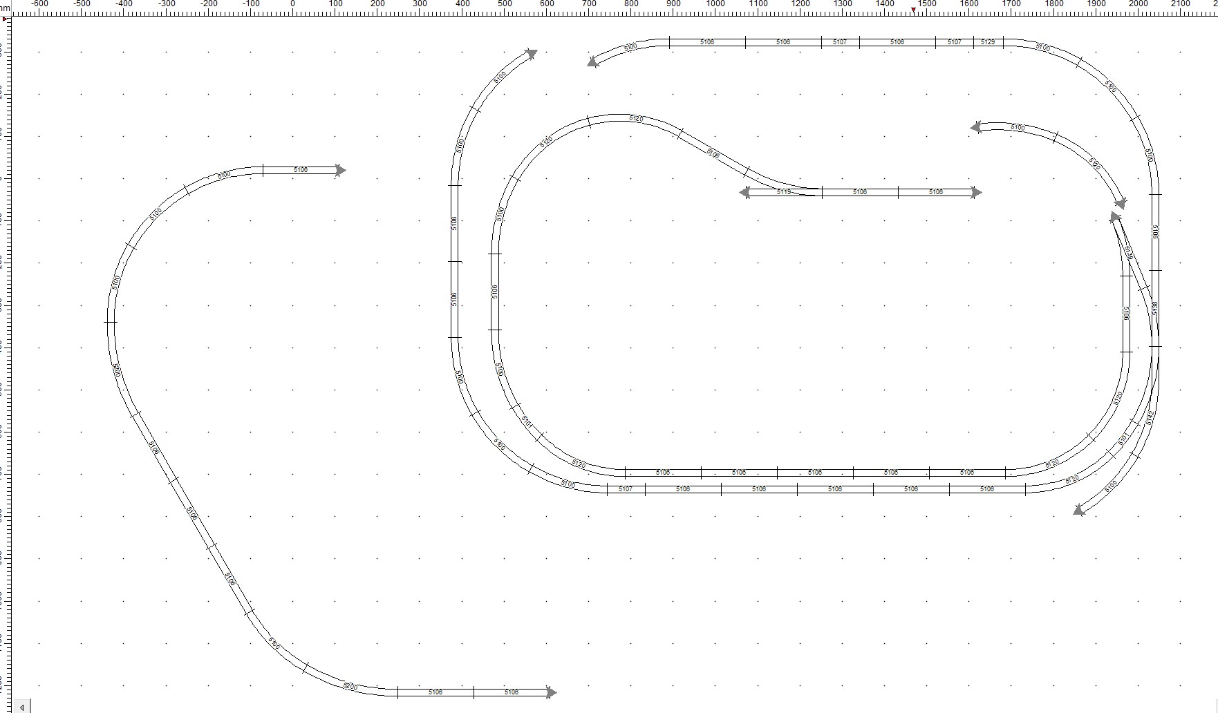

Offline joyofmarklin
#15 Posted : 22 March 2016 17:39:13(UTC)
joyofmarklin
Joined: 25/06/2012(UTC)
Posts: 117
Location: phoenix
image.jpegimage.jpegHi, struggling with SCARM to fine tune my layout! As you can see from the photo I have made it fit? However I need to get it right, to stop the derailing! No idea where I got the curve 5120 from. The short 5107 are automatic stop/ start switches. Also thing the gradient is too steep, just ok for a small locomotive , but not for the larger ones. Can anybody please fine tune this track for me so I know what extra track I need to find please?
Any assistance greatly appreciated.
Chris

Offline baggio
#16 Posted : 23 March 2016 02:24:58(UTC)
baggio
Joined: 21/09/2012(UTC)
Posts: 1,730
Location: Toronto
JoyofMarklin, my 2 cents' worth:
1. I have had my treasured FS424 fall off the (then) Marklin elevated track a bit like yours at slow speed for no apparent reason. So you may want NOT to leave the upper level unprotected. It may be expensive to protect it, however. Marklin has bridges with protective railings, but going around the curved portion and a bit of straight run may cost you CAD $450.00. However, if you are good with your hands, you could make a wooden support that would look very nice, protect the trains and cost much less. Do NOT saw anything on your own if you are not used to doing this; you could lose a finger or two. Scared
1.1 My present 2 rail elevated part is is more steady than my previous one (I was using plastic Lego-like pillars...) but is still subject to derailment and ONCE my Ice Train head loco did derail. It was my fault; the train was going much too fast! Blushing Surprisingly, it happened going UP the ramp and not DOWN the rump. Go figure.
2. If you use the popular green carpet, the layout will look MUCH better. It is not too expensive.
3. Any reason you are still using M tracks? C track is better.
4. You have space to do a better layout and WITHOUT computer assistance. Just layout the track and see what happens. That is what I do. I leave fancy computer planning to those who have a lot more space to play with.
5. If you have a bit of space, you may want to put a protected bridge between your present table and another table, maybe just for a parking siding. That is what I am planning on doing. I saw one on a YouTube video and I liked it.
Let us know your progress. BigGrin

Thanks for your input. Have just rediscovered M track, but with electric turnouts and signals, so enjoying my second childhood, (drinking brandy through a straw!)
Have just purchased some more pillars which help a lot but take on board to protect my precious locomotives and infact all the rolling stock. Need to get my layout right then will apply it to plywood covered by green carpet so I can hide under the many wires.
Evidentially will move to digital and perhaps C track, but enjoying this stage for the moment and much cheaper than replacing the track!
Don't know why when I upload the SCARM picture it reverts to the photo of my layout? So here is another try as would like a blueprint of my eventual layout!
