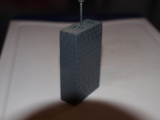

This is how I made relatively cheap wooden bridge pillars for the standard size Marklin bridges, which I think turned out ok for a first attemptLaugh

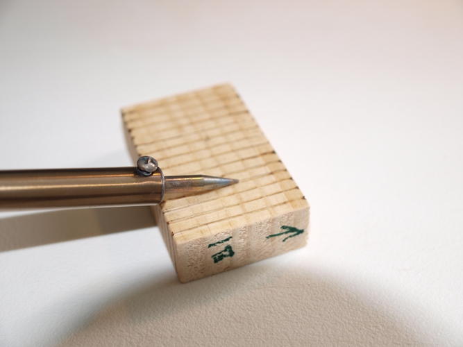

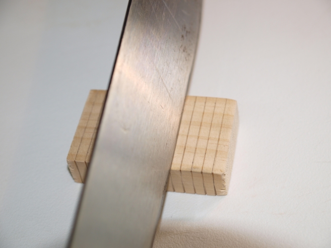

Soft pine wood. Cut to size and make lines with pencil:
Step 1
Use a sharp knife to make a dent horizontally:
Step 2

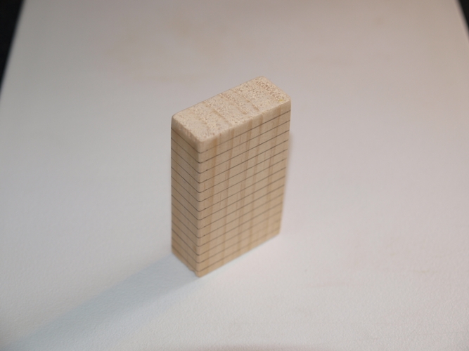

Deepen the cut using a soldering iron:
Step 3

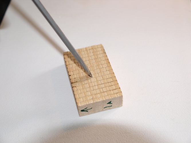

Use a sharp screw driver to make the vertical dents:
Step 4

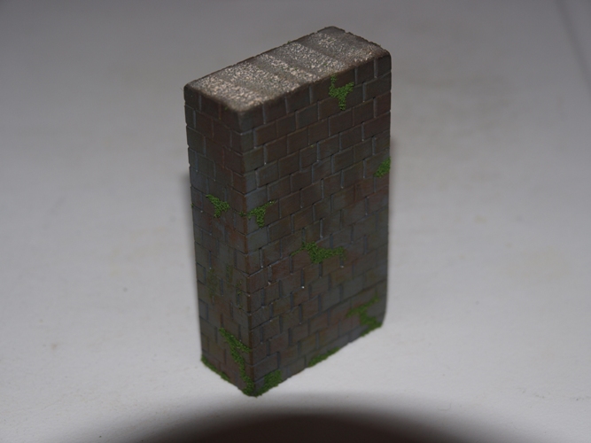

Spray paint in grey colour:
Step 5
Weathering (first a light grey colour and then various colours using dry brush techniques. Used some soft black pastel powder on top of pillar to simulate the soot from trains):

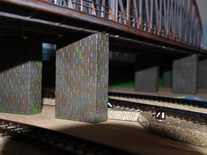

Step 6
In position taking the load!
Step 7
Brgs - Lasse

#14 Posted : 02 February 2012 23:31:24(UTC)
My bridge pillars were even quicker to make!
They were intended to imitate a concrete pillar rather than brick.
Take 2 pieces of 20mm MDF board, cut to approximate width and glue together. Once dry, setup an electric router (wood router not a network router) with a bullnose bit, and run pillars through the router, putting a rounded edge on each corner.
Cut pillars to needed height and paint and weather as needed!
Job done!
BTW Danlake, I do like the method you used to score the brick markings on your pillars.

Good idea Bigdaddynz with using a router for wood work. Must buy one of these for my toolbox.
Cheers - Lasse

Very nice pillars from both Lasse and Bigdaddynz and I could actually imagen using both techiques.
In cases where a single track line has been converted to double track, one track could be on a bridge with older pillars an the secon on one with newer pillars.
Then there is also a more sad aspect of having older and newer pillars and that goes in particular if you are building a layout in a German setting where many railway bridges were destroyed towards the end of the second world war. An example below, the Hohenzollernbrücke in Köln (Cologne).

Great idea "Western Pacific", having 2 types of bridge pillars. Food for thoughts for furture expansion plans!
#22 Posted : 05 February 2012 10:07:39(UTC)
Excellent work, something to remember when I'll be installing a few bridges on my future layout!
Just a suggestion (or constructive criticism if you prefer) if I may: You'll see that, in real life, most bridge pillars are not parallelipipedic in shape but rather truncaded pyramids.
Doesn't take anything away from your good technique though!!

are the supports holding M bridges or some other make. If M bridges are they the plastic or metal variety.
Why I ask is on the metal variety there are the holes to locate them to the M bridge pillars and I was wondering if you have used the same support point and how you locate them?

What type of wood do you use for the piers, balsa or something harder?

Robert, check Lasse's 1st post, he uses 'Soft Pine' wood. ThumpUp

I used some contact adhesive to attach the pillars to the base board. Then when dry, I used ordinary M track screws to fasten the bridges to the pillars.

The bridges are the "newer" one of plastic. I used contact adhesive as Bigdaddy to secure them.
I like the idea of making the pillars more pyramid shape.

http://www.qldrail.net/altkloster/twobridgeextension640.jpg
#39 Posted : 29 October 2012 19:06:43(UTC)
Posts: 9,328
Nice picture of bridge stone walls.
But i prefer by using plaster and scraping traces of stone wall.
Later i put colour.
In that way you will get more realistic bridge stone wall.
#40 Posted : 29 October 2012 19:09:00(UTC)
Posts: 9,328
If you shall use plastic walls i suggest you try to dirt with colour mixed with thinner and dry of with a clean cotton old T-shirt.
