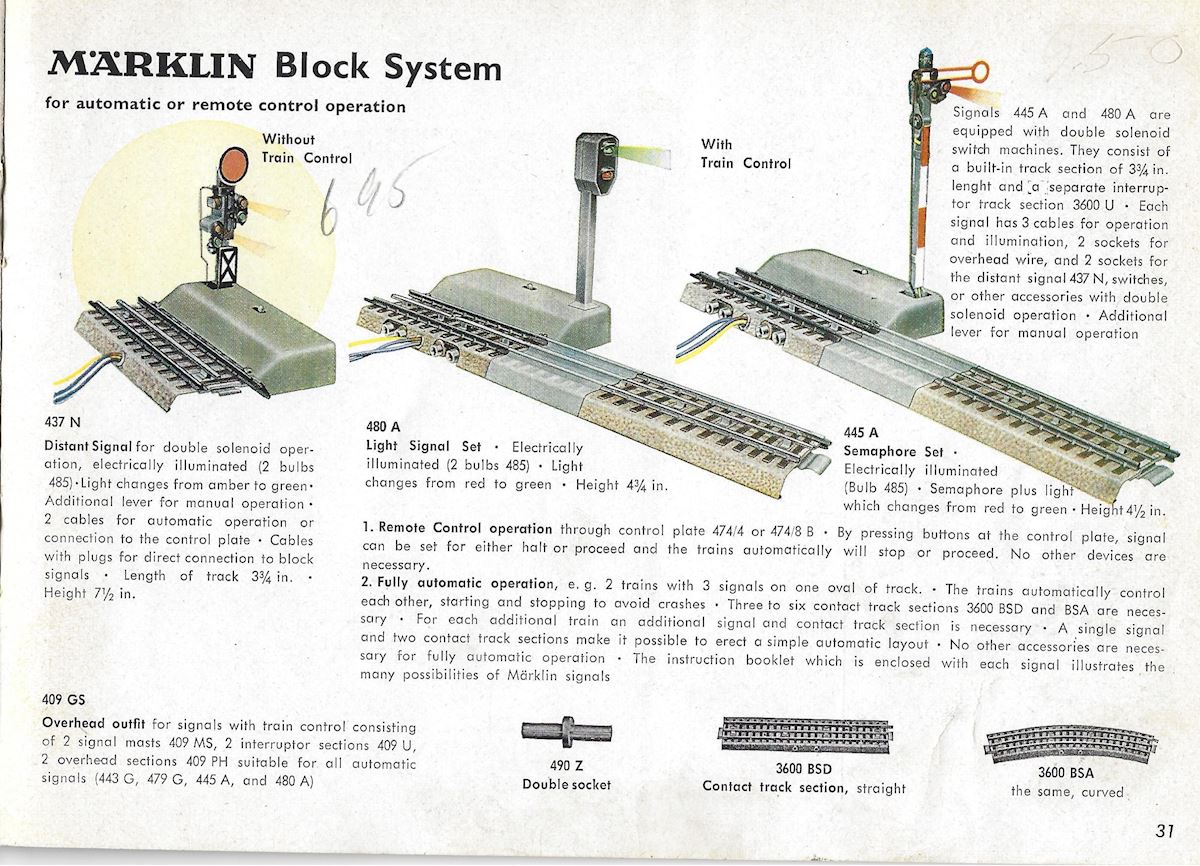

Hello collectors!

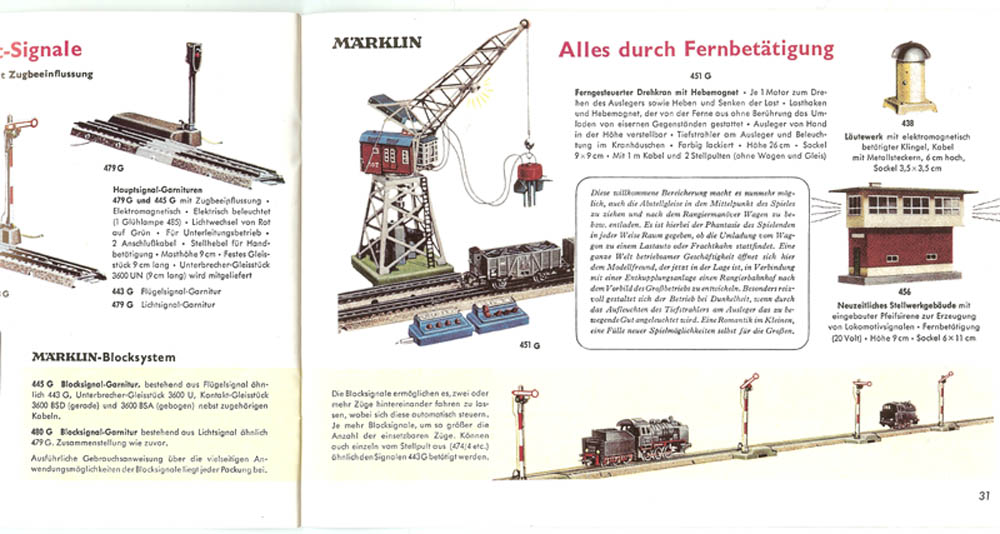

To celebrate the 60th anniversary of my Märklin addiction, I just drove to the Märklin Museum with one of my grandson.
The best surprize I found: they now sell a repro 1951 catalog (less than €10.00!), the very same one that I got at the time and literally wore out turning pages and making annotations of "what to buy next"...
Sounds familiar, anyone?
At the time, I did not catch (nor understood..) the little insert on pages 30 and 31 where, for the first time, Märklin was proposing an automated block system where the train would influence the signals.(see pic below)
These signals 445G and 480 G were, according to Koll, only produced for one year.
If I understand it right, these would be the only HO signals with double coils *and* a piece of track attached to it. (former ones had the pre WW II older system with single coil and a mechanical "ratchet" to switch from one aspect to the other.)
They would thus be the first double coil HO accessories proposed by Märklin.
The accompanying picture was probably taken with some of the early prototype, as the coil covers, with their double dimple, look quite different from the pictures in the Koll.
In the description, they mention the "Kontakt-Gleisstück" 3600 BSD and 3600 BSA, which do not appear in the 3600 track section of the catalog (but will be referenced in later editions)
There is also a note saying that a detailed Instruction sheet was delivered with the signals.
I have never see this sheet, and I'd love to take a peek at it!
Markus, would you come through once again? Wink
Thanks in advance

Hello everyone and I hope you folks still have some of those photos available. I am trying to understand the wiring and outputs for the two 445 G Signals I would like to use.
I understand that the yellow and 2 blue wires control the solenoid to change the signal. Those are hooked up. The lamps get power from the yellow wire and the ground is through the track - so that is easy enough.
The part I am having difficulty with is understanding the 4 open plugs and what Märklin might have had as an example in the original instructions.......Confused

I do get track voltage from the red outlet to ground.
In Jacques first post the picture is a little blurry, but I do see it mention using with the 3600 straight or curved contact track. Perhaps one set of connectors is for that?

What I am trying to identify is what these 4 electrical connections are for. I assume one set is for the oberleitung. Aber, ich habe keine Ahnung. Confused
signal
thanks 1 user liked this useful post by White Buffalo

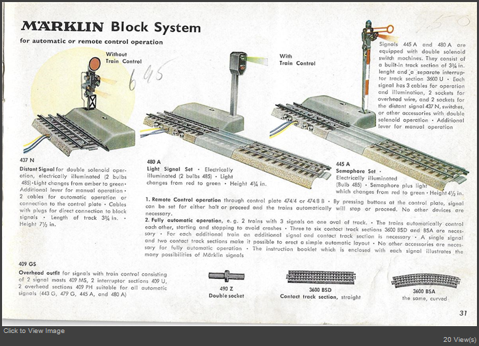

Rich - As per the attached scanned page from my 1952 catalog - One set IS for catenary and the other set is for pretty much whatever other double solenoid accessory you want to use.
Signals 445 A and 480 A are equipped with double solenoid switch machines. They consist of a built-in track section of 3 3/4 in. length and a separate interruptor track section 3600 U - Each signal has 3 cables for operation and illumination, 2 sockets for overhead wire, and 2 sockets for the distant signal 437 N, switches, or other accessories with double solenoid operation - Additional lever for manual operation.
