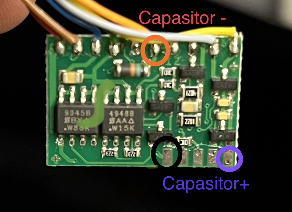

An old thread, but since it covers the power for the decoder very well, I’d like to ask for powering the motor also.
So I still have a few locos with 60760 (those that are inside the ”shrink tube” sort of isolator cover. I’ve yet to open one up)
Anyways my slow speed yard operations are somewhat ruined because locos stop on some turnouts (threeway especially).
So does powering the motor differ in someway?
I’ve succesfully made 1-2 Farad powerpacks with 100 ohm resistor and a diod for mLD3 and mSD3.
I’d wish to add same kind to 60760, so are the connections different than for the alzheimers solution?
-Eino
#22 Posted : 20 January 2023 19:06:40(UTC)
Posts: 15,552
The circuit shown here buffers the 5 V used by the processor chip to prevent memory loss (between black and violet).
Buffering motor power would occur between orange and violet and requires capacitors for a higher voltage.
It can't harm to add both capacitors (5 V and motor power).

#23 Posted : 20 January 2023 19:50:56(UTC)
einotuominen
Joined: 19/09/2022(UTC)
Posts: 464
Location: Kaarina
So 25V to these purple and yellow connections right? That will power the motor. It of course won't do much if the decoder shuts down, so then I would need another powepack around 470uF of 5V that would connect minus to the black circle and plus again to the purple? Would the power pack that powers the decoder be built the same way as for motor? 100 ohm resistor and a diod?
I assume you mean 0.001 to 0.002 Farad.
That's what I wrote ;) sorry my bad. 1000-2000uF.
Thanks!
-Eino

#24 Posted : 20 January 2023 20:27:13(UTC)
Posts: 15,552
Purple and orange.
I assume you will need 50 V capacitors if analogue operation shall be possible. 25 V or 35 V should be enough for digital only operation.
HGH also recommends 50 V:

Purple and orange.
https://moba-hgh.de/mode...maerklin-trix-power-pack
Yes, orange not yellow, sorry.
Is polarity correct, minus to the orange?
Only digital, no analog.
I’ll check that link.
Thank you for your help!
-Eino
#26 Posted : 20 January 2023 21:40:01(UTC)
Posts: 15,552
Orange is plus and purple is minus, as shown in the diagram above.
Offline einotuominen
#27 Posted : 20 January 2023 22:17:07(UTC)
einotuominen
Posts: 464
Location: Kaarina
Ah, plus of course to the common wire.
