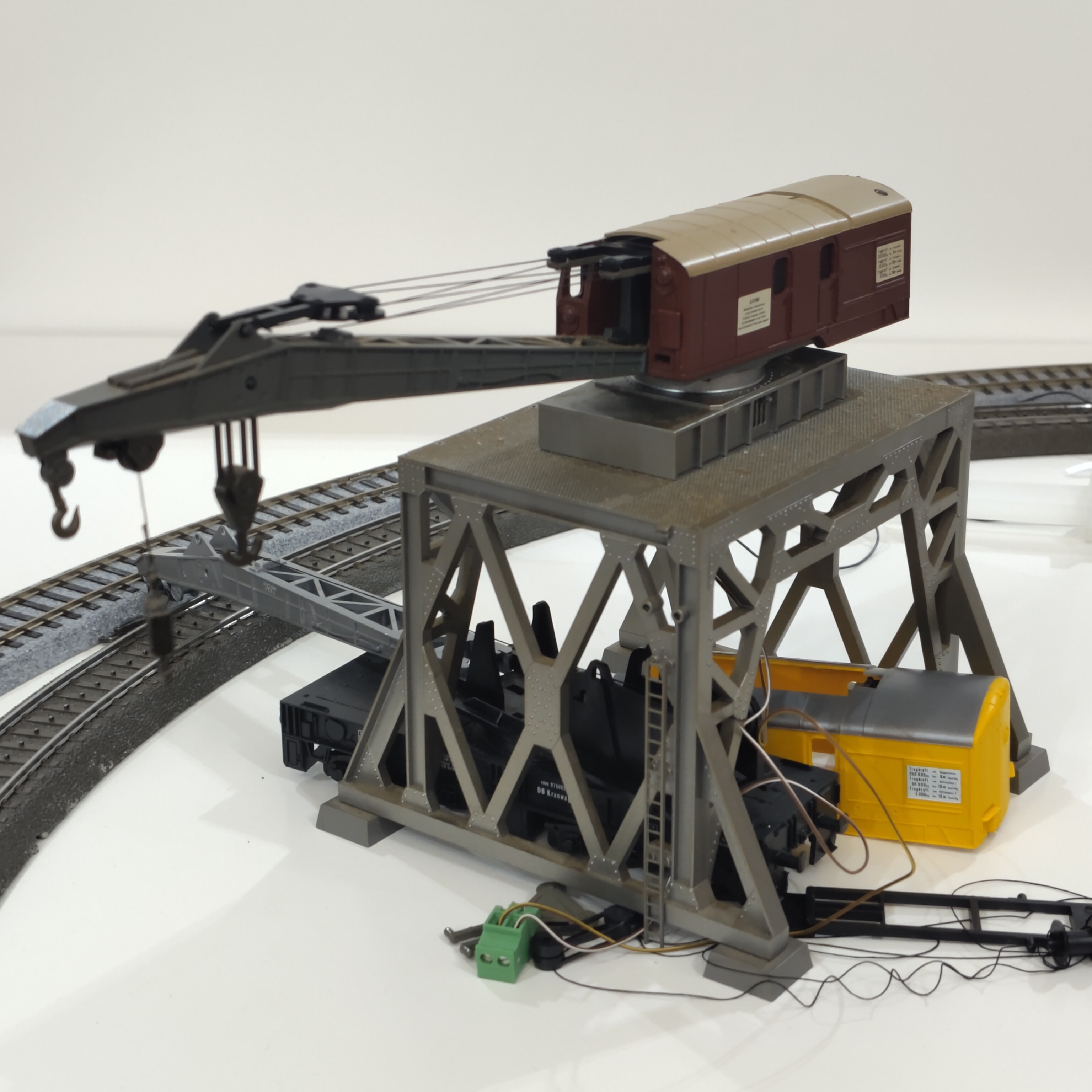

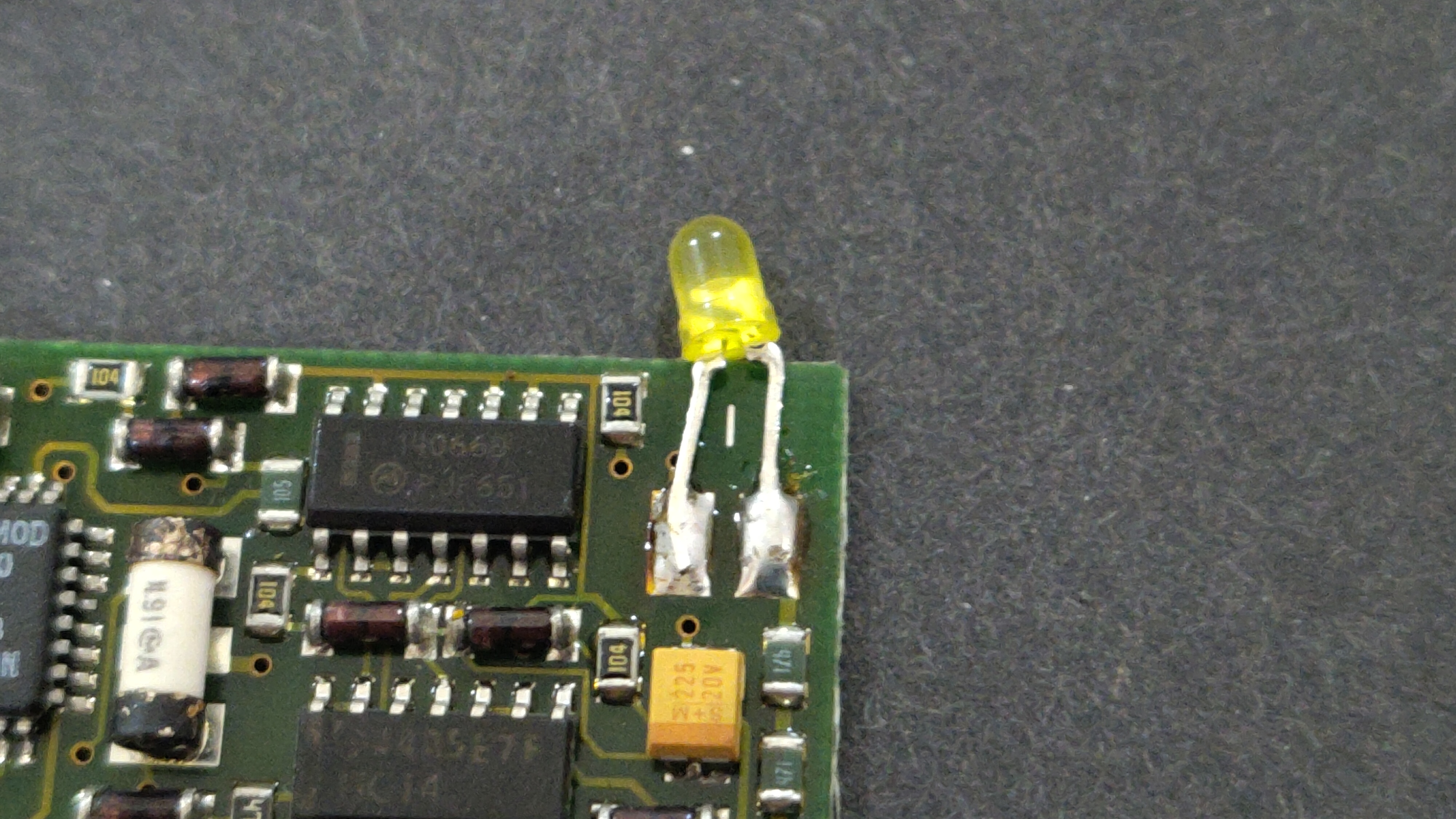

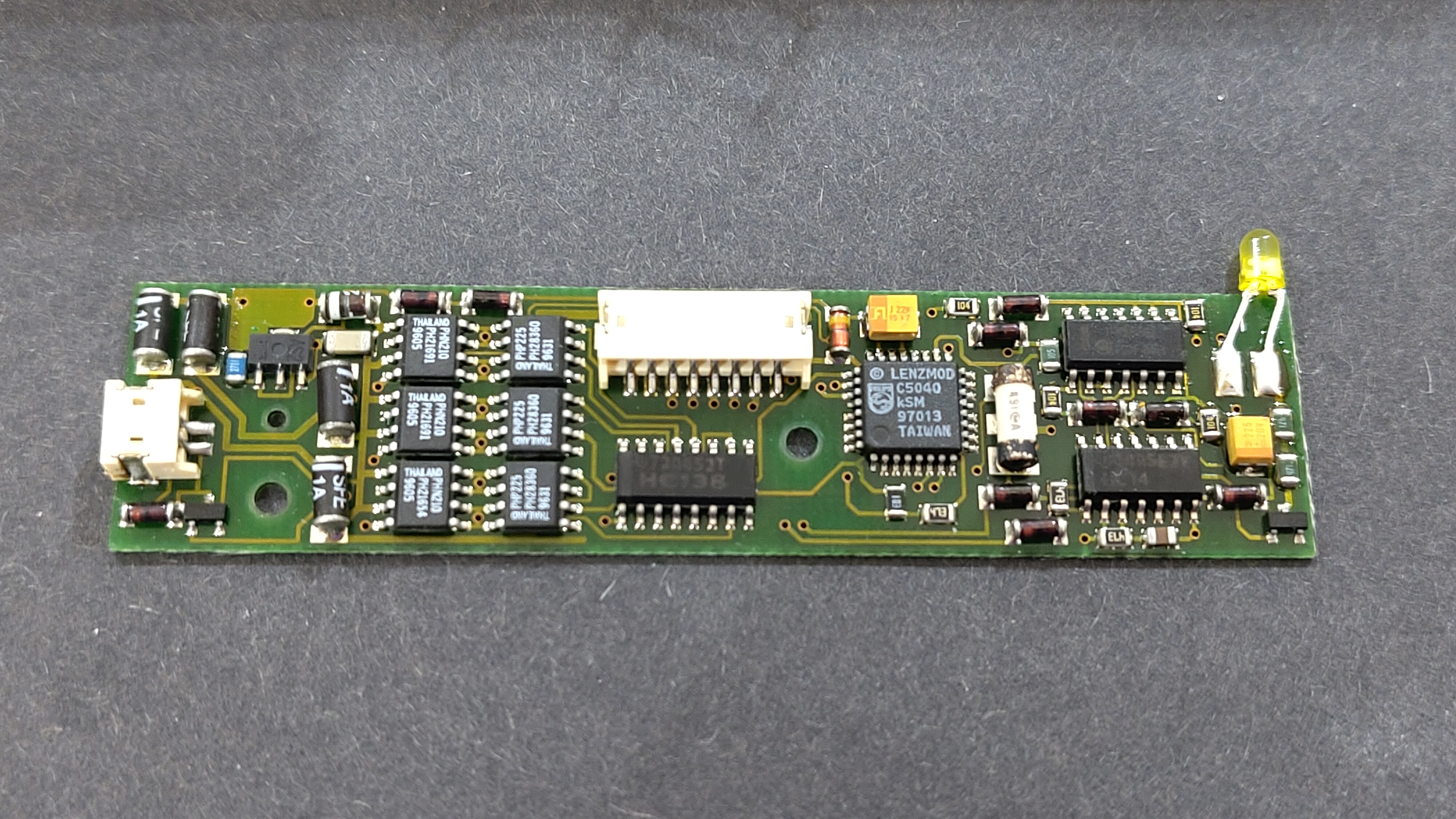

Portal crane turned up!
A Roco manual crane denuded of most of it's parts.
To shreds, you say?
There is really not much left of my mechanical parts crane. The pin that holds the spare hook, and I ended up taking both rollers for visual uniformity.

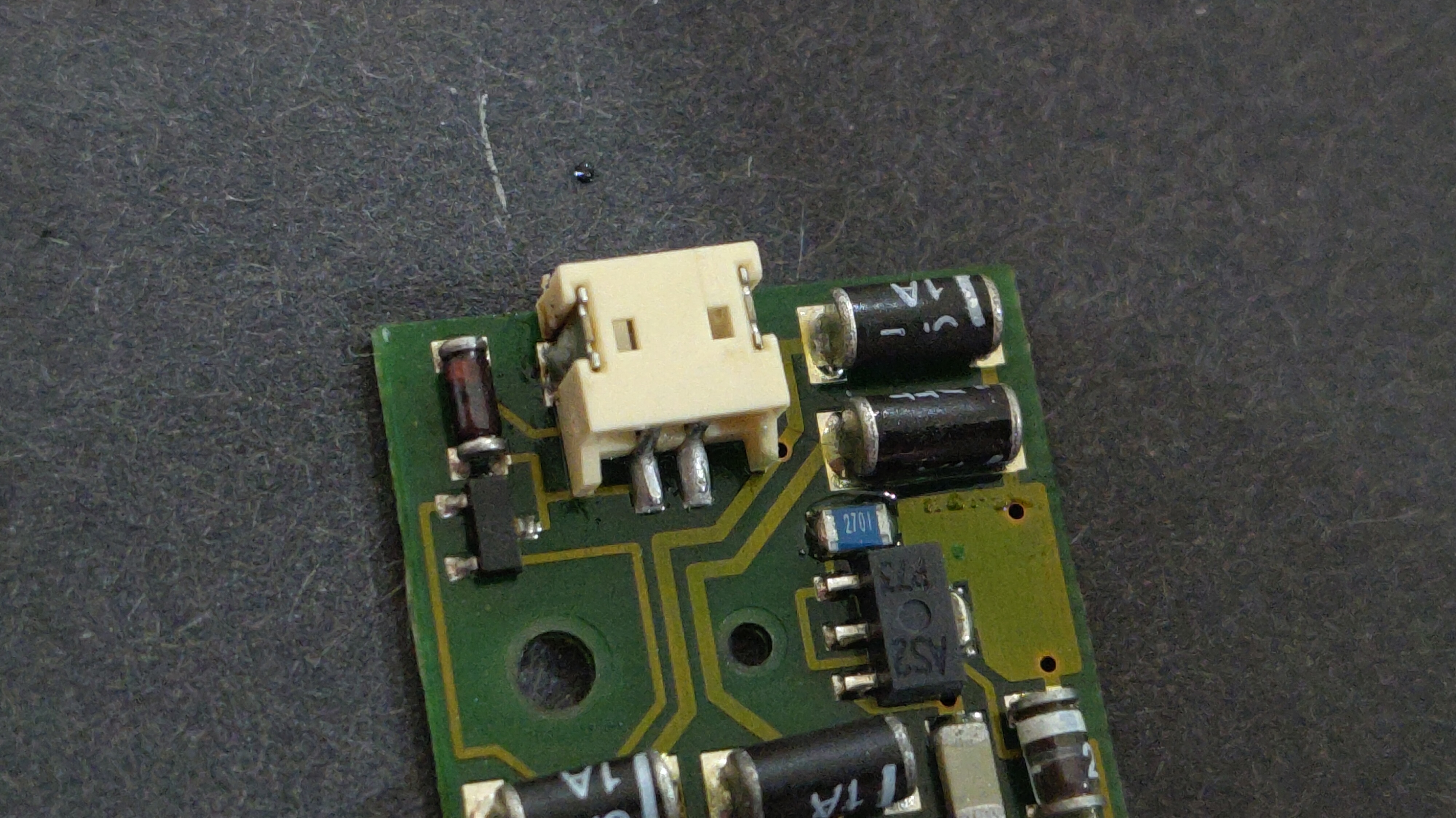

The decoder had clearly had some rough treatment. It's a v2 decoder (the stock one from the first rail crane was a v3), and both the LED and accessory socket had been knocked loose - luckily without pad damage.
A Lenz RKRAN-V2 decoder, showing a slightly dodgy LED repair
Not my best work.
A Lenz RKRAN-V2 decoder, showing a slightly dodgy socket repair
Somewhat better. Honestly, SMD work terrifies me so I'm happy to have done this well with my little pinecil. Anyway, now repaired this is going into stock as "untested spare crane decoder".
The "track" feed wires were also shot and hilariously badly bodged, so I replaced them with two of the unused function wires from my Class 22's MLD3 kit.
And it almost entirely works! The rotation motor isn't looking too healthy, it's slow but fine forward, but back it stops after a couple seconds. Not sure if it's a simple failing brush problem or something more serious, but I'm not investigating right now. It may be Derek Zoolander in that it can only turn left, but it works.
Oh, and the railings are completely shot; maybe one can be salvaged if I can solder the mounting pin back on - but there's too many missing to do both. So that's a challenge for another day.
A Roco 40106 (I think) DCC Portal Crane!
Not too shabby for 20 minutes work (including the time to recondition the now-spare decoder) and some parts from a hand-crank crane. Apart from investigating the motor, the only thing needs doing on this is that the cable guide is missing. Should be an "easily printable" kind of thing so next time I have one of the other cranes apart I'll get photographs and measurements so I can clone it. It's not actually critical to operation so it'll do without as long as I'm careful to watch for any snagging.
The motor is listed as "discontinued, but available". So that's good to know for now, unfortunately it's also 82eur. They also have an "accessory bag", what might actually be the missing cable guide, and amusingly - a green housing. Maybe I should get that for one of my rail cranes, and have yellow, green, and red! Then I just need a blue one and I have Smarties!
Anyway - it should be safe for me to do diagnostics, and in the meantime I might pick up the accessories and cable guide - it would olve my missing part and might also replace my missing steps and railings!
thanks 3 users liked this useful post by EB421

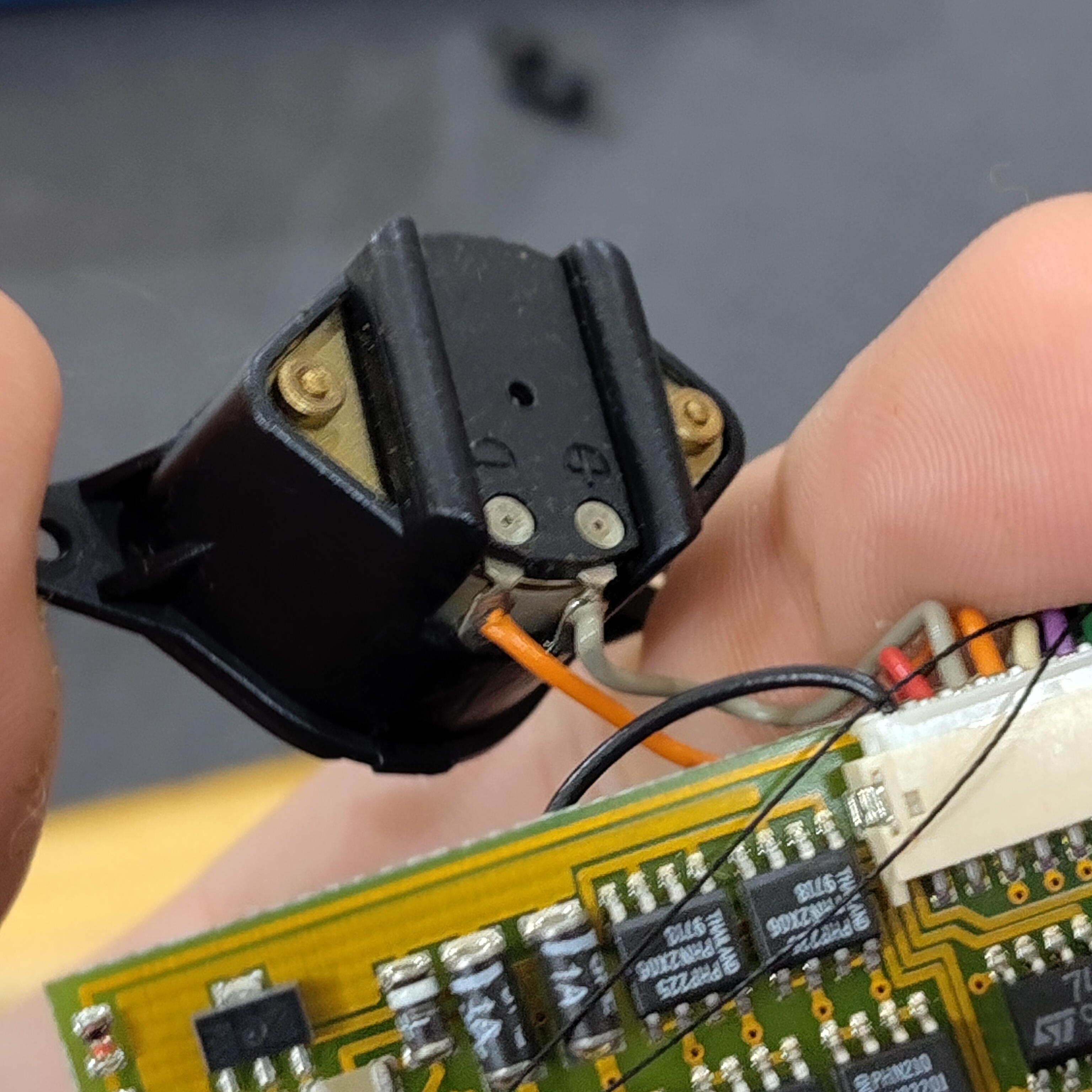

So, I'm weighing up whether to order a spare motor.
The motor from a 40106 Portalkran
It's working, it's smooth, and it seems to be going a full rotation before stopping now, so that may be a deliberate feature? But it's not the healthiest motor ever and there is a slight smell to it. But you're talking £100 by the time it lands, which is a lot of money for a whim.
What's less working is the original decoder.
A (dead) Zimo RKRAN_V2 decoder
As you can see, I improved my solder joints on the LED, buuuuut when I tested the decoder, it's actually just dead anyway. RIP. The obvious question is "what's wrong with it". Comparing it with the photo in the parts manual for the 40110 (same as my 40106/40109 - but with the fancier boom) there's no visible damage to any component except the big one to the right of the μC - hard to say what it is, since I'm not an expert. Fuse, inductor, high power resistor? In any case, the damage is on the terminals and not the body of the component where I'd expect for a blown fuse, and at a cursory glance it doesn't appear to be in the power circuit. So; not confident in that analysis. It's not worth spending any serious time one, but if I get bored some time I might take a multimeter to the thing. It's a pity Marklin hate selling their mainboards - it would be a fun game to try and apply the 46719 boards to one of these. In any case; all my cranes have working decoders, and this is a spare to play around with some time. Looking at the IC markings on this and a few other Lenz decoders - this is a modified LE040/10040 (or "4th generation") decoder. Ironically, those are rarer than these are. Go figure.
The biggest problems for repairing these then are the decoders and motors. Replacement aftermarket decoders are available, but only in Germany, and by the time you add the LokPilot you're at €100 and change. Then, you have the price of the replacement motors - at about €80 each, that's pretty fatal if one packs up, even while you can still get spares. There's a few more Portal Cranes on eBay.de at the moment. I'm bidding on the cheap one, but looking at it, the LED is yellow; which means it's the same v2 decoder that's a corpse here. Given that it's also advertised as "dead", I'm bidding on the assumption that at least the decoder is also fried on this one, and it'll be a static model for now. It's also going to need the sacrifice of another hand-crank crane as rollers, the hook, the cables are all missing. Expect about a €150 repair bill to get that one back in order!
I took the time to clean up while I was doing the testing - and I think this is now pretty good - other than the missing cable guide, railings and top steps.
Roco 40106 (probably) Portalkran, but this time it's clean.

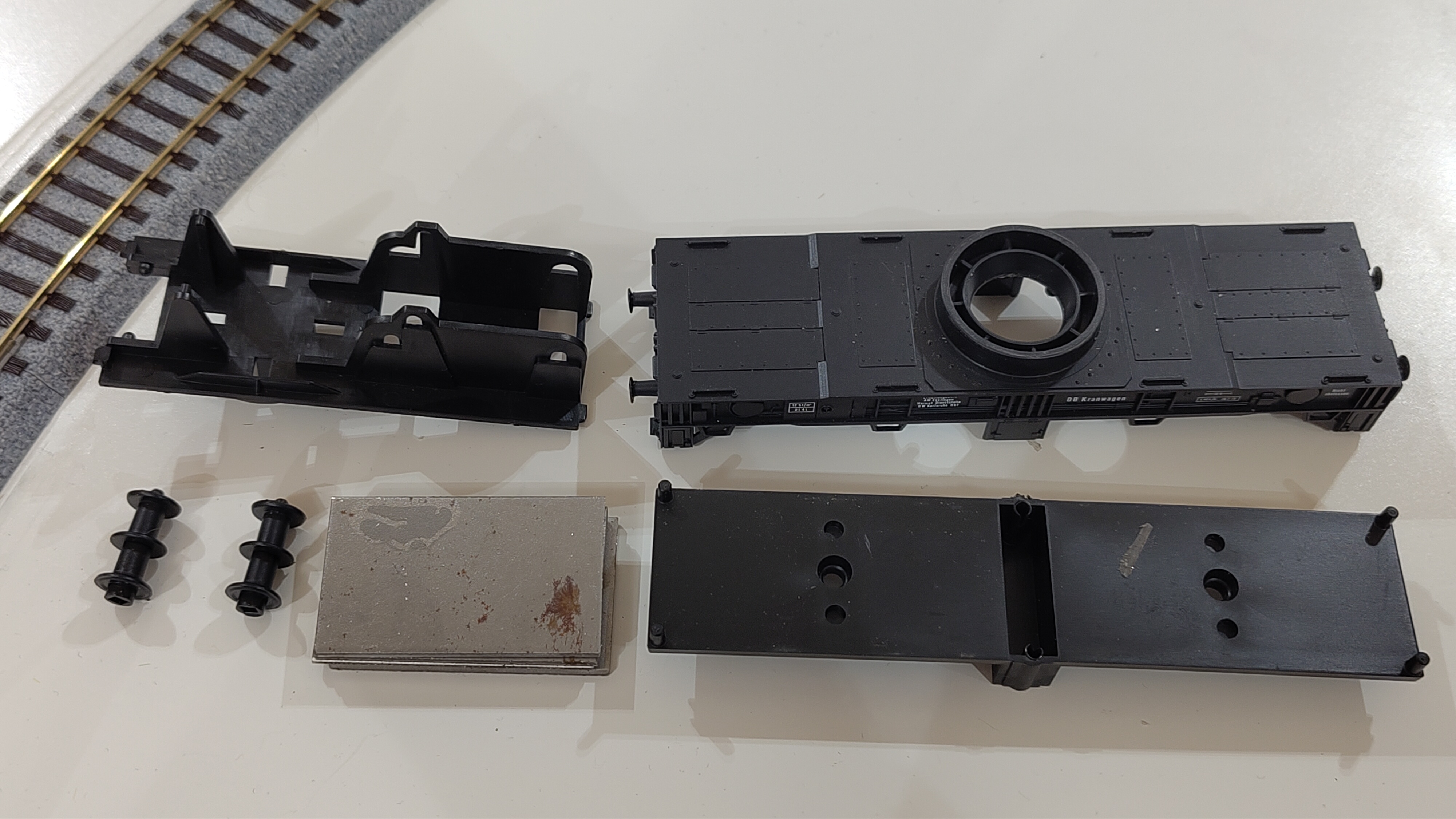

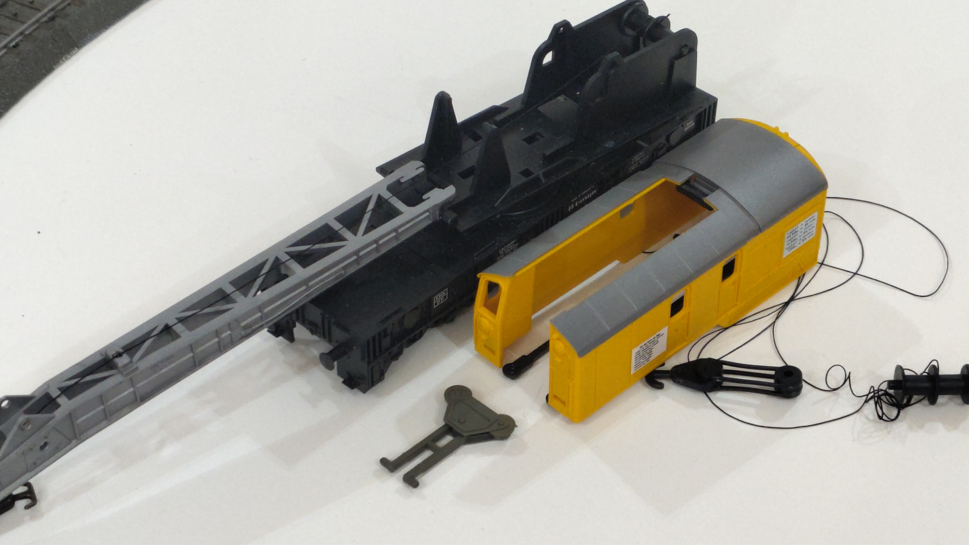

Anyway, I took some time to tidy up my work bench. Here are the parts from a Roco START crane that have no use for repairing a Digital Railway Crane 4680x/4690x or a Digital Portal Cran 40106 to 40111.
The scrap parts from a Roco 46311.
Efficient, no?
If you wanted to, you could keep the chassis, chassis plate, bogie and wheelsets together and scratchbuild something on top. But in my case they'd broken part of the chassis body when fitting the Roco tentacle-coupling-things that were in the NEM pockets, and I don't have a huge amount of reason to do that. So, it'll get hung onto as "litter", something I can airbrush rust-red and dump in a scrapyard (probably as a basis to fill out a larger pile of stuff). Also, SON OF A - as well as damaging the chassis body, they'd actually pulled the buffers, cut them to be "retracted" like a coach using it's Janney coupler, and glued the heads straight onto the bosses. If I'd bought ANY OTHER crane, I'd have buffers on mine. frustrated grumbling. Never mind, I got £10 of Fleischmann NEM pockets because of it, and if I don't end up getting another parts crane, they're part no 98979 and €1.80 each. But jeez.
Anyway - here's the re-use list:
  • As above, the bogies can't be used as-is but the side-frames can be cut off and used to repair those of an existing digital bogie. They could also be modified if you scratchbuild your own pickups and cut off the Fleischmann coupler mounting arm.
  • The cab-side roller-frame needs the rear 20% cut off, but then should work fine.
  • The boom needs the fake rollers cut off, and a real metal roller-unit from a digital crane boom installed. It also needs the stop-blocks at the bottom replicated with some styrene block. It won't replace a missing boom (I mean it will, but without the roller-unit you'll not have the best time), but if you have that roller-unit you can replace a snapped one.
  • The body can be used by de-soldering the LED from the decoder, or drilling a hole for it, except possibly the 40110/40111? Because of the taller boom, these have a different body shell. However, the 40110 ersatzteilliste shows the older lifting-roof design as a spare, so maybe you can still use it but it will be uglier?
  • The roof and roof-clip can be used as-is.
  • The remaining rollers can be used as-is.
  • The hook/cord and boom cord can be used either as-is, or by cutting off the knots and making new ones. Not tested.
  • The "spare hooks" on the boom can be used as-is - though note the big one is plastic, vs metal on the digital.
  • The wheelsets can be used as-is.
  • The buffers can be used as-is.
As for "parts that can be used elsewhere" - the steel weights can find a use on something that needs to be heavier. The couplings can be re-used on anything with a Fleischmann coupler pocket, but why the hell aren't you NEM fitting those you weirdo. And my favourite part - the hand cranks fit the drums on the Lima and Hornby H0 gauge cranes. So if you have one of those, you now have two spare cranks. It's the little things in life!
Oh, and something interesting - this was hilariously mis-listed as an AC 40111 which I could see was wrong from the boom. I wasn't sure if it was a 40106 or a 40109 though. Looking at them online they share the rail-style boom, the red body and the yellow-led decoder. But; looking at teardown photos (and that eBay replacement mainboard) the most visible difference (once you have them open, it's impossible to tell externally) is that the 40109 has a double-accessory-socket decoder, while the 40106 has a single-accessory-socket decoder. So; I guess this one's a 40106! Good to know!
