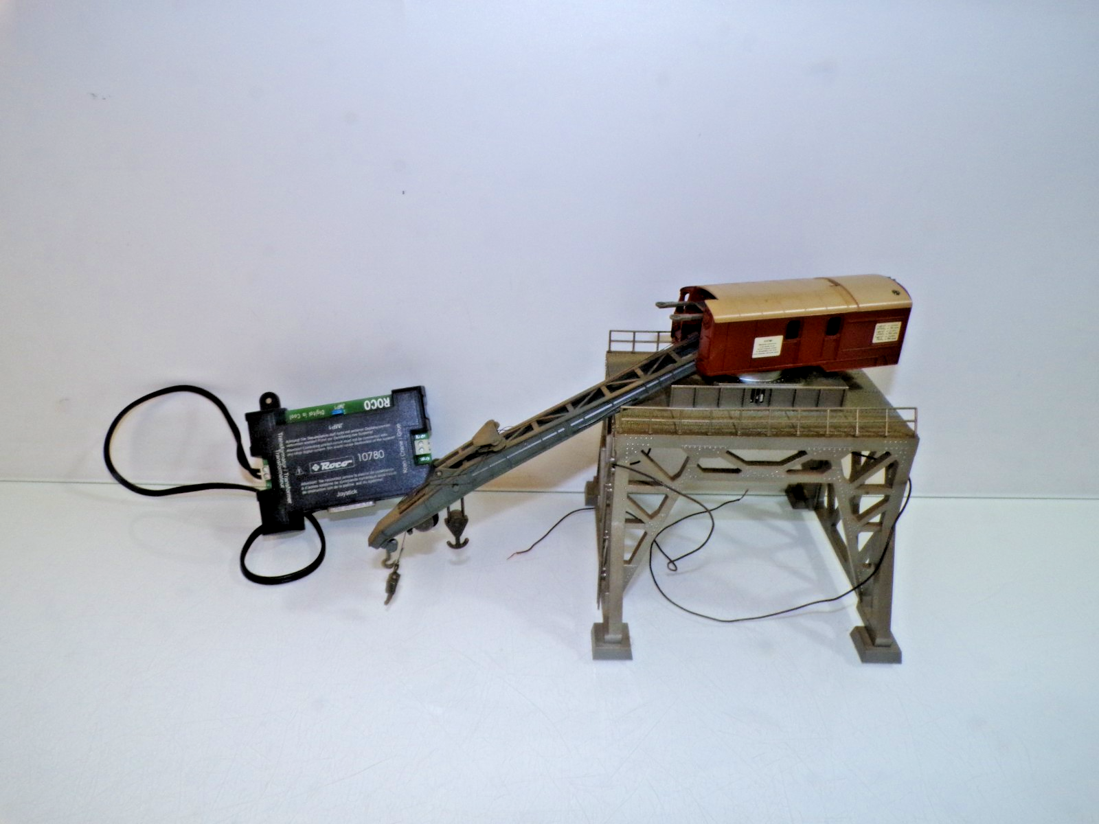

Summary; there are three decoders. 96507, which is hard-wired. This is mainly used by the 41290 portal crane; but I think it's in some rail cranes. This decoder is dual-mode Motorola+DCC but doesn't have DIP switches for address selection in Motorola mode. I'm unclear of it's features in either mode. 96519 is the "AC" decoder, which is replaceable and is used in 46900 and 40111 I've seen versions with DIP-switches and versions with solder pads for address selection. There is also 96518, used in 46800, 40109 and 40110. This is DCC. I believe there were also other variants (46801, 46902, etc) in different liveries. The decoders should be similar to the "round number".
The DCC crane seems to cause some confusion for people because of it's programming limitations. To sum up: It is a pre-railcom decoder. It only supports short addresses. Most confusion comes from the speed step limitations.
The "recommended" method of operation of the cranes is with 10780 (DCC) and 10781 (Motorola), which are interfaces from a 15-pin PC joystick and act as standalone DCC/MM controllers. In the case of DCC, it is this controller that is limited to 14 speed steps, and decoder addresses 6/7/8. This is why from the factory, the decoders are configured at address 8 and 14 speed steps. However, setting CV29 to say, 18, the decoder functions in 28 (but not 128) speed step mode. If you set 28 steps or change the address outside this range you will not be able to use the joystick controller; but you'll have an easier time on modern DCC. Because the cranes have motors, they program normally on a programming track.
Control of the DCC crane (rail or portal) is as follows:
F0: rotate using speed control
F1: raise/lower boom using speed control
F0+F1: raise/lower hook using speed control.
If you have the 46807 excavator shovel or 46807 electromagnet, this is operated with no functions on by sending a "burst" with the speed control. Forwards: on, Backwards: off.

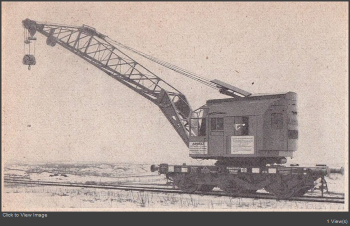

Came across a few photos of the Krupp-Ardelt 6t 103 prototype.

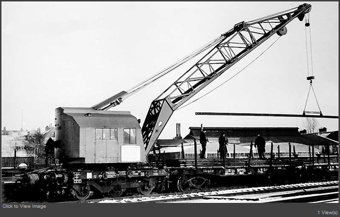

And this image shows a slightly stronger 12t? version working together with an Ardelt 57t crane
https://eisenbahnstiftung.de/images/bildergalerie/67215.jpg

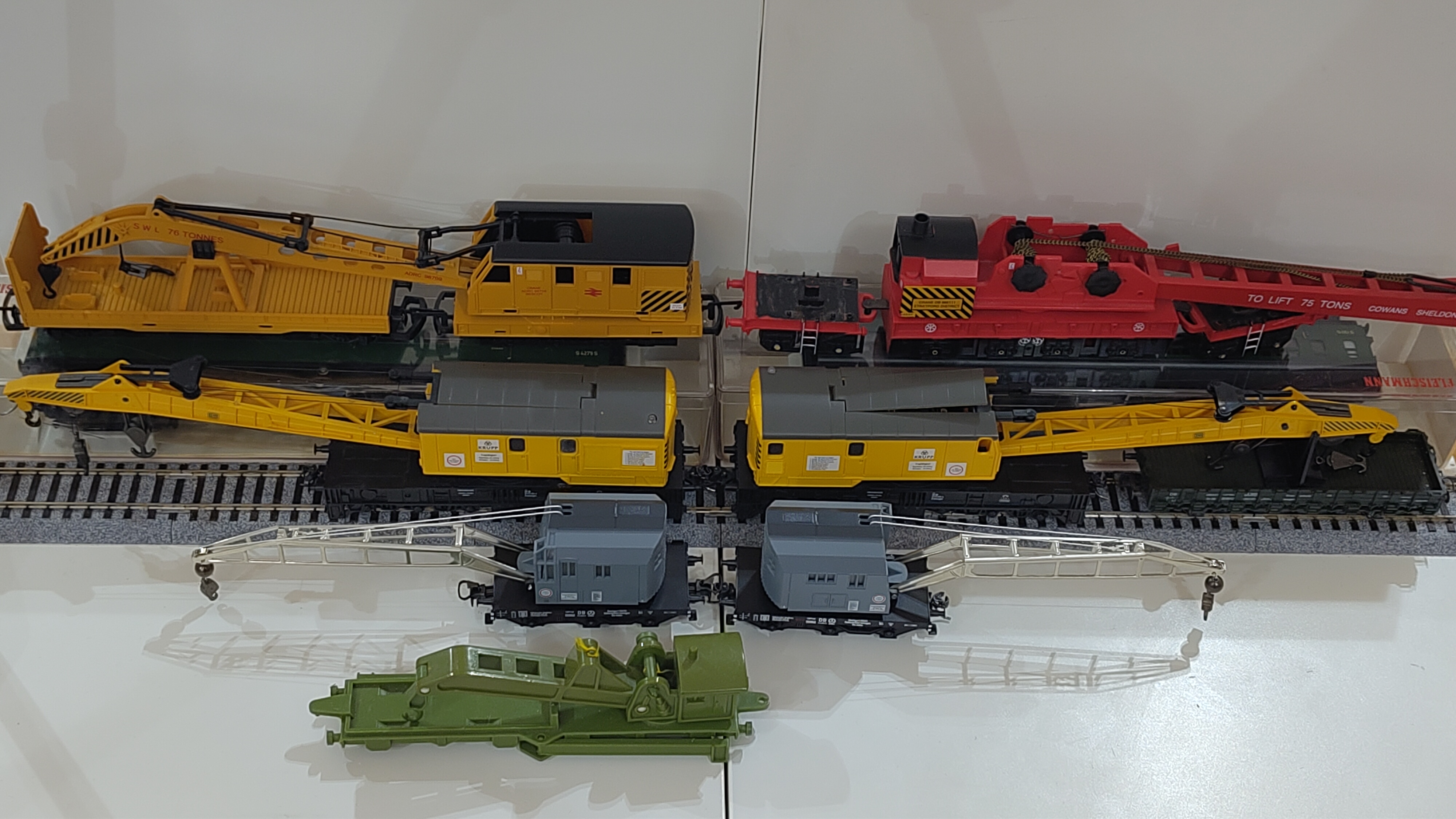

Well my analogue yellow Roco crane should be here by monday, and is headed for a quick death, with all the parts I plan to steal from it for the portalkran and the old digital kranwagen! I was going to cheap out and buy one for £10, but then I saw one for £30 which had a NEM match wagon and figured the cost of the NEM conversion would offset it instantly. Ironically I'm buying it from the same seller I bought the first digital one from. He might get a positive review this time! Last time after seeing the damaged bogie I decided "if you can't say anything nice, say nothing". The seller of the second one certainly has nothing to complain about in that review. By the end of this I plan for the analogue one to have:
One bogie
No buffers
No roof
No cabside rollers
No match wagon
No box

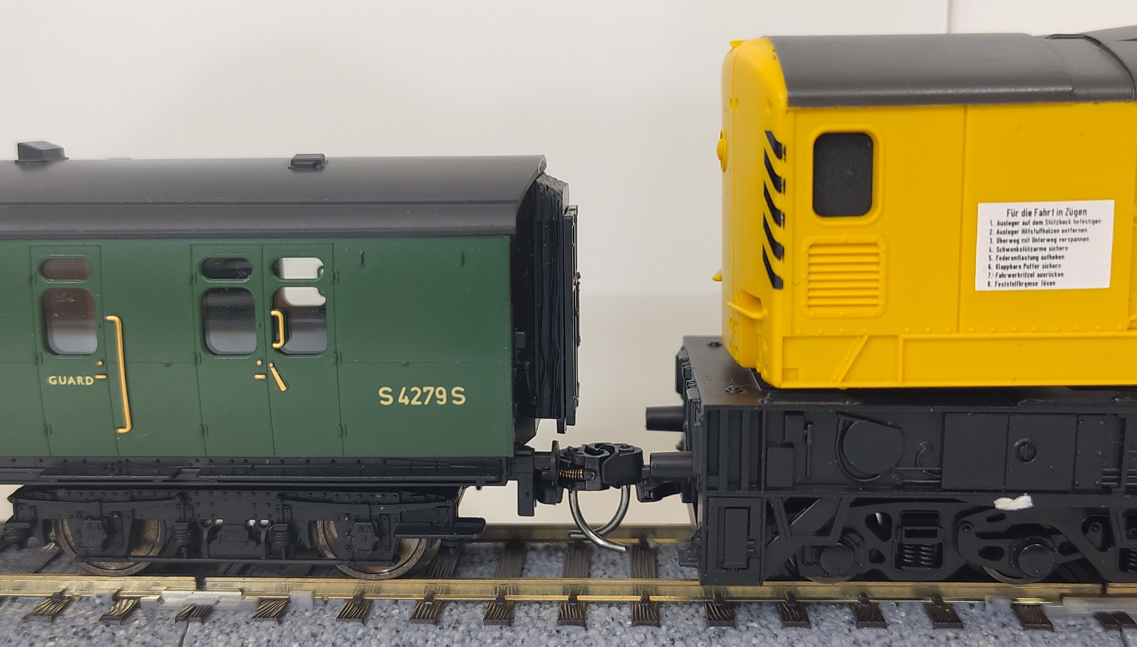

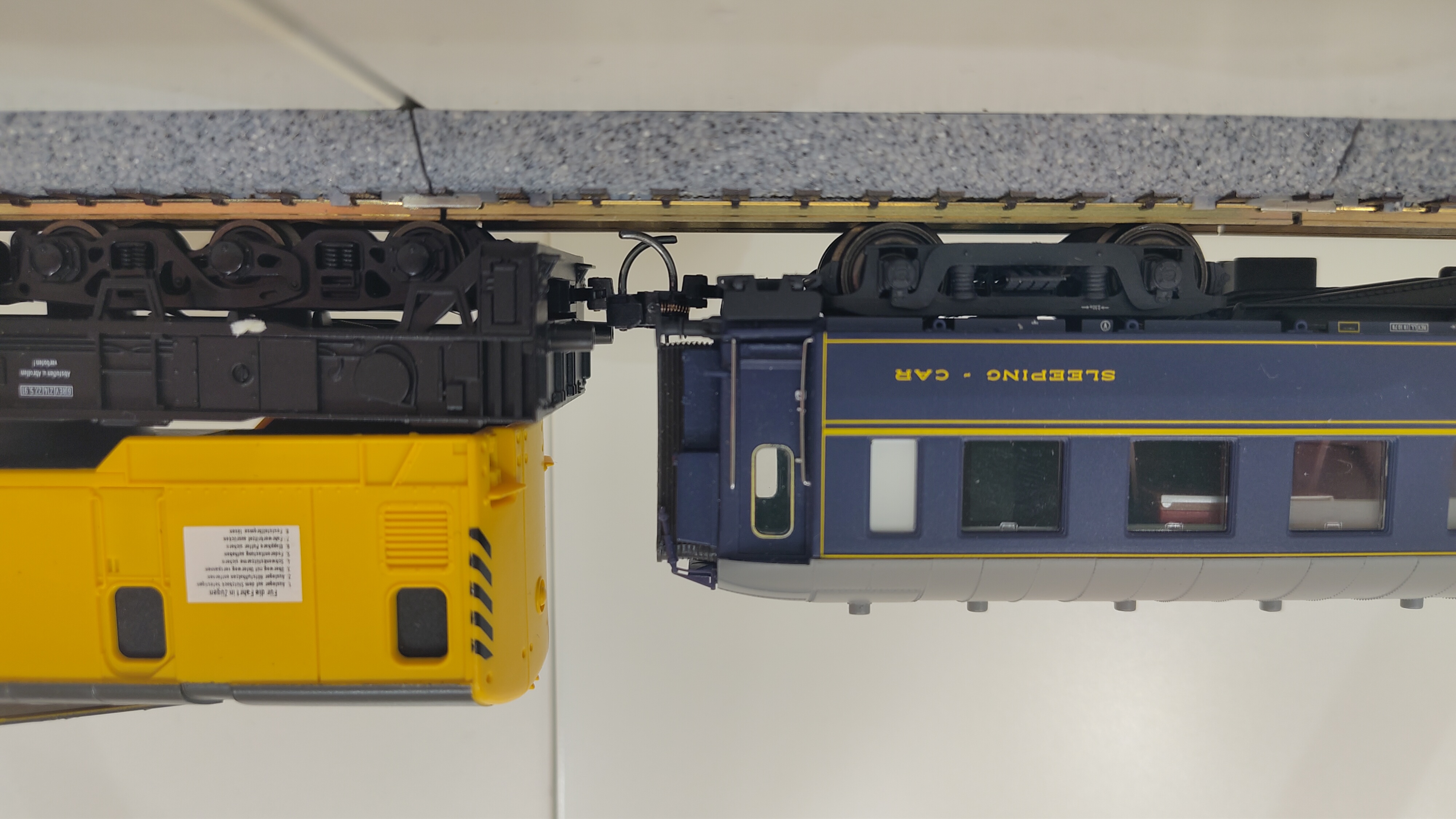

When I first discovered the 46719 I did think about getting a 4671 and going digital+analog, but the fixed metal couplers put paid to that very quickly. NEM or nothing!
I feel like this year's catalog justified my decision to get two - I really like the new livery, but at an extra £60 or so for a wagon that would be way harder to convert to DC; better off buying them solo as I did.

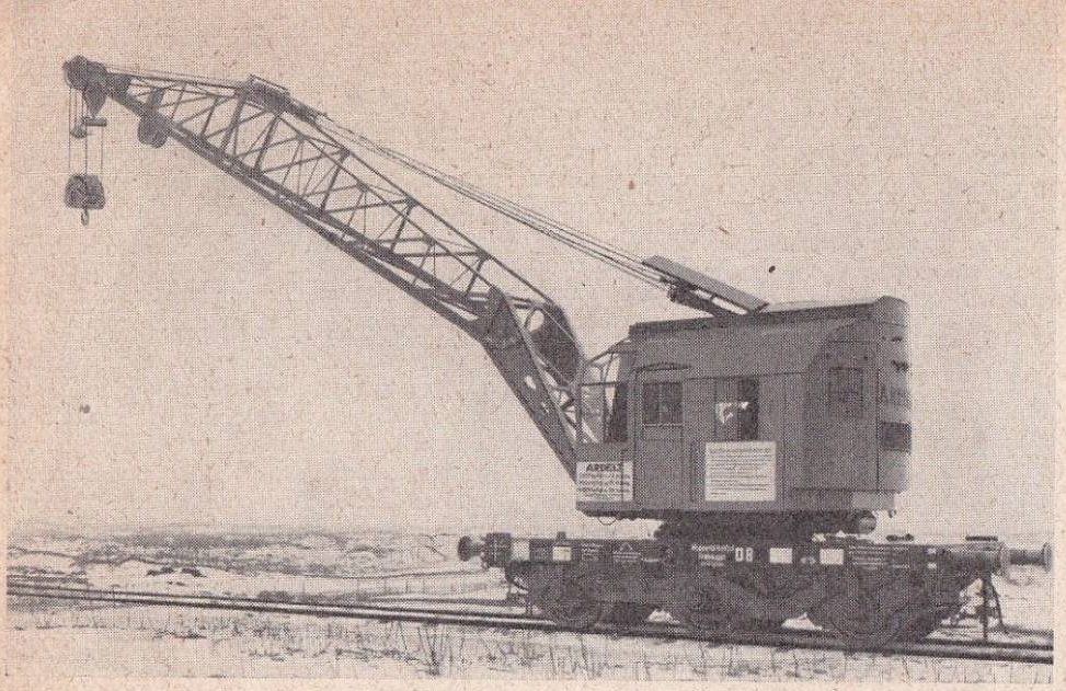

In the immortal words of Keanu Reeves: JESUS CHRIST THAT THING'S REAL!? I thought I'd bought something fictional but pretty! That's so awesome! Thanks for sharing this!
And now I have prototype to mix and match my four cranes freely. Useful!

A Bulleid Coach with a Roco CraneType F coach with a Roco Crane
This model railway is perfectly balanced with no scale issues.
