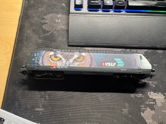

Hello i have the locomotive 37467 and finally i changed my ecos esu for marklin console the simple one.
i installed the 37467 which worked first then i noticed no lights and only go ahead i cant go back or options none... then i did her a reinitialise now nothing works only go ahead...
i unplugged all and delete loco and readded but not owrking
its adress 46... how can i have since i reinisilised it haev the decoder working properly with this loco and it functions..?
i changed 46 to 47 before because i had already a 46 rec460 so then i changed the other loco from 46 to 39 and tried wit this 37467 with adress 46 but NO result i put her working and goes super fast and only the button stop respond..
how to put back properly this locomotive anyone has some tips ty

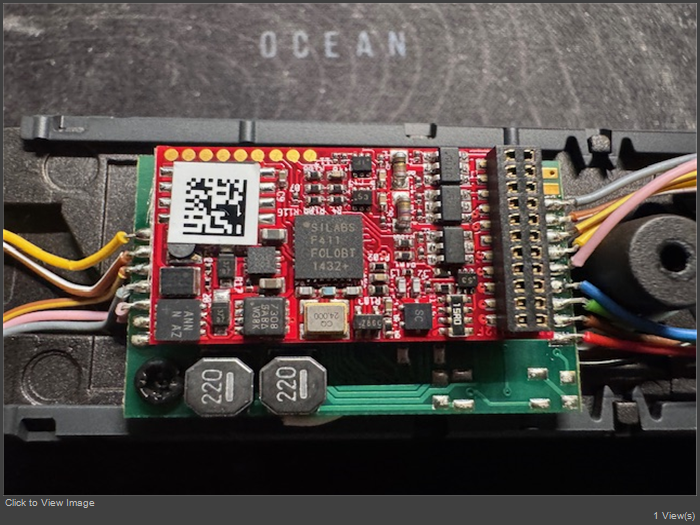

#8 Posted : 16 October 2025 18:42:00(UTC)
Posts: 8,364
Christian,
from the behaviour described, it sounds like an old Maerklin analog locomotive being run on a digital layout. The analog models would not respond to controls and would take off at top speed and the only way to stop them was to press the stop button. Some of the early models (1990s) had lights which only functioned via the decoder (function on/off).
Can you open the locomotive and post a photo of the chassis with the PC board? It would help us identify the nature of the model.
A new 37467 would have a mfx decoder similar to the 37460 or 37464.
Can you also post a photo of your controller or it's box as identifying that would help us better evaluate the issue.
Take a track section made up of 2-3 straight sections and connect to your Mobile Station.
Plug Track box into AC (wall)
Press "Stop"
Place locomotive on track
Press "Stop" again
Allow MS to scan for locomotive (Should check mfx, dcc and then MM) (OEM order)
If locomotive simply starts moving, then it is either analog or the decoder is stuck in analog mode.

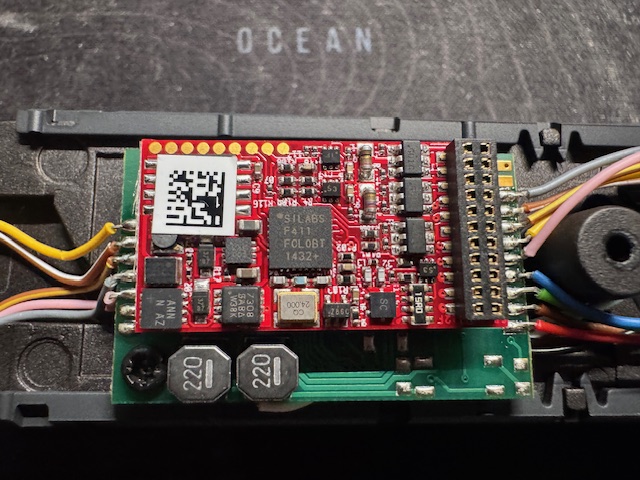

these pictures of the loc an manual
sounds works lights but seems to work half:(
#12 Posted : 16 October 2025 18:53:43(UTC)
Posts: 8,364
A few more questions to gain more information:
1) Do you have an analog (classic) transformer (66471 or earlier)? to test the model in analog? If yes, connect a few track sections and place the locomotive on the track and run it for 5-10 seconds
Put the locomotive back on the digital layout (alone) and let the controller detect it.
2) If no, do you have a 9V battery and can you connect one wire to the slider and the other to one of the wheels
Let the battery power the locomotive for 5-10 seconds and then remove wires from locomotive
Place locomotive back on track and allow the controller to detect it again.
As you just bought the controller, perhaps your dealer could help you. Can you bring the locomotive and your controller to the shop?
The closest Maerklin dealer (specialist) is probably Anton Furger in Visp
Sion has "Au modelisme" and "Hobby Centre".
Please post the photos requested so that I can better address your particular situation rather than generalities.

#14 Posted : 16 October 2025 19:17:36(UTC)
Posts: 8,364
Looking at the photos, the details are pretty similar to the 37462 that I have here. My decoder has a green PC board, but the details are the same.
Based on that information, my assessment is that your model is fully OEM and corresponds to what I would expect from a factory model.
The 29000 Set contained a 60657 controller (Mobile Station 2+).
I am going to ask you to check your MS2 library. Click "Shift" and then scroll using the dial.
See if you have a registry for MM46 or 460 105-0 SBB. If yes, select that one and then click on Shift and then "Wrench" and then scroll down to "Remove Loco"
Then allow the MS2 to detect the locomotive again.

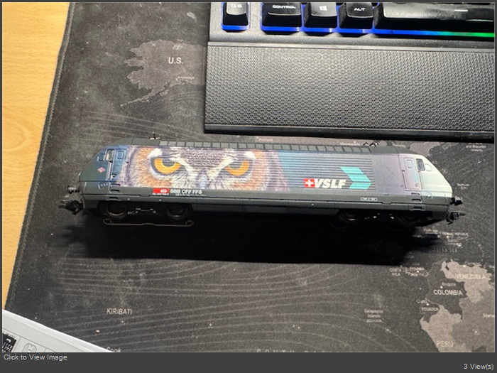

#17 Posted : 16 October 2025 20:14:06(UTC)
Kristaki
Joined: 01/10/2025(UTC)
Posts: 54
Location: Valais, Sierre
image0 (5).jpegi took a picture of the otehr 2 locs i have with this one 37467 i told you i will go now to see to add the one u tell me and rmeove it and try to readd it has u so gently explained me
the other 2 didnt gave any problem i took the numbers u se eon box and aparently worked nice:) now this 37467 is not in the database dont ask me why lol:(
i go test i tell u soon if went good

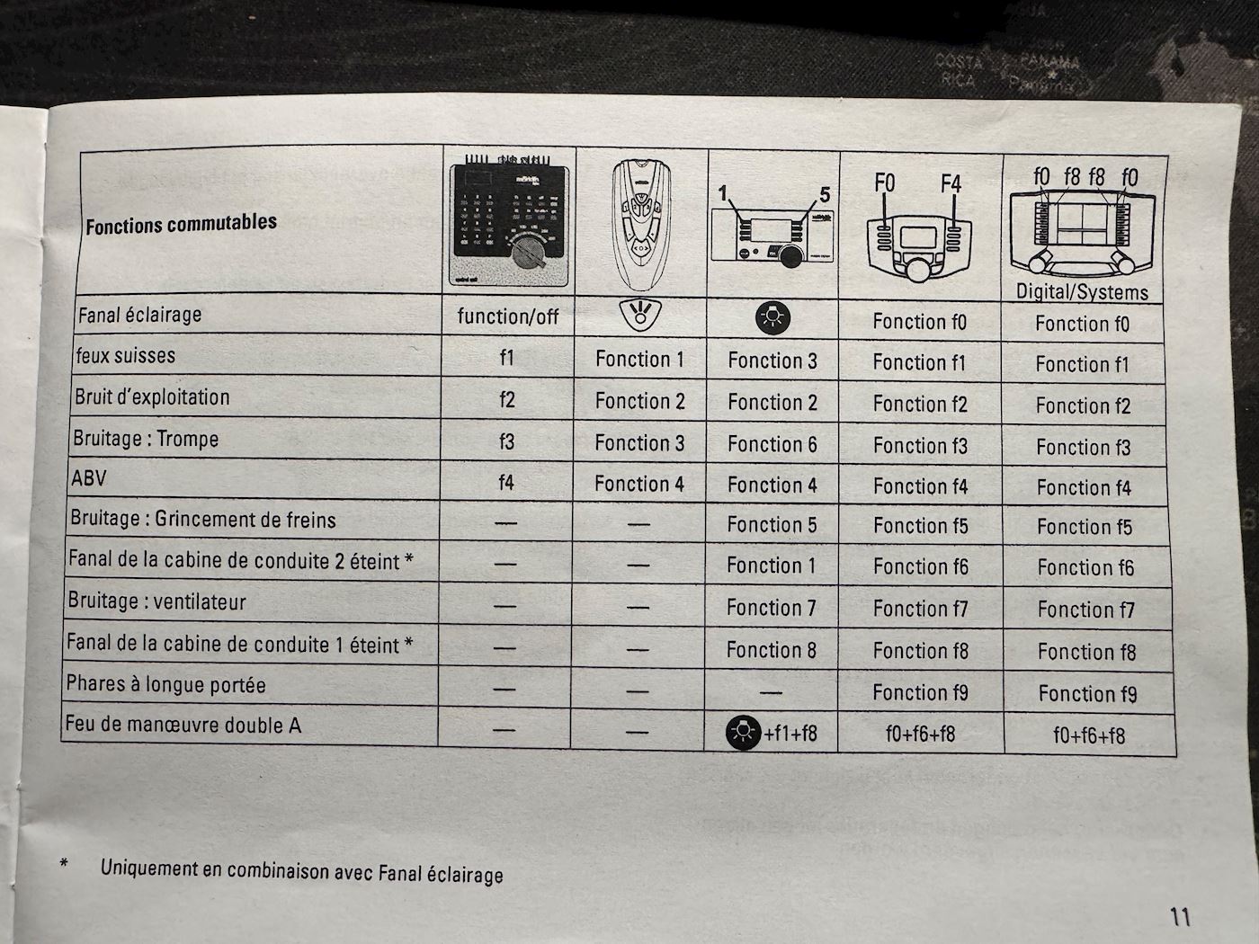

In Post #11, Kristaki posted a photo of the instructions, clearly showing the MM address of 46 and the mfx address for the 37467
MC
#34 Posted : 22 October 2025 08:33:19(UTC)
Posts: 15,578
The mfx address is a number; the mfx address is never shown in the manual because the controller assigns it automatically when the loco registers with the controller.
