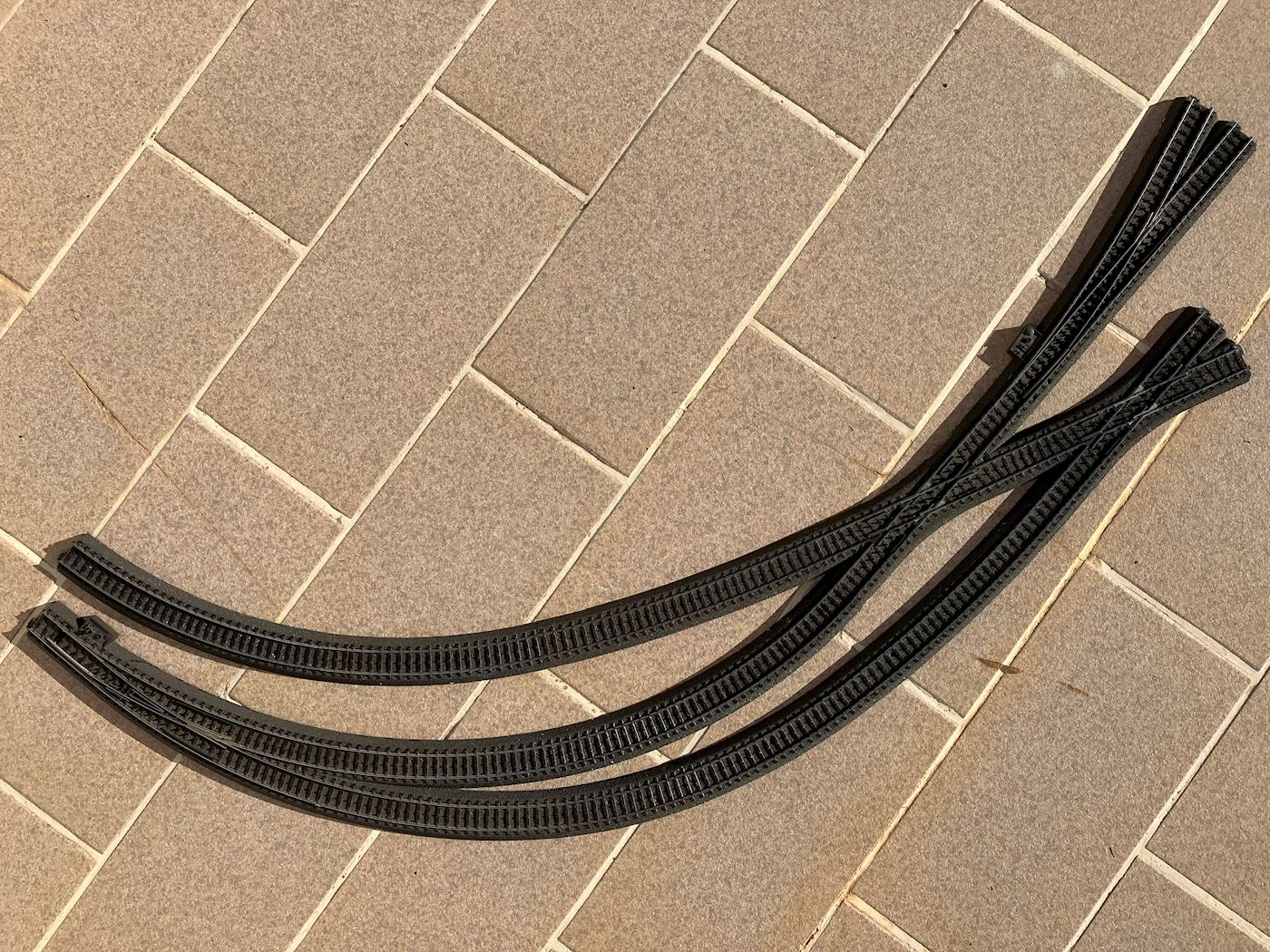

Further to post#8, I tested the plan with real C track sections (24640 served as a substitute for 24620...), and it works.- see photo:
#12 Posted : 27 August 2025 19:44:21(UTC)
Posts: 6,033
I tested the plan in post #8 with real C track sections (24640 served as a substitute for 24620...), and it works.- see photo:
