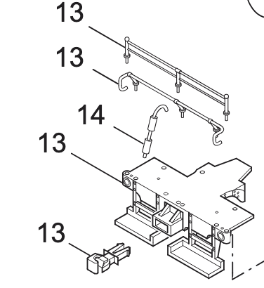

I got the Märklin Mikado New York Central (37970) and was wondering is there a trick for the front NEM pocket? It is positioned too high and I'd like to put a standard short coupler to it. I don't know what standard it conforms to, but it's clearly at a wrong height for normal Märklin operation.

Besides the height issue, would the coupler 7203 fit into the pocket #13 - see snapshot?

Obviously not the same lok, but these are the front coupling options on the Big Boy, a normal short coupler does not seem to be an option.
Even the simple hook has restricted use....

I think Jean-Pierre has the answer. It was probably never meant to be a functional coupler, only decorative. So there was no need to position it at a usable height. The prototype would have seldom used the front coupler anyway.

I just checked my Mikados. The manual only states how to change the rear coupler but never mentions the front coupler.
All my Mikados include only 2 figures and no extra parts. I guess the front coupler is not meant to be used as a coupler on the model just as many here have mentioned.

With the cow catcher on most American steam locomotives, was pushing even a consideration? The part for the 37935 for the front socket is described as a plug-in-part and not a coupling.
A locomotive like the Mikado could have occasionally used the front couper, but definitely not very often. So it was a small consideration but not something that Märklin bothered to model.
Cow catchers on pilot trucks mostly went away in the late 1800's on American railroads, and I'm sure locomotives with them never coupled anything from the front of the engines.

Thanks guys, it does seem like there is no way out of this.
