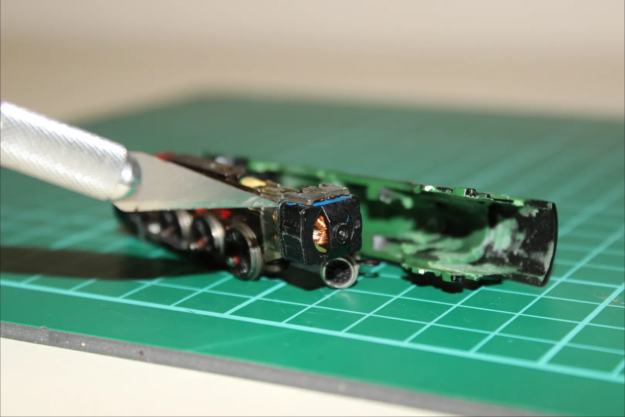

"But there is also the 'Atlas editions' collectable static model advertised quite widely with its accompanying Gresley teak coaches. I've been chopping one of these about recently to motorise it with encouraging results.
In this shot you can see where I have carved the inside of the cab and boiler to make room. I found that the Marklin motor was just a bit fat at the top and was splaying the cab sides out. The guys on trainboard were very helpful and assured ne that you could take a bit of meat off the outside of the motor without affecting the performance. The knife points to the area in question."
