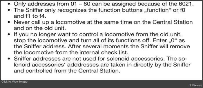

Hi again,
Here is an excerpt from the manual:
Replace the example 6041 with your other CS1.
If you don’t have the manual, you can download it from Märklin: https://www.maerklin.de/...S_60212-update_DE-EN.pdf
Note! The middle picture is continueing text from the last picture!
Hope it works for you, Peder
thanks 2 users liked this useful post by pederbc

Originally Posted by: pederbc Go to Quoted Post
Hi again,
Hi again, I tried it and it worked!! However it only works with fx lovomotives... Completely understandable for the provided early 2000's technology.
Also I should note that I reached out to Marklin and they said that it is not possible to connect two CS1s together...
Thanks again.
Nick

Hi Nick,
I don’t think it’s restricted to fx (motorola protocol). All of your loks has to be defined in the primary CS1 as mfx, dcc or fx, of your choice. In the setup you define the sniffer address regardless of the real address. If it’s an mfx there’s no address anyway. As stated in the manual you can only set addresses between 1 and 80. On the secondary (slave) you create a virtual lok, perhaps with same name as the real one and define it as an fx lok with the same address as the sniffer address defined on the primary CS1. As also stated in the manual you can only use functions F0 to F5 on the secondary CS1.
Peder
