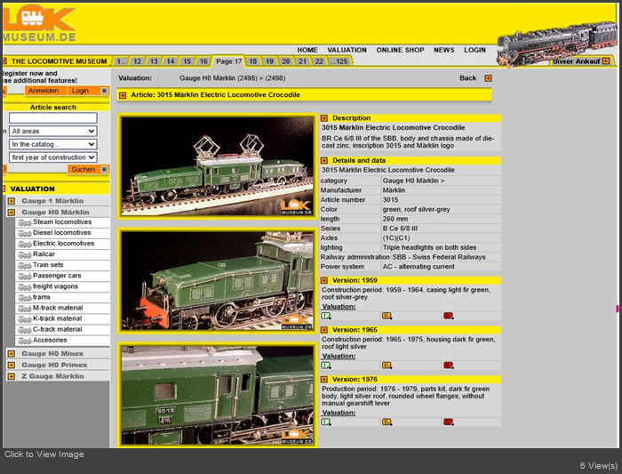

thanks 1 user liked this useful post by Adrian666

Hi Adrian,
Koll's says the inscription "3015" first appeared on the 3015.10 version in "Blue Green" with a silver-grey roof, 1959-1964
Then the .11 in "Fir Green" with a silver roof 1965-1975
And the kit 3915 would build a .11 1976-1978
Based on the images you posted I don't see a blue-ish hue to the color, so it may be a 3015.11 or a 3915 kit.
All 3 versions should have the "Type 6" pantographs with brown or green insulators; the ones in your images look like "Type 13".
I hope this helps.
