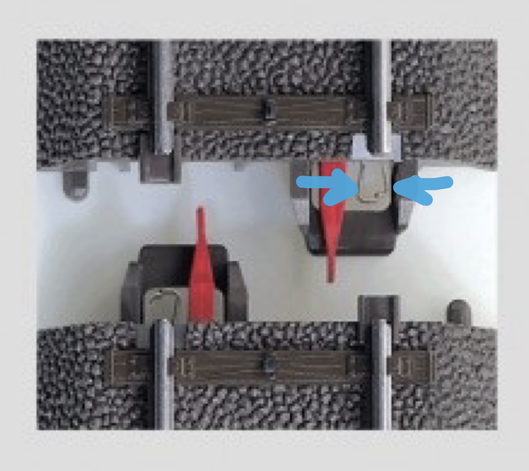

I usually use tweezers to "push" the metal sheets together a little, according to the blue arrows. After this, I find it easy to apply the insulator.

#3 Posted : 03 November 2023 09:47:43(UTC)
Posts: 15,504
I apply the red cup at the corner of the inner lid, then gently push the inner lid to the outside of the track, then push the cup over both lids.
Same effect as PeFu's method, but without a pair of tweezers.
So you squeeze shut the outside connector, but what do you do with the connector where the insulator goes into. I have tried to pry the insulator between the two metal prongs, but it doesn't seem to hold the insulator in place. It is not clear from the picture how the insulator is held in place.
#5 Posted : 09 November 2023 15:29:17(UTC)
Posts: 15,504
You push the insulator over a pair of metal prongs.
To make this easier, you can squeeze them together with a pair of tweezers.
The red insulators can be used for the centre-rail (inside prongs) and for the outer rails (outside prongs).

#6 Posted : 10 November 2023 02:55:11(UTC)
Flupke
Joined: 07/11/2023(UTC)
Posts: 21
Location: Maryland, Baltimore
Thanks, I had not seen that there was a hole in which the metal prongs were supposed to slide in. I got it to go in using tweezers.

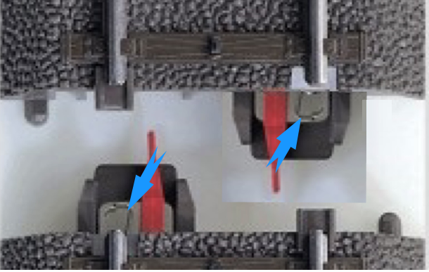

#7 Posted : 10 November 2023 22:13:04(UTC)
Posts: 3,655
Hi Luna
Originally Posted by: Luna Go to Quoted Post
Has anybody come up with a way to put the 74030 insulator on the track rail? I seem to be able to put a couple on no problem and then I run into a piece of track that will not accept the insulator. Is there some trick to consistently get them on? Maybe soften them with hot water? I've already ruined a fair amount of track pieces due to the insulator distorting the rail during application. Can't use pliers either as they ruin the insulator. Thanks in advance for any ideas.
Luna
There is a simple way. No tweezers needed, simply push the insulator sleeve in blue arrow direction without excessive force. Works every time! Do not hesitate to trash damaged sleeves
Note: there may be some tricky tracks where probably force was exerted on the contacts. The result is not both contacts are at the same, "altitude" resulting into difficulties inserting the sleeve. First make sure both contacts face each other before inserting the sleeve

#15 Posted : 25 January 2025 12:47:08(UTC)
Posts: 8,563
See my answer to this post.
Offline Drongo
#16 Posted : 28 January 2025 07:14:38(UTC)
Drongo
Joined: 03/06/2008(UTC)
Posts: 1,264
Location: Sydney, NSW
Hi Luna
Luna
A word of warning - if you squeeze the prongs to assist in installing the red tabs, and then at a later date you remove the red tab, you may find that the prongs are not making contact with the next piece of track and thus there is no electrical continuity - I found this out the hard way.
