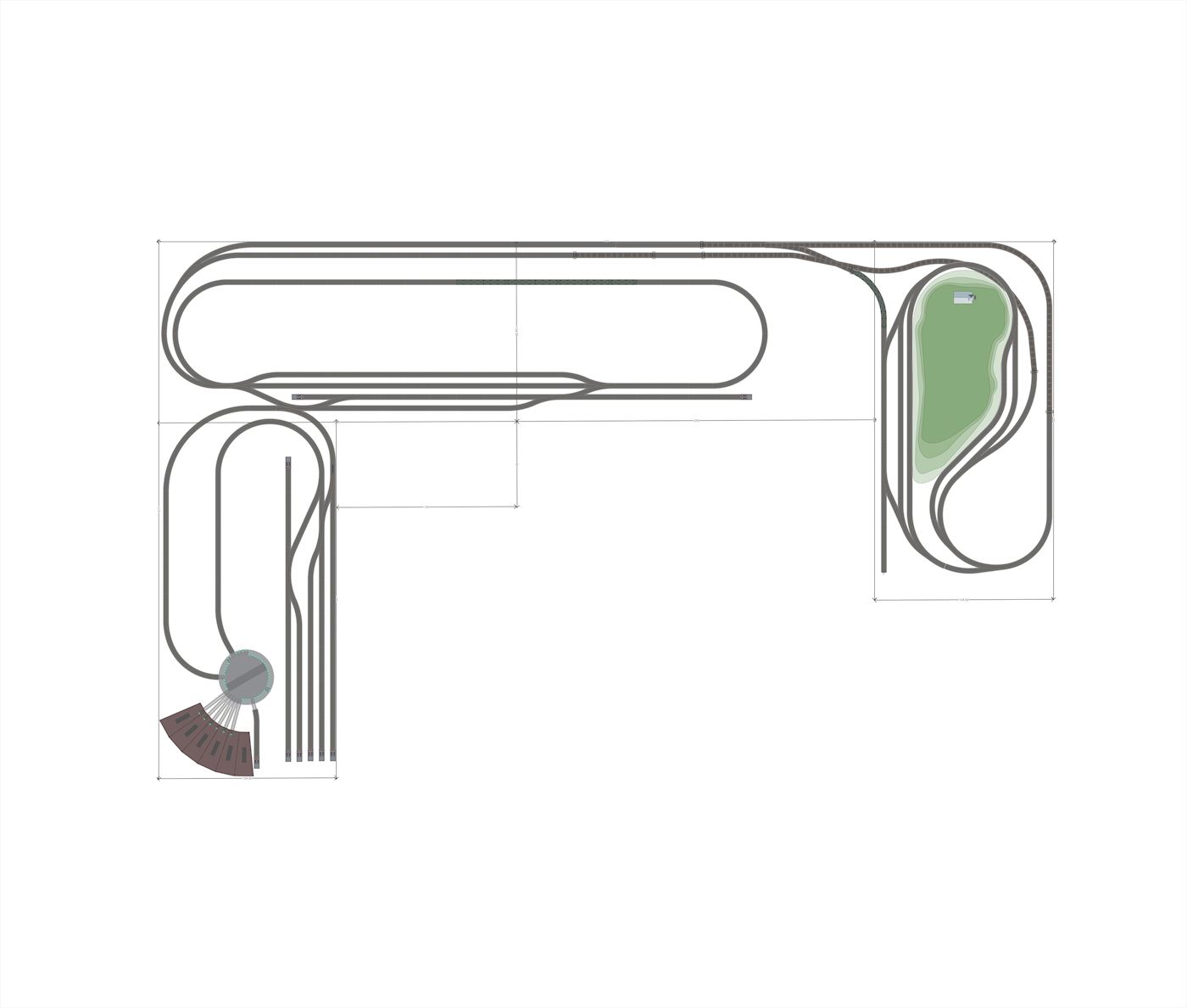

another:
do You think that I need additional power supply for that kind of layout?
[img=http://ibb.co/8NvQ3YV]layout[/img]
thanks 1 user liked this useful post by Heh Igunen

another:
The trackbox that comes with MS2 is enough to power almost any layout. Just make sure to have several feeder wires evenly spaced. Many recommend a feeder every 1 meter, but I think one every two or three is enough.
The question is more of how many locos are you planning on running at the same time and will you have passenger cars that have interior lights?
-Eino
thanks 1 user liked this useful post by einotuominen
#16 Posted : 02 January 2025 11:52:49(UTC)
Posts: 4,170
Yes, unless it's a quite large layout you may need a digital booster and that requires a separate power supply. This is where it gets more expensive, so a CS 3 may be more economical because it has a powerful booster inside.

#19 Posted : 06 January 2025 19:43:04(UTC)
Heh Igunen
Poland
Joined: 16/12/2024(UTC)
Posts: 9
Location: Pomorskie, Gdańsk
New layout in the attachment
