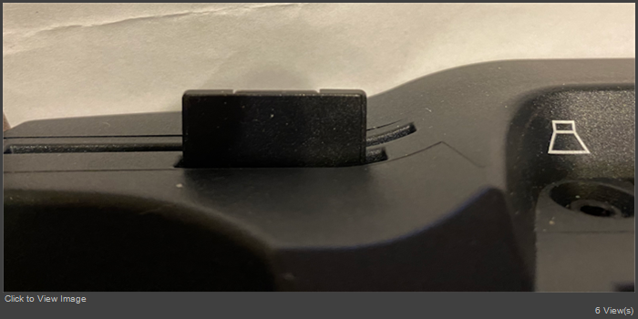

Here is the rear of the CS3 with the SD card and its insert ready to be pushed in

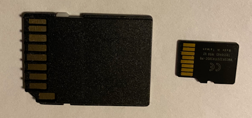

Now is the detail of the insert (Left) and its SD Card (right), in my case a 32 GBytes memory
So you slide the card in its insert (usually provided) and then in the CS3 (a fool-proof insertion)
If you wish to extract the insert, you push again on it and it pops out

A final solution. Thanks for all the help. it turns out that my CS3+ rejects SDHD cards. The problem was not that I had the wrong physical size card. It kept ejecting the card and never allowed it to seat. I finally had the opportunity to bring the same card to a different CS3+ and it seated properly. Strangely enough the second CS3+ would not eject the card and I had to pry if out with a pin. Next step is to insert the card into the club CS3+ to see if it makes a difference. That will happen this weekend. I will bring a pin in case the eject also does not work.
#13 Posted : 02 December 2024 00:59:33(UTC)
Posts: 3,739
trangely enough the second CS3 would not eject the card and I had to pry if out with a pin.Next step is to insert the card into the club CS3 to see if it makes a difference.
you should not pry open the card. You push on it so it gets further inside and then a spring is released and the card pops out. NEVER EVER PRY OPEN.
Same thing to lock the card in place: you should push a little past the flush position with a finger. A spring tries to go against the insertion until you go past the flush position. Then click, the card stays in place.

I did not try to "pry open" the card. In my CS3+ nothing I could do would cause the card to stay in. Even holding it all the way in while turning on the CS3 failed to either secure it or recognize it. In the second CS3 the card did lock in and the CS3 recognized it but when I chose eject nothing happened and the back of the card was flush with the CS3 making grabbing it impossible without moving it out slightly with a pin. This weekend I will get to try the same card in a third CS3+. In fact I just decided to bring two different SDHD cards to see if the problem is the card.

#16 Posted : 02 December 2024 14:18:46(UTC)
Posts: 8,743
Telling the cs3 software to eject the card will not physically eject it, it only closes down all the OS connections to files on the card so they are all properly closed before physically ejecting the card.
As Jean says, having done the software close down you then need to push the card into the slot to release the spring that will then push it out of the slot. You don't need to pry it with a pin or anything.
The cs3 that the card will not physically go into sounds like it has a faulty card slot. It could be worth dismantling the cs3 to see if you can work out what has happened to the card holder.

People, it was the exact same SDHD 32GB card. In my CS3+ it will not stay in and every attempt to get the CS3+ to accept and recognize the card including holding it all the way in while booting up the CS3+ failed in that the CS3+ did not acknowledge the card. In the second CS3+ the card went in, stayed in, was acknowledged by the CS3+ but when trying to remove the card the back of it ended up flush with the CS3+ and needed to be pried out with a pin enough to be accessed. Finally the exact same card was inserted into a laptop where it was recognized and the laptop started using it. When all the way into the slot it still stuck out considerably and was easily accessed for removal. I will, this weekend, try the same card in a third CS3+ to see what happens. The second CS3+ did not appear to use the card in any way but it was in for only a short time. If it stays in and is recognized by the third CS3+ I will leave it in for at least 24 hours to see if it has any effect on the operation.
#18 Posted : 02 December 2024 21:18:40(UTC)
Posts: 8,743
This is the one I'm saying has a faulty SD card connector.
This is where you need to push the card in further and that will release the catch that holds it and allows a spring to push it out to where you can grab it.
This is another style of SD card connector where the makers don't care if the user manages to damage the card. The cs3 has a different style of socket.

Or both CS3+ have defective card slots. The first one has a spring that is extended and does not allow a card to seat. The second one has the opposite problem and the pusher spring does not work while the laptop avoids the problem by leaving enough of the card outside the socket so that no spring is needed. We will see what the next CS3+ does with the card.
