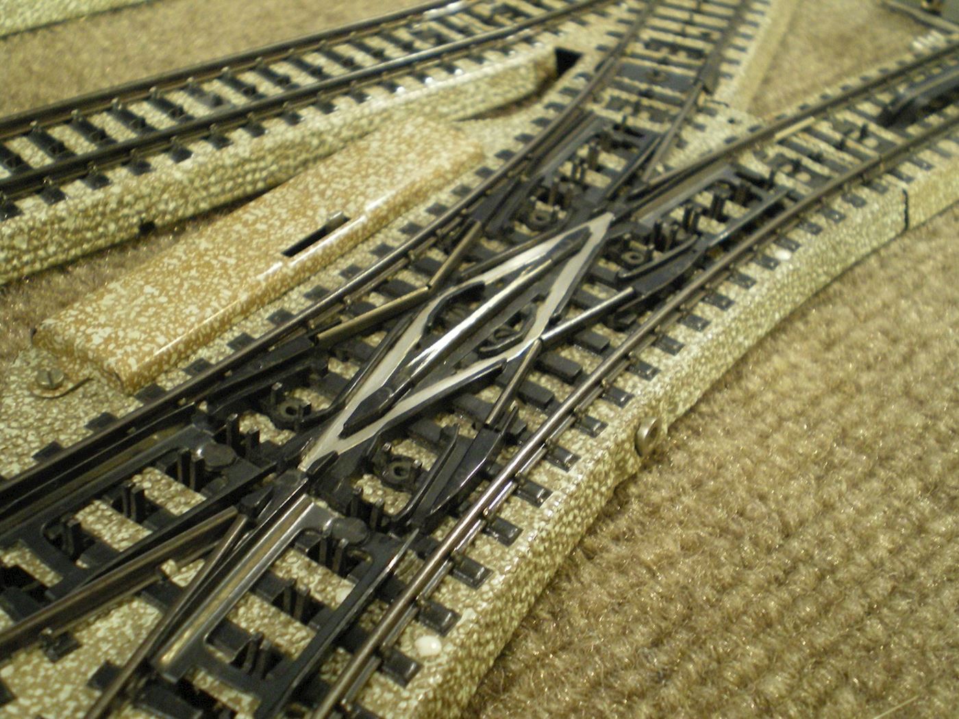

The new 38440 UP GE ES44AC has smaller diameter AC wheel flanges compared to the AC flanges made previously before approx 2010. Marklin is trying to make them closer to the DC wheel flanges (smaller diameter) that run well on the C-tracks. They discontinued the metal M tracks. The 38440 stops on my metal M track double slip switches 5207 and 5128 because the wheel flanges are smaller in diameter and the edges are not able to make contact with the power conducting metal contacts at the bottom next to the plastic track in the switches. So the edge of the wheel flange does not touch/contact the base metal shiny (chrome colored) plate. I thought the locomotive was long enough to have other wheels touching the rails to make electrical ground contact, but that does not seem to be the case. Probably poor power contact from the other axles to the chassis for ground contact. I have adjusted the shoe but that does not appear to be the problem for power contact.
Any one have any solutions? Thanks. Half my layout is K track also, so I can only run this lok on the K track sections. C track was commercialized after my layout was laid, so I do not have C track on my layout.

Your post prompted me to look at my DSS. There are older versions where the ground rail in the center is metal not plastic. When I built my layout I only used the metal type to prevent stalling of short 6 wheel switcher loks. Although this may not be your problem, I hope it can shed some light on the issue.
thanks 10 users liked this useful post by analogmike

Thanks analogmike. I did not realize there was an earlier version of the 5207 where the rail at the center of the double slip switch is metal. Yours matches the one shown in the Marklin 1961/62 catalog that I have. Mine matches those in the catalog 1997/98 where the 5207 is all black and all plastic in the center. So basically no rail current (ground) contact to the wheels. I will just have to run the lok on my K track.
