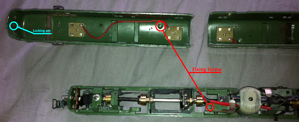

Hi Stefano
To remove the body, you have only one large screw to remove (located underneath near the rear of the loco
Here is a picture of my DL800 with same structure
I hope this helps
