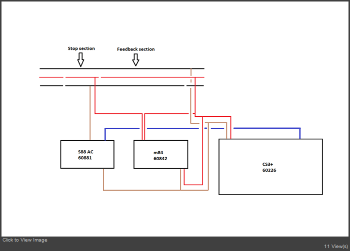

I am in the process of building my first fully digital layout, and I have run into some question regarding my shadow staging yard. I am running Märklin C track and using a CS3+ as controller
I would like some stop sections to make sure the trains doesn't leave without permission, and feedback sections to detect if the tracks are occupied.
The image link is how I plan to do it, but my question goes to if there is a better or cheaper way to make this happen? I have 7 tracks so I would need two m84 decoders and those aren't free...
Can the CS3 do some fancy programming to do this instead prehaps? Are how about brake sections, is a decoder required or can the CS3 do some magic here also?
thanks 1 user liked this useful post by rytter

Yes, your drawing is perfect
For automatic operation your need feed-back sensors
Using C track, they are done easily by cutting the small bridge at each extremity of each rail and install, at each extremity, on the proper side a red Märklin insulator 074030.
Because you have a CS3+, the easiest is to use the occupancy technique so roughly one train length for the occupancy detection zone on both the stop section and thefew rails before it.
On the CS3+ you may define events to send incoming trains to a free "block" (the zone before and including the stop section)
Another event associated with the exit signal and block will make that, when one train leaves this block, one of the staging yard trains is started and its block made free.
Sounds complicated but it is not.
Simply because, you may create an event using the provided recorder (you turn the recorder on, you issue all needed commands (switches, signal). When finished stop the recording, exit the edit mode and test it.
This is fun.
Here is a tutorial on automation
Best of luck to you
PS I love automation. Here is my layout
https://www.youtube.com/watch?v=F6WnhXPcRqI

Doesn't this essentially do what a signal stop section does? Why would you need an M84 in addition to a digital signal, when a CS3 can recieve feedback and an event can control it?
Does it replicate what a braking module does, and make the block longer?

@marklinist - If using digital signals a m84 is not needed for block control, but as the m84 costs the same as a single digital márklin signal, I am going with the cheap option ;) And using hobby series signals on the visible stretches. The m84 can be used to control light and motor functions, etc. from the CS3
