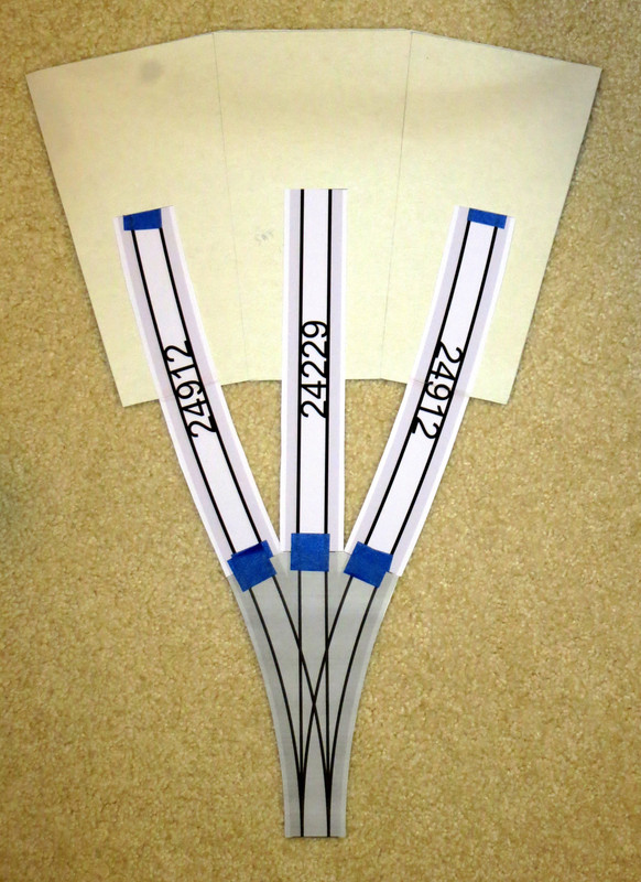

I'm thinking if adding a Kibri 39452 three bay roundhouse but without using a turntable for space reasons. I know it's probably not prototypical but I think I can use a C-track three way turnout to drive the loco's straight into the roundhouse. I've mocked up a what I'm thinking about with cardboard and some "paper" C track. Is there any reason I should not do this? Will there be any problems that I'm not seeing?
Any comments or ideas will be greatly appreciated!

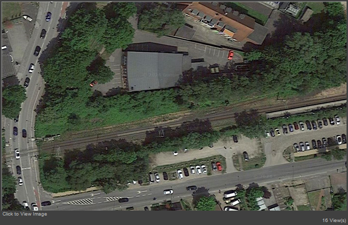

Some standard gauge examples:
Leipzig-Leutzsch - roundhouse with two stalls, now abandoned, neither turnout nor turntable traces visible (switch to satellite modus):
https://www.google.de/ma...12%C2%B018'40.6%22E/@51.3558273,12.3117815,83m/data=!3m1!1e3!4m5!3m4!1s0x0:0x0!8m2!3d51.3557639!4d12.3112889
Zinnowitz - roundhouse with two stalls without turntable, still in use (switch to satellite modus):
https://www.google.de/ma...7454+Zinnowitz,+Germany/@54.0767037,13.8989639,532m/data=!3m2!1e3!4b1!4m5!3m4!1s0x47ab02237d9b2d03:0x5d984b20e25755f6!8m2!3d54.0767037!4d13.9011526
Greifswald: Already in the 1960s, the roundhouse was reduced to three stalls, and the turntable was removed. Two stalls kept connected to the central station via turnouts (the third stall entrance was bricked up). Last structures torn down at the beginning of the second millennium.

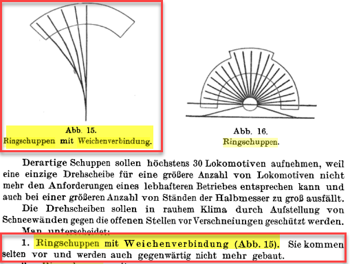

What does the German 1908 "Handbuch des Eisenbahnwesens" [= Railway Hancbook], pg. 152 f. state?
"1. Locomotive roundhouse with turnout connection (figure 15). They are rare and are no longer being built at present."
Source:
https://books.google.pt/...enverbindung&f=false

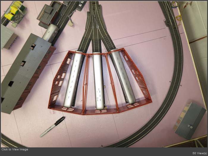

According to a Google check the angle is supposed to be 15 degrees. You have only about 12.
On my first layout I had the Marklin version of the roundhouse (also 15 degrees). After the 24630 I used a 24x15 followed by a 24206. You need to get the angle and distance correct to get thru the doors. To get the correct distance I can't remember if I used 24115 or 24215. Anyway, strange S-curves.
Added: If the floor of your roundhouse is flat (Marklin's is not) the angel is max 15 degrees. Less is OK.

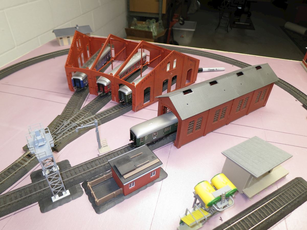

#17 Posted : 12 July 2019 01:20:25(UTC)
LA2019
Joined: 18/11/2012(UTC)
Posts: 362
I picked up a three-way switch and did a mock up with the roundhouse and all seems to be working fine. There is a slight curve to the track in the roundhouse but I'm OK with the way it looks. I did not have power to the tracks so I ran some passenger cars into the roundhouse with no problems. So far, so good.....
Ken

Originally Posted by: LA2019 Go to Quoted Post
Ken, could you post the track pieces with which you achieved this? I have a three way turnout and intend to do this as well
thanks 1 user liked this useful post by madhu.gn.71

According to post no. 1 Ken foresaw 24912 curves. And on the most recent photos it looks like he really employed them on the outer tracks.
Ak, since I don't have 24912, are there any other track combinations, which you can think of would let me achieve the same?

A German Maerklinista and owner of a Kibri “Ottbergen” three-stall roundhouse reported in a German forum that he uses the C track three way turnout and two 24206 C track pieces, one on each of the two outer tracks (and adjacent to the curved turnout “stubs”), respectively, to attain the correct angle(s).
Source: https://www.h0-modellbah...t-Weichen-befahrbar.html
Madhu, the outer tracks are 24912 + 24094 while the inner is 24188 + 24172. The three final tracks inside the roundhouse were trimmed to size with my Dremel tool.

Prototype example: I just found a three-bay roundhouse next to the "Lübeck Travemünde Hafen" train station.
It even has a street address due to a car tyre shop residing there: Mühlenberg 2a, 23570 Lübeck
Google Maps view:
