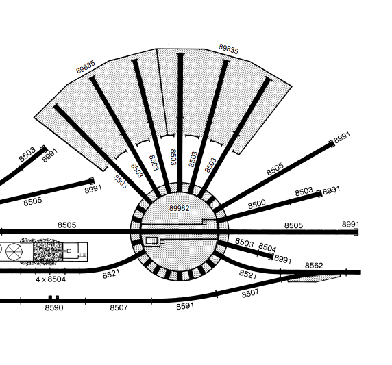

Hello, newby here, sorry for the silly question.
Got the turntable for 6 but no tracks included, can anyone please let me know which tracks I should buy to fit inside the roundhouse 89835 (still on its way to me)?
I'll be on Rokuhan tracks, I know I need adapters, only 2 (two) as the 6 tracks for the roundhouse will be Märklin.
Thank you so much!
Filipe
Offline Mman
#7 Posted : 04 March 2022 15:57:57(UTC)
Mman
Joined: 23/05/2021(UTC)
Posts: 252
Location: England, Guildford
Two 8500’s per roundhouse stall. Or, I suppose, one 8505 per stall as at 220mm it is twice as long as an 8500.

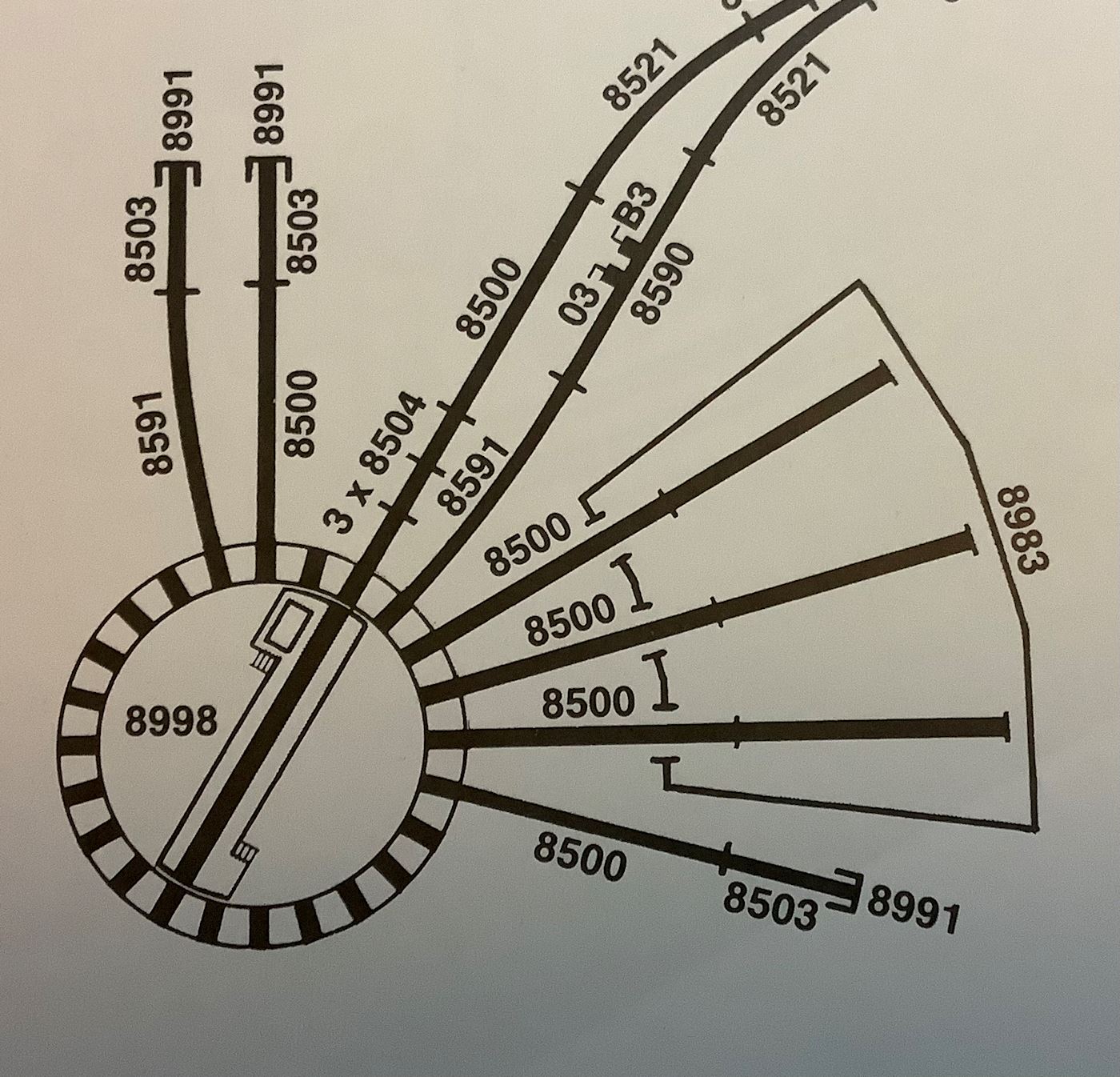

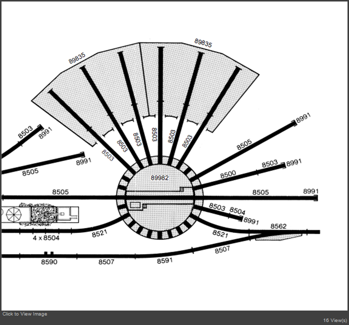

Careful with Chris' (Mman) image ... that's showing the OLD roundhouse 8983 3-stall which has different entry dimensions vs the latest 89835 6-stall cardboard roundhouse kit. The old roundhouse sits BACK away from the turntable while the newer one sits really close to the turntable.
Latest 89983 turntable instructions:
https://static.maerklin....3ff69bc6c41638795581.pdf
Snip of instructions showing the latest instructions where you add 8503s instead of 8500s in-between the turntable and the roundhouse. After that - you use 8500s inside as shown in Chris' (Mman) attachment
