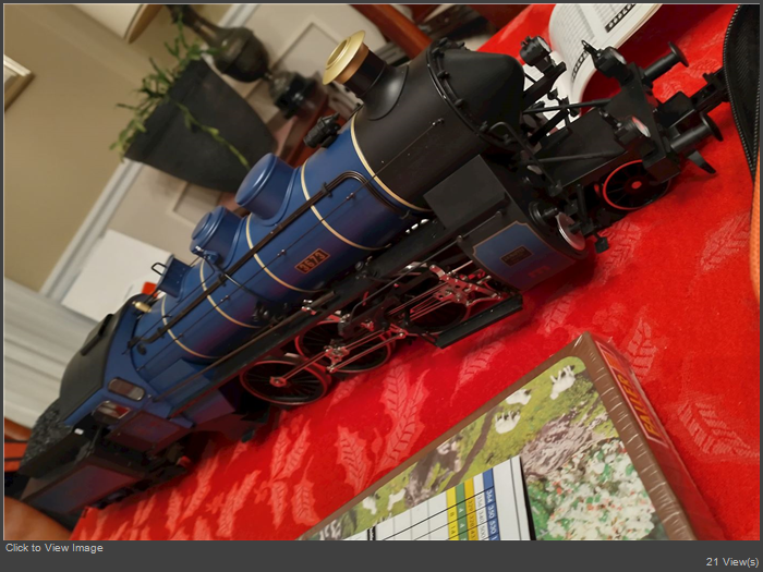

Hey everyone! My dad just got a 1 gauge Marklin 54562. We are both new to 1 gauge and don't even have any track yet. Is there a way to test the locomotive using an AC transformer and placing the wires on the wheels? I've set the switches according to the manual for AC operation. Dip switch 9 and 10 (0) are set to off and the larger switch is set to AC (forward position). Where do you need to touch the transformer wires to test the motor?1642119585798944644430895146205.jpg

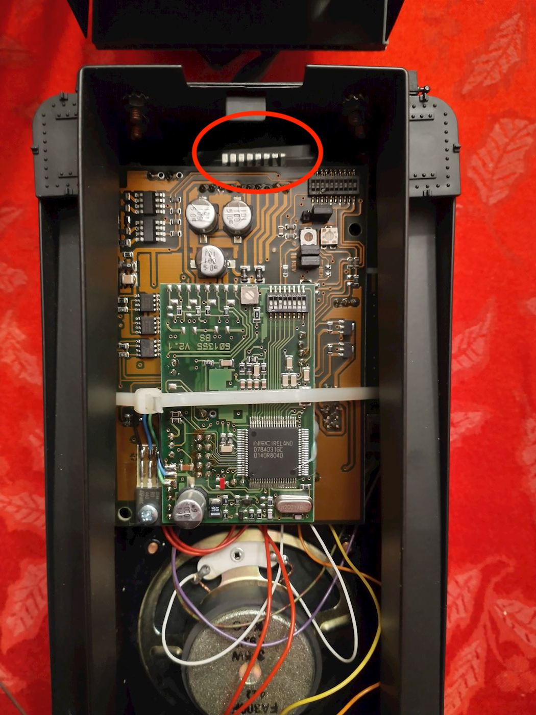

Regarding the tender, it appears to be plugged in, but we may need to figure out how to take the body off or take the tender apart to check. There does not appear to be any access to the connectors without taking things apart.
The loco is also not new and I'm unsure of the previous owner's experience with it. We could try reaching out for help. I've attached a few pics of inside the tender. Are there any tricks to opening these up further to check electrical connections? When applying power to the wheels, not even the lights illuminate. IMG_20220113_220240220_HDR.jpgIMG_20220113_222707736_HDR.jpgIMG_20220113_222815169.jpg

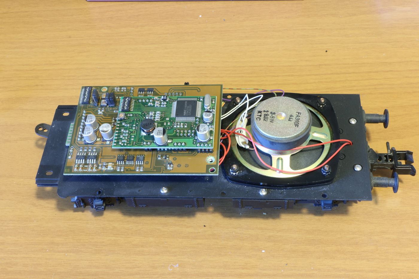

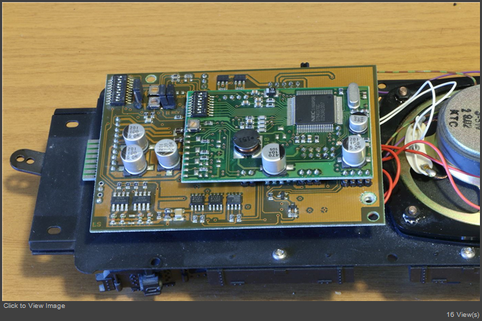

Below you will see my conversion of the same loco with an ESU Loksound 5 XL decoder
The tender after removing the case. (is a bit complicated but with patient is OK)
First is the decoder PCB
Next is another PCB with the support electronics remove it as well
And the base PCB. There is no need to remove it. There is a connector with the loco which can go on both connectors on the PCB, they are exactly the same. The one looking to the loco is most convenient.
There are Hall sensors in the loco. You don't need them. Just not connect the three cables for the HALL
With a multimeter you have to find the connections. The Märklin color code is used. So you need to find the U+ (orange), Front light (gray), Rear light (yellow) AUX1 Smoke (Br/red) and green + blue motor.
The resistors for the LED's are already installed on the PCB
The ESU base plate for the decoder (ESU 51971) is fitted in place and all the soldering work is done
You need some spacers and screws to fix the base plate over the old one
The ESU 58515 LocSound 5 XL decoder
The decoder in place
Programming with the ESU LokProgrammer
The result is fantastic.
The cost of the decoder + Base plate is 230€
The new decoder with the beautiful sounds (you can check them on the ESU website) and the excellent driving characteristics give a new dimension and life to this beautiful loco.
If you need any more help don't hesitate to ask.
Best Regards
Costas

Late to the party here, and not familiar with this particular loco but looks to me like connector between the loco and tender came unplugged.

Will check this tonight! Costas shows another connector on the PCB off to the side so it may be plugged in at the secondary location but will verify. Thanks for the suggestion!

Yes this is the connector where the plug is original. I mention that and after the conversion you have to use this connector. The other is far away and the cable is sort
