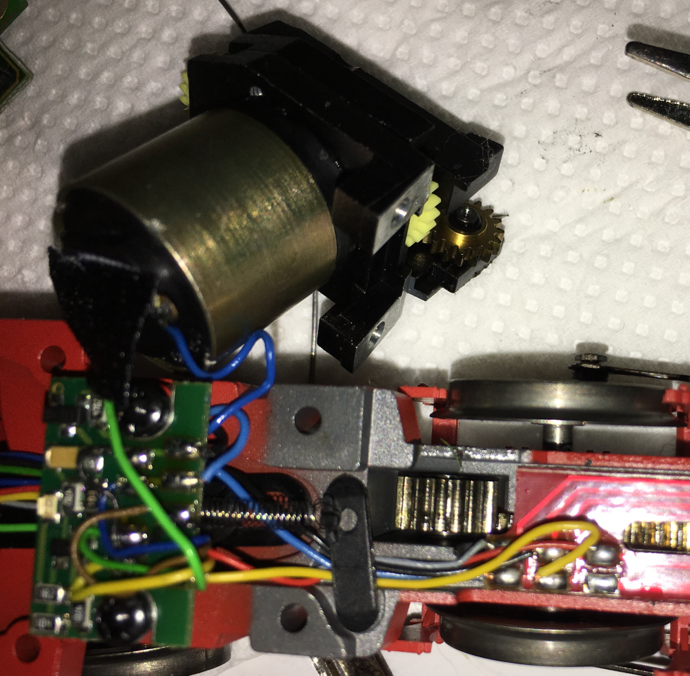

In the latest locos, Märklin uses CAN motors (long closed maintenance-free motors)
Here is an example on the BR95 ref 39095
It is fair to say they are not bad and probably not expensive (Märklin prices them at 25€). Regular bearings.
In the previous years (2004 to 2014) Märklin used Sinus and C Sine , SDS motors. They were much better (ball bearings, no brush) but they are not repairable anymore.
Another type used in the past years is the ironless rotor. First used on the Wurttemburgische C type (3611), here on the bR45 (37450)
37450 motor.png (1,462kb) downloaded 109 time(s).
Before this there were "coffee grinders". The ubiquitous Märklin motor (large, noisy and solid)

As mentioned in my post above, I ordered spare motors for my locomotives. Marklin posted within 24 hours but parcel delivery from Germany to Australia is very slow at the moment! The motors have now arrived, and interestingly for all of the larger steam engines, the motors were essentially identical, as are the gearboxes. The difference appears to be the size of the gear cog which meshes with the driving chain. The gearboxes are easily removable from the motor and the cogs are metal. Unfortunately, I cannot comment on any other models aside from the ones I have but at least for these, my conclusion is that one replacement motor would suffice, provided the gears were not worn. I now have a few spare motors!!
I have posted a picture of all the motors with a copied picture of the locomotive that they belong to. I hope this is of help to somebody.

Thanks for the picture. it's quite useful. ThumpUp
it would be interesting to know the meaning of the HH + 4digit number? could it be the gearbox number?
One the identical motors, some of the flywheels look a bit different? is that correct?
you are probably correct, in assuming that most of the motors are identical, and can be swapped.
but sometimes there are also some differences in flywheel arrangement.
eg in this one with a double flywheel arrangement: (at 5:23)
