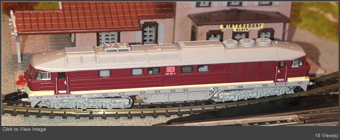

Märklin released a defective 88136 model. It looks like metall impregnated plastic has played a bad joke. Although the weight and traction power have increased, the body of the locomotive has a very bad quality. The model itself has a lot of plastic debree scattered all over body, gears, cab. It looks as if the plastic has begun to destoy from the factory. The paint quality of the locomotive is very low and I am surprised that the model has passed quality assurance control. This is the worst Z scale model ever offfered by Märklin. As an owner of 88131 - I am shocked, because 88136 was a flawless model - the paint quality is supreme. At first I thought that the problems are related to the paint but after closer examination of the paint, I saw that the body is destoyed small pieces of plastic have left the body at the factory. This is how it looks like in reality. The model is just from the factory - there is no dust on it - these are plastic debree scattered all over it. Märklin offers to send the locomotive back to their factory to the repairment department - but I don't see the way how the repairment can fix factory defects, I also paid the import tax and a shipping fee.

Hello, hope you are well, and welcome to the site.
I can see what your comment is about. The shell has small flecks of material stuck to it and in the upper photo, the lines are not strong and consistent. Am I correct, there seems to be a slight color change from one end to the other. I know how disappointing this must be. These defects don’t just rub away but are imbedded into the material.
It would seem, even if this may not impact performance or operation, it is something which Marklin should be made aware of. I know there is no way to avoid postal and import fees, but there may be no alternative. I have never used their warranty service, but have hear only good things about them. It is likely, yours is not the only instance of these flaws. It could be an entire batch is impacted. I would notify them and see what happens. These are expensive models and should be covered by warranty from any defects. I have never held one of these in my hand, so don’t know what quality standard it should meet.

#3 Posted : 12 November 2021 21:50:45(UTC)
Posts: 8,718
I think the colour difference is just the way different lighting can change colours. But I was appalled at the top edge of the windows (both ends) where the body has chipped on the edge, to a point where you can see the outside of the window frame that is printed on the glazing. That definitely shouldn't be like that, and the only fix is a return to marklin for a new body.
But you should be OK returning it, do some research with your local customs department to make sure you fill out the customs declaration correctly and that the item is being returned for "warranty repair". Marklin should then do the same when it is returned to you so you don't get doubled charged tax.
#4 Posted : 13 November 2021 13:55:22(UTC)
Posts: 4,162
It's not so much the colors, the die molding job looks sad.

My 88136 Ludmilla arrived today weighing 53.64 grams, some tiny imperfections only apparent in close up photographs.
Runs nicely and negotiates 145mm radius curves at speed. Actually runs better in one direction than the other which is not unusual in these Z locos.
I haven’t tried a haulage test yet.

Apparently, the mold/injection process is hit or miss and not a widespread issue. Yours appears much improved but it is by no means perfect. I see some edges which lack crispness, at lease the small flecks are largely missing. The windows are/seem correctly placed. Will you accept this or notify Marklin?
Otherwise must be impressive to handle.

Thanks for posting fotos, indeed, although your model looks better than mine, there are still molding defects which is a shame

all units I received - I don't see any such window or casting defects. Here's a small sample of what I received ... 1211212042.jpg1211212038.jpg

Wonderful! (Apart from the buffer turned thro 90 deg, is it loose?)

A bit of "orange peel" texture on those locomotives. The sort of texture I get out of 150ml touch up spray cans. Maybe they need to look at their painting process.

I received mine and I must say, I am very satisfied. When I pick this one up, I liken it to picking up a well optioned Swiss Army knife. Of course not the large ones, but not the small ones either. It is that heavy. In the box and in your hand, it is almost hard to realize this is a z scale, it is that large.
I have not seen the flaky plastic mentioned, I think the model is precise and well detailed. Some gear noise is apparent, but I expect it will quiet down in time. Otherwise smooth and strong.
I have found it to be a good puller too. Easily 10, 4 axle wagons, no issue. Around half of these have loads. Great model. I like it a lot.
