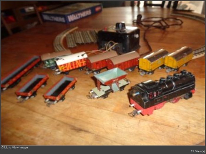

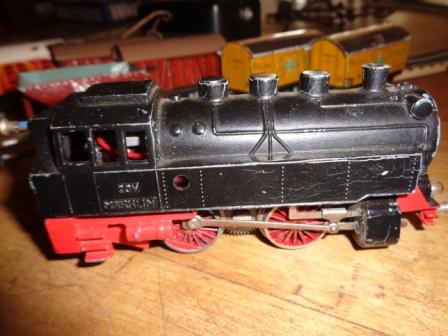

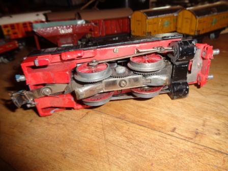

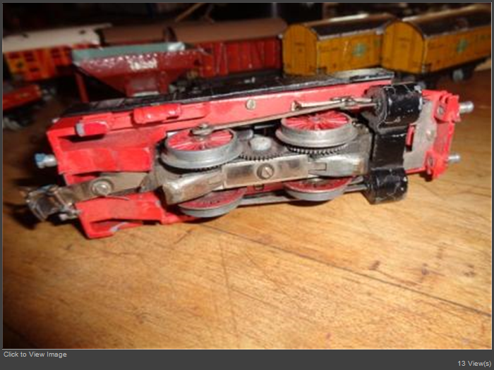

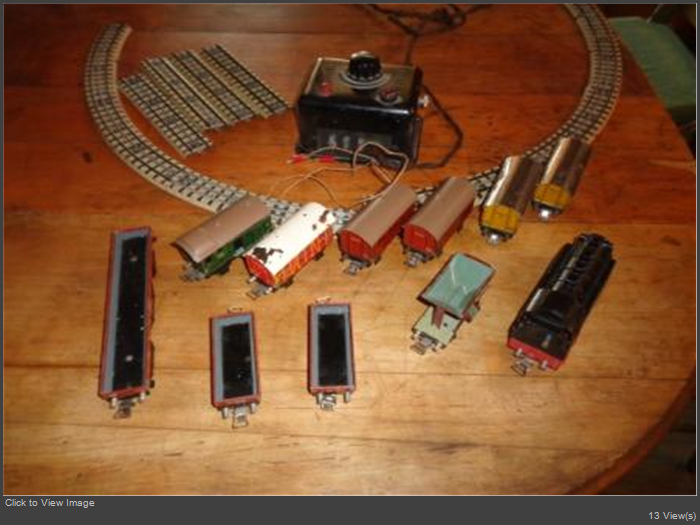

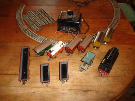

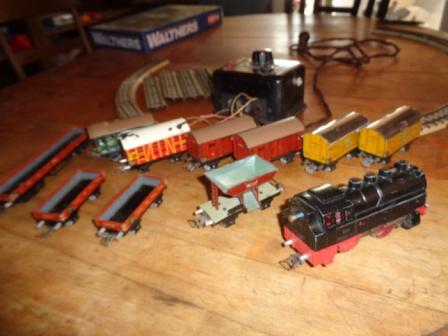

Hi everyone or anyone. I collect a wide variety of model trains, particularly pre-war and I am looking for some info on my latest acquisition. From the little I've found it may have been a better deal than I thought. The loco is a T800, marked on the left side above the name Marklin. The right side says 20V above Marklin. On the front on the smoke box also has T800 embossed on it. It is a 3 rail model with a center pick-up and the wheels move freely. It has vey minor wear, the running gear is great, and doesn't appear to have been run much. The reverser is at the rear and there are two screws on the right hand side in the frame area just forward of the cab. Also included in my purchase are two yellow box cars with bare metal roofs, two brownish/orange box cars with brown roofs, one red box car with a white roof, a green cabin car (or what would pass as a caboose in American language) with brown roof, two small gondolas, one large gondola, and one different looking ore ore car. It also had the original transformer, and most the track, just four curved sections missing for a complete set.
So a few of questions. The transformer is a 50 cycle AC 110 volt. Obviously that's a problem in America where we have 60 cycles so I was wondering if I would damage the locomotive by running it with a 110V AC 60 cycle transformer to test it? I know that the transformer needs a new cord, which I have done with some of my old Lionel transformers, but if I do replace the plug and cord will I need some sort of adapter for the change from 50 to 60 cycle? The two yellow cars have steel roofs, is this the way they were made? It almost looks as if they were possibly white at one time since there is some specks of white on one of them. Would this have been a set? It seems very large to have been a single set. And the track has a brown bottom rather than the black I have seen while looking to add the four missing sections, does that date it and will the black bottom track work with the brown? And does anyone know what a set like this might be worth?
No, that is not a problem. Running a 50Hz transformer at 60Hz is fine, but attempting to run a transformer rated at 60Hz on 50hz may cause heating issues.
I would make sure to get the transformer insulation checked as well as getting the cord replaced. Any electrician able to do PAT testing should be able to do an insulation test between primary and secondary windings for you.
Looks like you have a nice set of wagons there. We have a number of members who have an interest in old models who can help you identify the individual wagons.
I'm not sure myself how old the locomotive is, but I suspect some of the wagons are post war.

Before 1939 Märklin used a different coupling. As far as I can see yours is a T790 produced 1949/50 and marked T800. The book from which I gleaned this (Greenberg’s Guide) also states that at war’s end a Märklin loco, 8 wagons and a transformer could be bought from American post exchange stores for $9.00.
It should have a front coupling and a lever by the smokestack to reverse the loco. From the photographs I see a suggestion of zinkpest .
Nice find.

Sue,
This link below will help you with some information re the vintage and track:
https://marklinstop.com/...ack-system-1935-present/
At a guess it looks like one of the old PX sets but I just can't tell from the photos and it appears there are some additional items added later.
There will be no problem running the (transformer) loco on the 60Hz supply but do take care when testing as the engine probably has a lot of gunk inside even if the wheels are turning freely.
Also note that the power slider on the loco is not the modern type of ski slider but is the older tongue style and that needs the solid 3rd rail tracks for proper operation.
It is also a little hard to tell from your photo but I think you have mixed track versions as the sleeper spacing changed after the war and the curves shown appear to have different spacing (photo #4). The above link can assist you in working out what track it is. i've got a large store of the different releases of the solid 3rd rail track and have enjoyed using it over the years but these days it is mostly in storage as I've converted to the latest C-track for better running.
Lastly, I did some checking but can't seem to find the Schottervagen (Ballast wagon) which has the unloading chute in your photo. I believe it is a 315/1 although it appears to be missing some frame on one end but a great wagon.

It kind of would make sense that it is the newer PX model because it is in good condition and I can see what is meant by the couplers being newer, but the reverser is on the rear, the pull out or push in type, not a lever near the smokestack. And it has never had a front coupler. Not sure what zincpest is. I'll take better pictures of the ballast wagon. What do you make of that?

Zinkpest is well documented in this forum and elsewhere and affects Mazak (aka Zamak) zink alloys used in diecasting parts of all sorts of things including model railway items and model cars. Impurities in the alloy cause intercrystaline growth in the metal, this ultimately results in the casting expanding and crumbling to dust. It is accelerated by exposure to light and changing temperatures. It affected prewar and early postwar models particularly but once known about manufacturers took more care in keeping the alloys pure.
It seems to have resurfaced in Märklin H0 in recent years according to posts in these pages - this is puzzling that a usually renowned company should allow this to happen, we’re they outsourcing from dubious companies I wonder.
The photo of your loco shows striations along the tank side which can be indicative of early Zinkpest but let’s hope it isn’t.

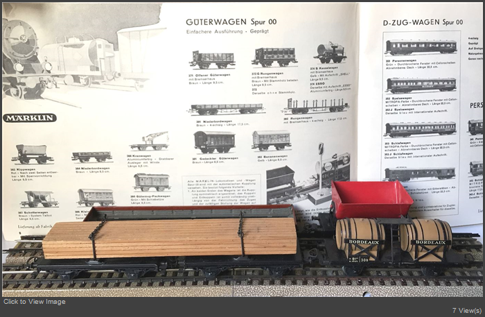

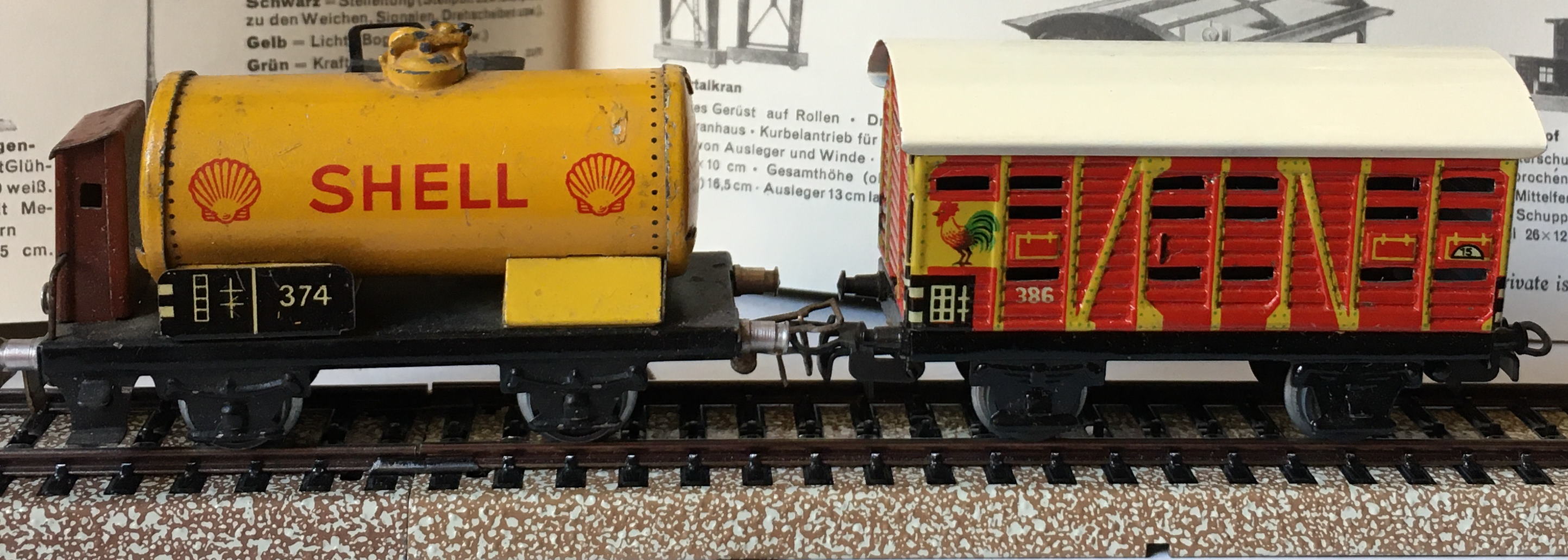

As to the roof of your car, here is my poultry car (Kleintierwagen 386) and its original roof

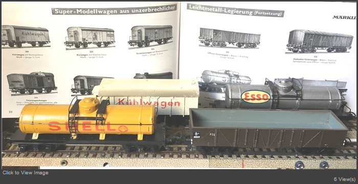

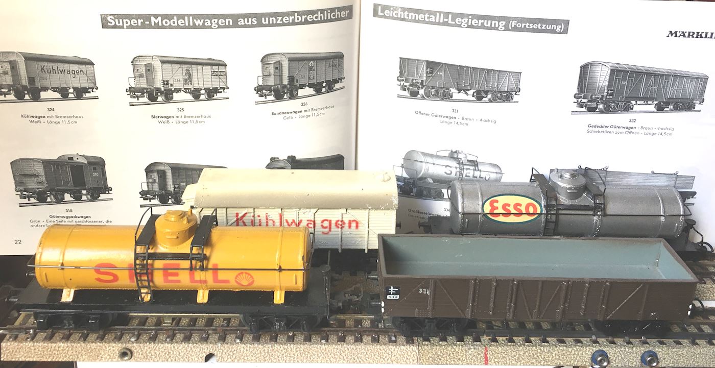

Here are supercar (Supermodelwagen)

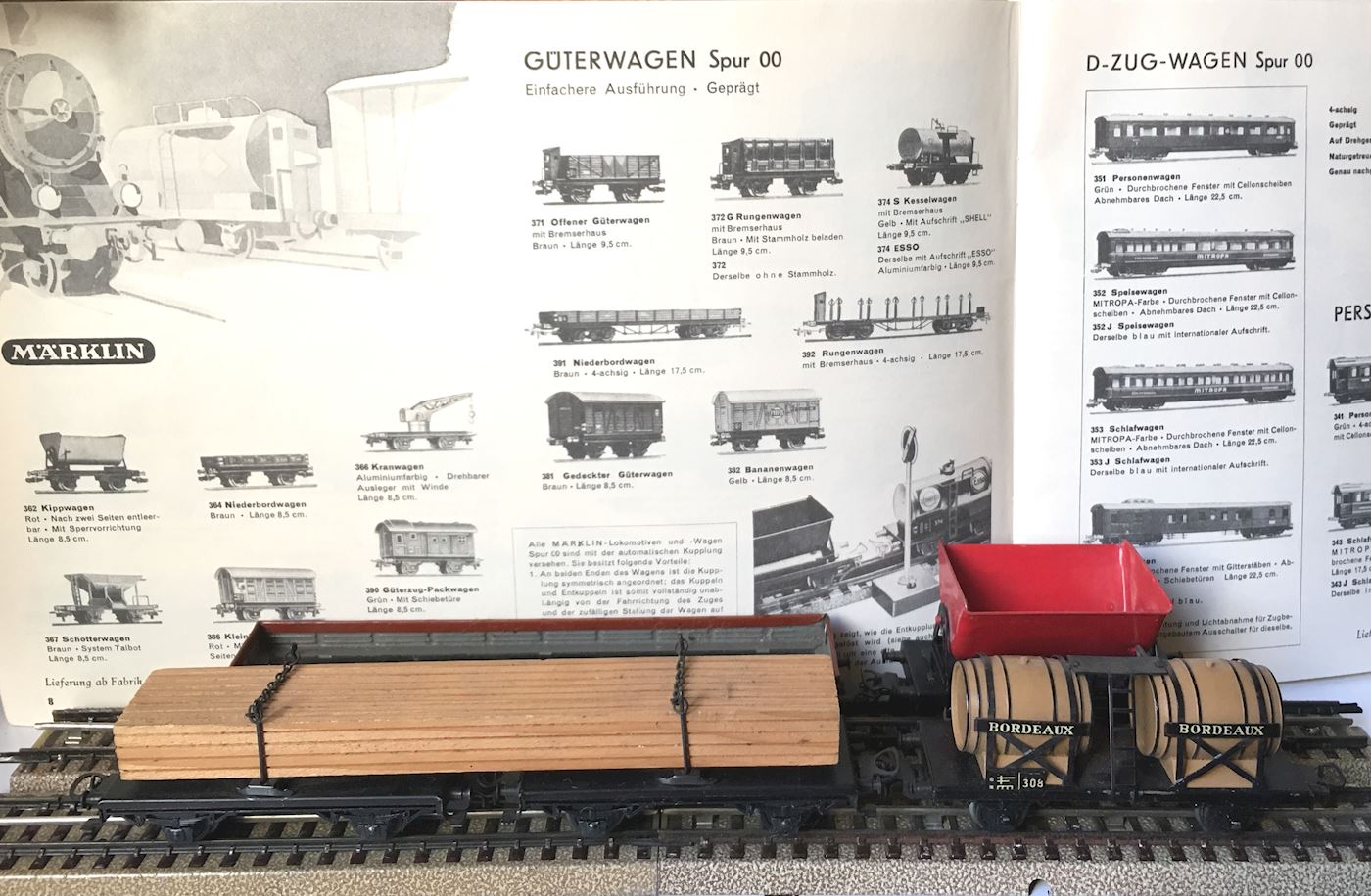

And here a wood transport car (Molded Zamak) and 391 (flat car) 362 (Side tipping car), 308/1 (Wine car)
Your T800 is great
