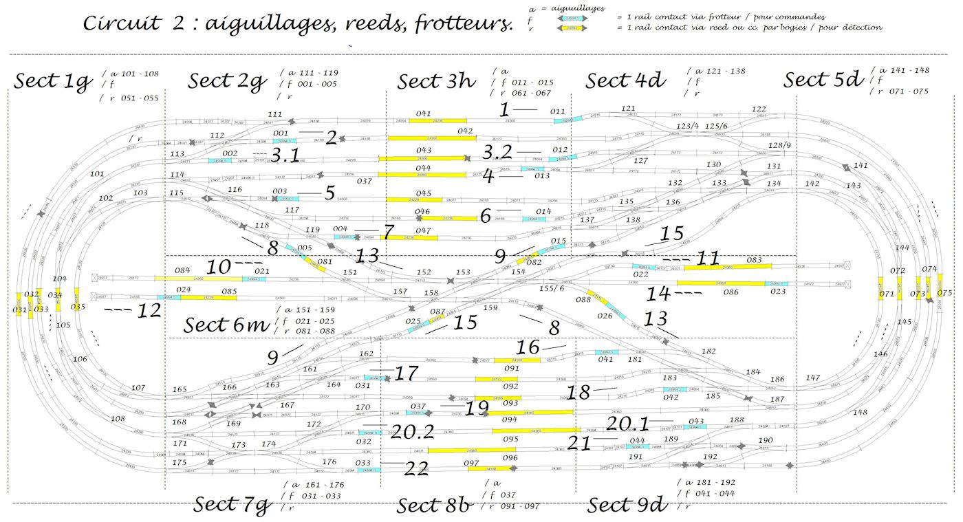

I have received a question from a fellow Railway modeller just getting back into the hobby, I am not sure on the answer to his question as I do not use itinerary's myself.
Can you provide confirmation that I can create an itinerary on the CS3 and tell me how to do it as the Marklin manual is not very explicit on this matter.
Tell me if the layout is put on the CS3 can I establish an itinerary, for example, from track 1 to 2 and then from 1 to 3 ? I imagine that on the screen you can insert the adequate buttons * start and goal *
Tim

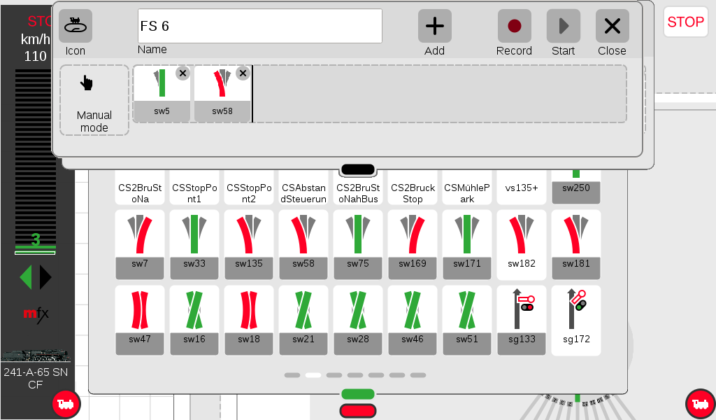

In order to create an itinerary you need to select "Events" and "Edit Events"create one (give it a name) and then, from the device list, select and slide the switch(es) you want to include and select if you want it straight (green) or in deviation (red)
So the best is to start with a printed layout where all track pieces names are shown
So it takes some time to create and verify all itineraries.
