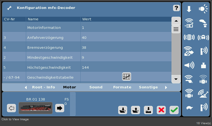

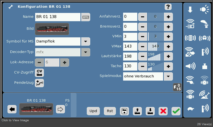

#19 Posted : 21 June 2020 11:22:32(UTC)
Posts: 3,696
@Gary: yes loads of fun. Thanks but the layout is now replaced with this one: https://www.youtube.com/watch?v=F6WnhXPcRqI
@kfish2: Those parameters are very easy to adjust with a CS2 or CS3 (on first loco parameter screen on a CS2, last update)
Looking further in the CVs we have this
Where you can see that:
CV3: acceleration delay
CV4: braking delay
CV5: max speed.
These CVs can be modified using many devices. What is yours?
I hope this helps

I am frustrated with the lack of details in the manual. It states the decoder works with (in preferred order) MFX, DCC, FX protocols. It lists CV settings for FX, and for DCC, but does not mention anything about MFX CVs. I dont know enough about MFX to know if this is a stupid question, but are the CV registers the same? I can live without the speed regulation because the 6080 never had it, but I wanted to be able to reduce the top speed. The manual says this CV5, but no matter how low I set that value, the loco still runs just as fast. It is fast enough to derail on R1 curves. The manual says the default for CV5 is 59 (out of a range of 0-63). I can set it to 5 and it does not seem to change anything. One of the MFX functions is what I call the "switcher" setting (Rabbit Icon on my ECOS) which drops the top speed. It is still too fast, but at least it does not derail on tight curves.
Has anyone had success with limiting the maximum speed with the 60906?
I have changed the 60906 max speed, with my cs3 using mfx and had no issues.
what you can try, is to disable 2 of 3 protocols on the Ecos, and do the programming. E.g. test out, disabling mfx and DCC on the ecos and then program the decoder in MM mode. or disable MM and mfx and program in DCC etc.
the Switching Range, is by default set to 50% speed reduction, but you can change it with cv 137.
Please note that I have never used an Ecos, so others here might have some better suggestions.

Thanks for the responses. My ESU ECOS does not have such a nice display for MFX CVs. It does allow me to set the CV values for MFX and FX decoders, but they cannot be read, so its hard to be 100% sure the change was accepted by the decoder. Maybe I will look for someone in my area who has a CS2 or CS3, so I can put my loco on their programming track and see how it looks.
Thanks too, for the suggestion about CV 137. Perhaps I can set that to 40% or 35% and get all the results I need.
I will also see about forcing one of the other protocols like DCC and see how it then performs. I know the decoder supports DCC, so I should be able to read those values, but I am not sure if DCC CV5, FX CV5, and MFX CV5 are one single storage register, or whether there are in-fact 3 values for each CV stored in the decoder at any given time.
Thanks again for responding
Ken
