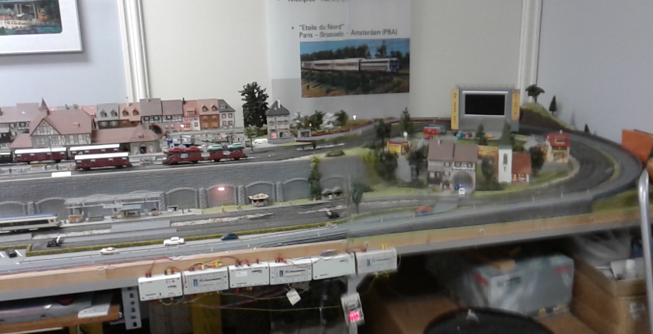

These are two pictures of Mike's layout.
Left side of Mike's layout.

Welcome back Silvano! I believe Mike's store layout is based upon or actually is a combination of the Noch Heidelberg modules. More information on and including dimensions of those modules can be found via this link: Noch Heidelberg Modules
Hope this helps,
Harold.

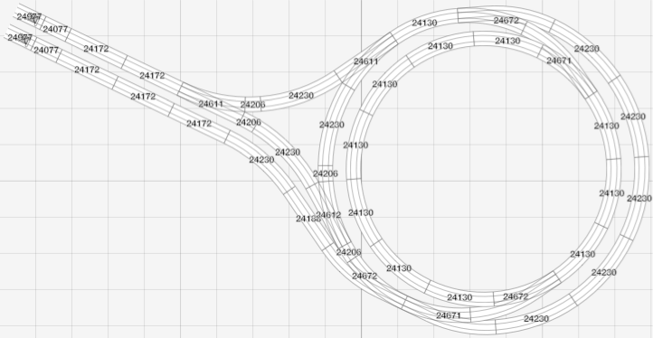

A reverse loop could be made portable so that it could be removed when not running trains in order to save space, ....
The principle illustrated:

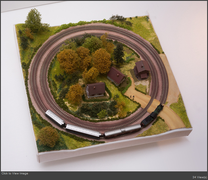

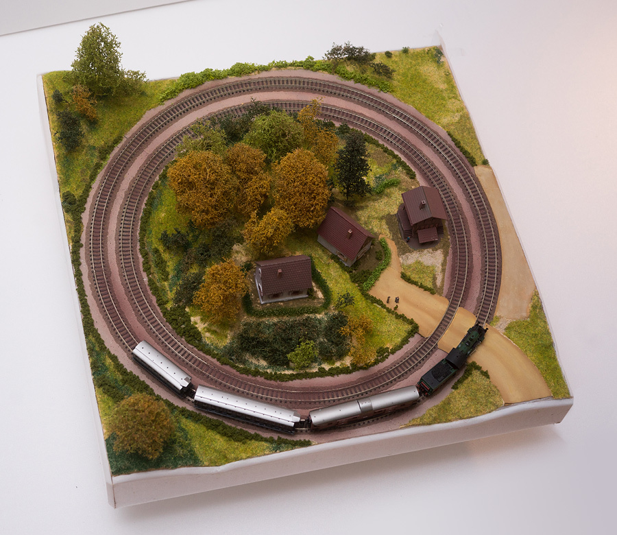

This is taken out of your link, Al (thanks), and looks very nice. Google translator did the rest:
"Yes, that would be crazy, but I also have some H0 rolling stock in my showcase, including a P 3/5 H (the old one from Trix) with a Bavarian express train car. So I could implement the concept of my very first N layout, which can be seen here in the photo, in H0. The dimensions would then be about 90x90 cm. There would then be space for two Era 1 trains.
Advantage: I would have something in a different size, and I think that H0 opens up another world in the design (gravel tracks, meadows, trees, etc.) compared to N, the vehicles just look completely different due to their size. Disadvantage: I find 90x90 cm very bulky. You can no longer put it in a larger shelf because of the depth and the transport is annoying (the system only fits upright through the door, and probably only in a station wagon, which I don't have. I'm just not used to that )."
Certainly gives me something to think about. BigGrin

Would it be possible with a narrower layout that could be up against a wall combined with reverse loops at one or both ends? A reverse loop could be made portable so that it could be removed when not running trains in order to save space, a reverse loop could also be at an angle to the main part. That way you could have the central part of the layout with longer stretches of track and a yard and a station.
I like reverse loops a lot, but by their nature prevent you from running two trains one behind the other since one train could be coming back while the next is still not completely inside the loop. Something to consider, however.
Thanks for the suggestion. BigGrin

Mike confirmed that his layout was made by using the Heidelberg modules, adapted to his needs.
However, these modules are bulky and with the Pandemic he is not importing any at this time.

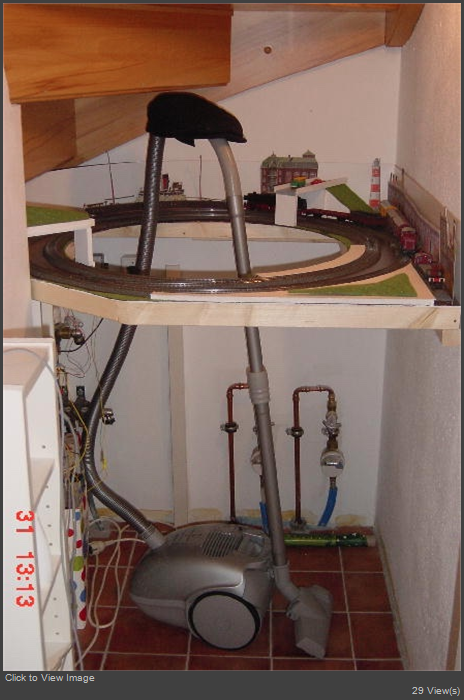

VERY interesting, Al. Do you have any pictures of the finished products, with trains running?
Indeed I do:
1) "Foursquares Circles"
The vacuum cleaner wearing a hat is a placeholder for a human operator on a swivel chair.
Operator´s view.

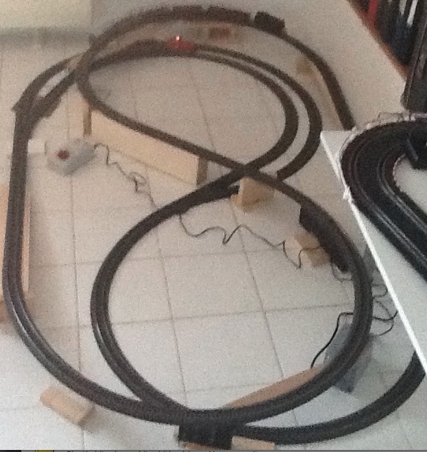

One set up I am considering is the one below.
I realize that this set up is usually used for race cars... but I do like it.
Does anyone know how to do it with Marklin, keeping in mind the layout involves raising the track, something I am not good at.
Thanks.
Silvano

Something like this?
9 years ago I tried out what one can do with a starter set ("Papa spiel mit mir") and some spare rails within a limited space of 39" x 67": a two level design with 8 m of main line which is crossing itself three times.
P.S.: Speaking of racing cars: There is part of a slot car course visible, too.

I Love it, Al! ThumpUp
Was it difficult for the trains to climb the slopes?
(Maybe I should buy myself a race track, too, as a Christmas present... BigGrin )
#34 Posted : 20 November 2020 16:44:12(UTC)
Posts: 6,072
No, not at all. The rear ramp (right) left an elegant impression in terms of aeshetics, but the one in the front (left) looked frivolously steep. Still, no problem for the short trains to climb.
Does anyone know how to do it with Marklin...]
For example on a 38" x 74" surface:
Elevations expressed in cm:
The 24094 gaps do not matter in reality.
P.S.: For easing the task of climbing, trains should use the R2 curves for uphill trips. Thus, this draft is geared towards left-hand traffic operators (like in Italy). For others, the over- and underpass combination should be flipped to allow for a R2 uphill running under a right-hand regime.

Al, which of the two layouts is more complicated to put together, the "slot car" clone or the other one?
I am thinking that the latter is easier and may be more susceptible to making adaptations for space or otherwise.
What say you? Smile
#38 Posted : 20 November 2020 20:04:21(UTC)
Posts: 6,072
The double-track figure-8 requires only one single overpass, and the ramps are of equal length, which means “equal opportunity” for both lines. Bonus: Two trains can race at the same time. If you had LEGO interlocking plastic bricks, you could use them as mock-ups for testing the ramp conditions.
BTW: I’m using 5 cm styrofoam sheets for creating curved inclines, as documented here (see post #52):
https://www.marklin-user...1602-Badland-and-Hi-Land
