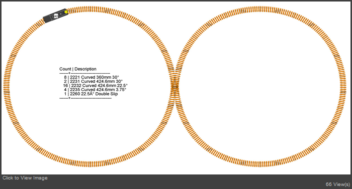

thanks 2 users liked this useful post by Berryman

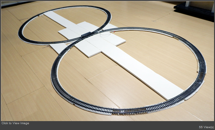

This is my test-track to test run or to program a locomotive.
Double slip 2260 can be substituted by 2 pcs of 2206 (one on a bridge above the other).
thanks 2 users liked this useful post by tiono

#7 Posted : 13 May 2019 04:31:55(UTC)
clapcott
Joined: 12/12/2005(UTC)
Posts: 2,461
Originally Posted by: Berryman Go to Quoted Post
I tried to draw a very simple and basic figure 8 track plan...but it doesn't work
While your posted diagram shows a 24649 you do not state this as a requirement.
Using a 24640(24624) may be an alternative
If you wish to persue the use of the 24649 then you may vary the earlier suggested solution by moving the 24206 segments slightly to allow changing the 24071 to 24077s
If you are after
- only the most common track segments (best bang for your buck)
- wish to remove the tight "S"
- show off "progressive" curving (Straight into R2 into R1 out to R2 out to straight)
- have a nice visual run for a long train
- offer tidier geometry for variation (because of its 2 axis symmetry)
- - can replace the 4 x 24230s with 4 x 24330s (#1)
- - can replace 4 x 24130s with 4 x 24230s (thus giving "progressive" curving ( R3 into R2 into R1 out to R2 out to R3)) (#1)
- - can replace the 4 x 24224s with 8 x 24912s
- The 24224s may be replaced with turnouts 24671/2 to join the upper and/or lower humps (need 8x 24172 + 1 x24075)
#1 adding 4 x 24330s and relocating the 4 x 24230 will mean adding a 24077 in each of the straight legs
#2 altering the 4 x 24224s to 8 x 24912s will mean reconfiguring each 4 x 24188s section to 3 x 24172 + 1 x 24094
Edited by user 13 May 2019 23:42:06(UTC)  | Reason: Not specified

I design this figure-8 plan using SCARM software but I have not tried it with actual C-track.
SORRY if picture doesn't show!
Edited by user 01 January 2020 01:24:11(UTC)  | Reason: picture didn't appear
M-track - Era III-IV with 6021, Billerbahn.
thanks 1 user liked this useful post by tank_brd

This looks good; would be even better if the circles were on top of each other at the centre.
