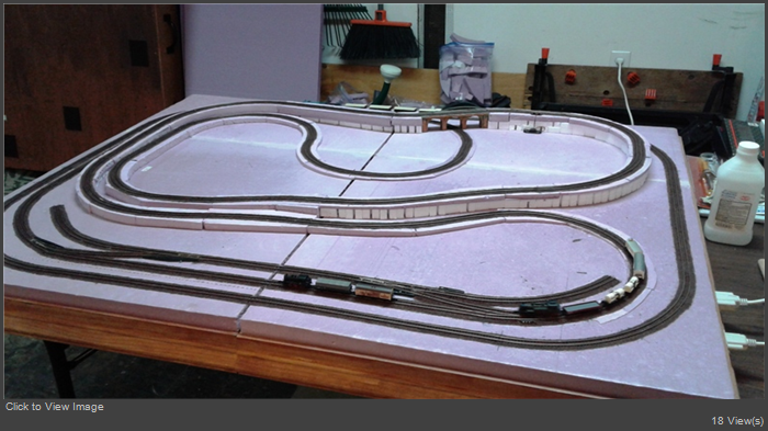

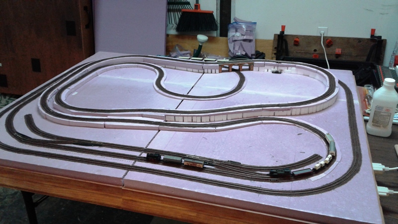

With some patience and perseverance it can be done (this is only my second layout, first one in Z scale):
The track ends very nearly touch each other (no physical connection), so they must meet precisely in the horizontal and vertical planes to prevent derailing. Numerous male/female electrical plugs located between both halves provide precise alignment and electrical connections. Because they aren't physically connected, each side's track sections have power routed where needed. I decided to go this route to avoid having to connect tiny and fiddly fishplates.
A short video of a consist running the outer track:
Kleinhopfensee Z Scale Outer Track Running Email_083118.wmv (3,072kb) downloaded 21 time(s).

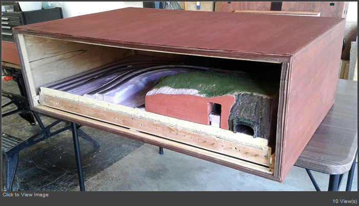

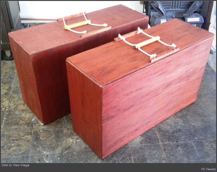

Custom storage boxes:
Kleinhopfensee Box Inside.jpgKleinhopfensee Carrying and Storage Boxes_102019.jpg
