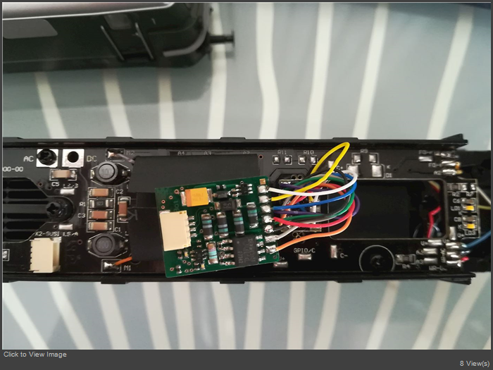

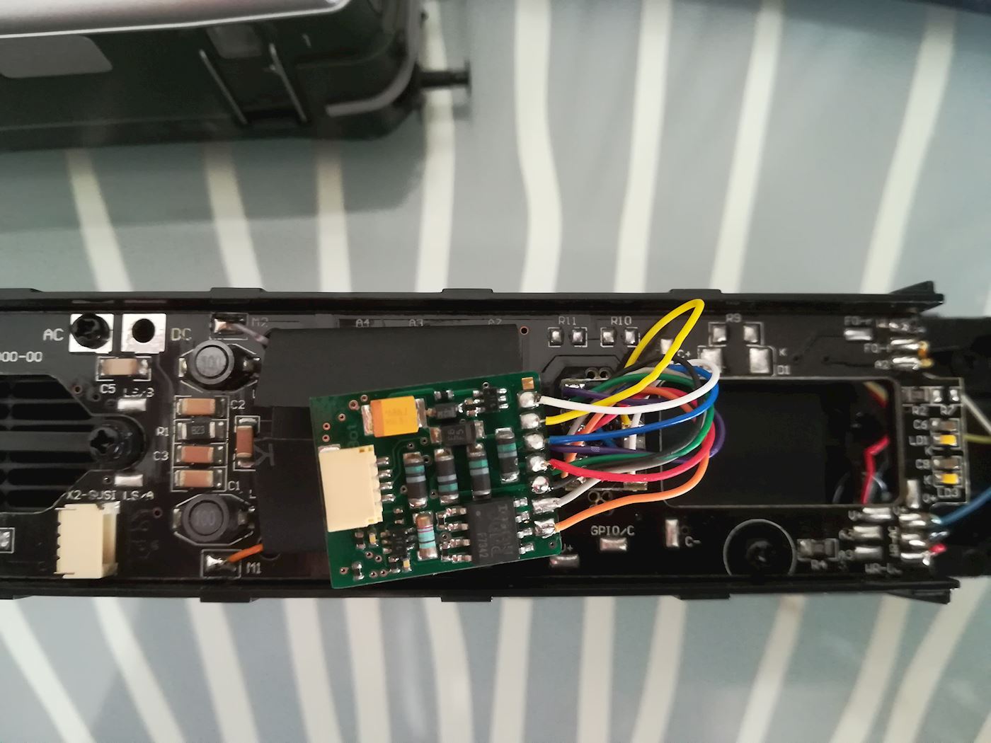

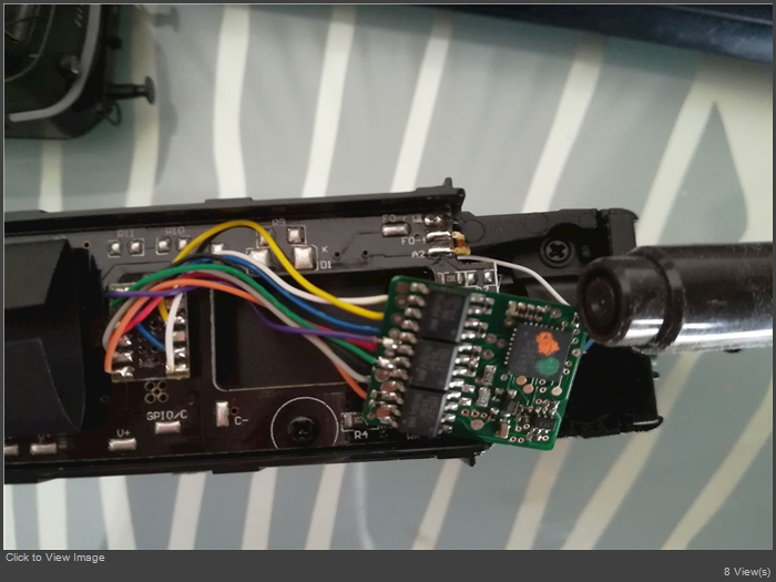

I´m still trying to wrestle out a better analogue performance of my PIKO E41.
I thought it was a PLUX22 or PLUX16 deco, but it identifies itself as 85 (Uhlenbrock), with Software revision 5. (CVs 8 and 7).
Can anybody more-or-less identify the deco from these photos;
(Sorry, I cant really identify any text on the boards or the chips Blink )

Excellent. Under which heading do we find information about the Uhlenbrock decoder shown in post #14?
#20 Posted : 05 August 2020 21:36:10(UTC)
Posts: 3,541
Yes, and all the pre-DCC MFX-decoders that now seems to have CVs that can be programmed with code-switches.............. LOL
