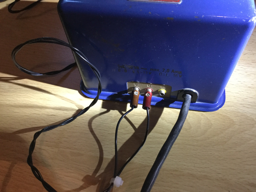

#16 Posted : 31 March 2020 18:17:09(UTC)
Janne75
Joined: 23/03/2012(UTC)
Posts: 2,556
Location: Finland
I had before a lot of Märklin 3600 tracks and all of these which had any connector plugs had those bigger connectors. 3600 tracks were made 1947-1956. First versions from 1947-1952 and second versions from 1952-1956.
I’m just reading my old Koll’s catalogue from 2012 and it has an interesting note in transformer 280 A version 2 (1955-1961). This 280 A second version (6113 with normal plugs) and (6173 with schuko plugs).
I use those bigger connectors with my transformer but it has ”6123” in it’s nameplate. Not 6113 but I think 6123 relates to that 6113 more than 6173. 6123 has also three connecting points like 6113 has.
