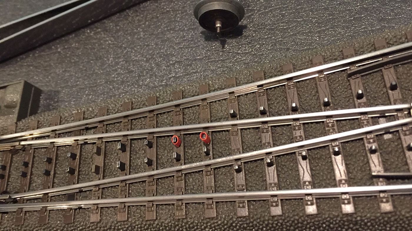

Has anyone experienced any issues with these two locomotives in the 30470 set when they run over the C-track wide-angled turnouts 24711 or 24712?
They seem to cause short-circuit as they run over them.

Hi Armando.
It could happen because of the short twin pick up shoe. I have had this trouble!
Check where the short happens.
I also had trouble with flanges touching pukos.
Check wheels' spacing, inner dimension should be 13.8mm.
Usually if you can find the "offending" puko, a very short piece of shrink tubing around it will take care of it, leaving only the tip exposed.
Good hunting. 😂

Jacques,
Thank you for directing my attention to the possibility of the wheel flanges making contact with the pukos on the C-track wide-angled turnouts!
It was exactly that! There are at least two "culprit" pukos. Once wrapped with the shrink tubing, the problems was solved.
I'm attaching a photo opukos.jpegf the problematic pukos.
Armando García
