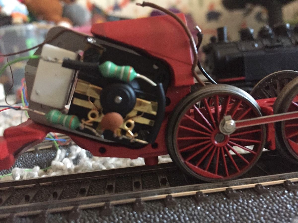

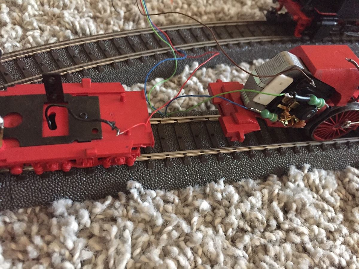

Good afternoon.
I bought a model BR 03 (3097). Bought to him set of 60941 and decoder 60985. Did like the instructions: (https://static.maerklin.de/damcontent/f4/4b/f44bc06cd060d8bfa9bc768605e6b79e1515411323.pdf) Soldered the red wire to the Central ski, blue and green wire to the motor through the resistance. Brown wire to ground. When you turn on the power, you hear a sound like a short circuit. Maybe there's a problem with the decoder? Confused by the brown wire. In the decoder 2. Maybe I misinterpreted the instructions. :(
If there is who will help - thank you!

For the 6098x decoders you should be looking at the NEM colour coding as shown in the schematic at the right of pg28. The table does have a column showing the marklin norm for reference?/confusion but it is the NEM column that should be used
i.e. Brown is NOT power return, and the Motor wires are NOT Green and Blue
#6 Posted : 29 April 2019 22:18:52(UTC)
Posts: 3,727
Hi Denis
Clapcott is correct. Colours are on page 28 of manual https://static.maerklin....8605e6b79e1515411323.pdf
- black = chassis
- red= slider
- grey = Motor connection 2
- orange = Motor connection 1

motor\
Gray
Orange
Pick-Up
Red
Ground
Black
You will be lucky if you have not fry the decorder...

Originally Posted by: ktsolias Go to Quoted Post
motor\
Gray
Orange
Pick-Up
Red
Ground
Black
Costas
Hi Costas!
I'm not lucky :) of Course he fried ))) Ordered a new ) I misunderstood the table with the colors of the wires. Well, I'll be more cleverly next time )

Denis,
See you put permenant magnet there, so your small brown round resister is not needed. Remove and leave the two green resistors in place.
This should help, since you already followed the instructions.
Think this is your problem.
#15 Posted : 03 May 2019 09:22:49(UTC)
Posts: 15,576
This is a capacitor. It comes with the new motor shield and it is the one that should stay in place.
The green "resistors" are inductors or chokes.
Messing up the cable colours is the real problem. The capacitors and chokes shown are all fine. The blank wires at the chokes are a potential problem when the loco body is put back.

Originally Posted by: Denis Go to Quoted Post
Good afternoon.
1_Malen'kijj.mp4 (16,626kb) downloaded 28 time(s).
Hi, everybody.
Came a new decoder 60985. Connected according to the scheme:
- black = chassis
- red= slider
It's working! BigGrin
Thank you all very much for your help!
