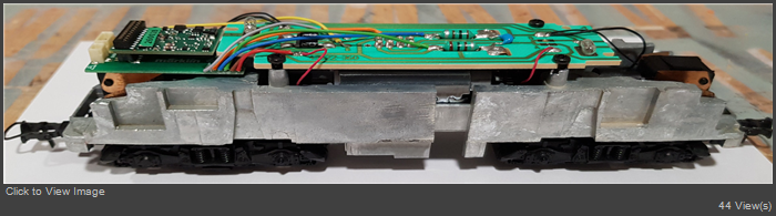

Here is my attempt at a cheap motive power for the above cleaning wagon.
I found a very well kept, very cheap Roco DC loco and adapted it to 3 rails, adding a mLD/3 (more than doubling the original price but hey, it's still cheap, ~80CHF in total, shipping costs included).
It has current pick-ups on all wheels and two new shoes. All 4 axles powered. Runs very quietly and so far is unstoppable :)
.costin
