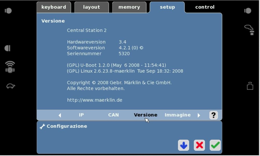

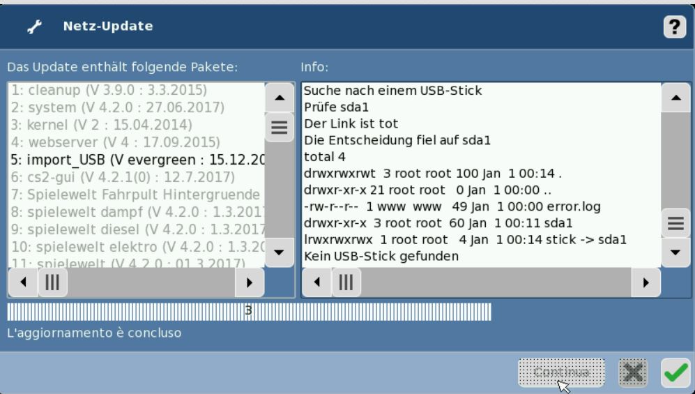

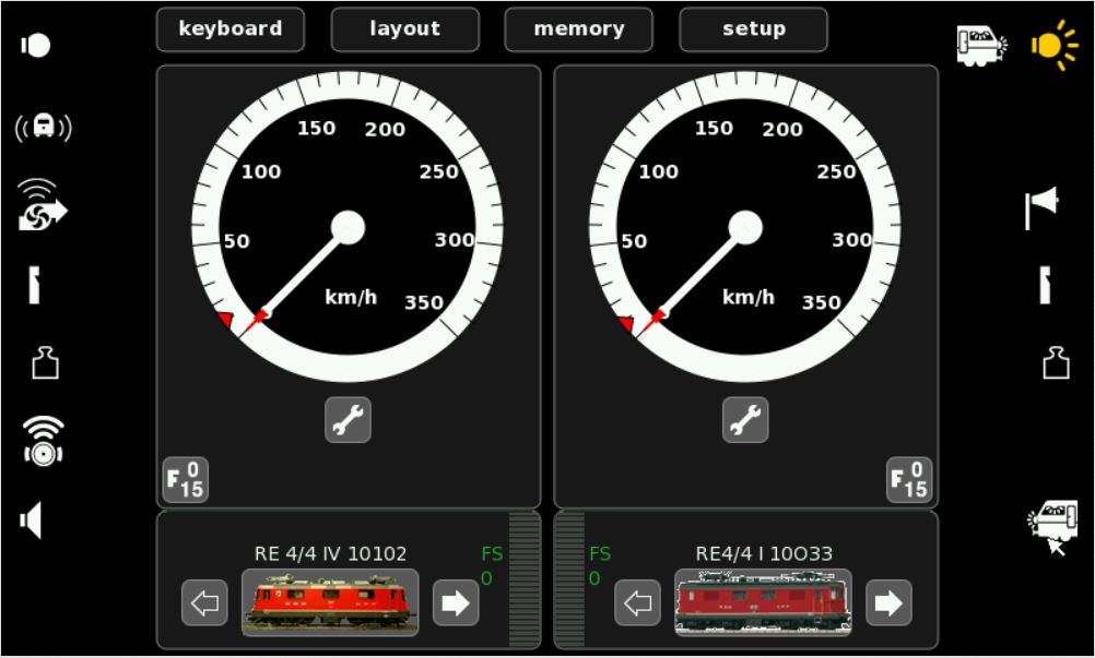

updated my CS2 now.
All seems ok, but when the system restart I receive this message:
1
and I cannot drive loco or decoder, all the buttons are dead, I can only navigate the menu and the various screen.
When I try to repeat the upgrade the system says: "already done"
2
This the two main screen that I have
3
4
Crying Crying Crying

Hi Alberto,
If possible I would try an USB update with an older version
Good luck

Already done, via usb, and after that another update via internet, but the bug remains.
An answer from a Betatester will be welcome, I know that they read the forum...
Is it a my problem only?

Received the response from the Märklin service, unfortunately an internal CS2 hardware error occourred during the update, the only solution is to send the CS2 to Märklin for repair.

Updated this evening my second CS2, 60215, all has gone right Cool
Tested the functions and the other options, all OK.
The connection with the CS2 software on computer OK too.
Here the screenshot
1
2
3
software
4
probably only unlucky trasfer data via internet with my 60213
Alberto
Marklinfan Club Italia
www.marklinfan.net

Here are my comments in red in your text
I invite some discussion, but offer some feedback to Marklin on the application of their 32 function support on the CS2
A) Thanks for providing support for 32 functions
B) As it relates to related configuration screen changes for
i) Basic function editing - the inability to change between F0-15/F16-31 once within the screen is an obvious oversight
[JJB] Yes very much so
ii) Advanced Function mapping - the inability to "test" is not appreciated
[JJB] and the inability to select the Icon, select the type of function, access all 32 functions, the type of function (dimmer, mars, telex,..) all being in the same area. Fine tuning a function is very painful forcing to load many time the CVs and then leave to access function icons, type of function and test.
C)
The presences of the "F0-15" icons for locomotives that do not have the support for any more than 16 functions is destracting and misleading - please filter
D) The disconnect between the actual buttons and the adjacent touchscreen icons (first row, currently representing F17-F24) is misleading, non-intuitive and dangerous
- There are two immediate issues
i) the fact that a button may be pressed with no knowledge of what it relates to or what the resultant status (feedback)
ii) being close to the rim of the display casing, the alternate option of using the touch screen becomes fiddly and bluntly not appreciated.
- I would offer a suggestion
i) that the first row of 8 buttons be sticky and that they always be there as the 8 most common options
ii) the (shift) button for F0-15 (currently) be expanded to (up to 3) F9-15 , F16-24, F25-31 with indication of which is active (toggling through 3 option is not ergonomically desirable)
ii) the shift button(s) only be present if the function was defined and available on the Locomotive
[JJB] In general, this release présents some Strange behaviour especially at first start: reboot, part reboot with stop bar blinking while CS2 is operational, some interruptions / reboot during editions in "Memory". Strangely enough, the number of odd behaviour reduces later and normal operation during hours is possible without problems. Working with Rocrail does not show problems and loco decoder programming works fine.

CS2 Updates
(to see the list you need to agree with the software license by clicking on the bullet button on the last line)
The first cs2update.img on the list have 135MB (141.557.760 bytes)
The second cs2update.img in the middle of the list have 130MB (136.314.880 bytes)
Walter
